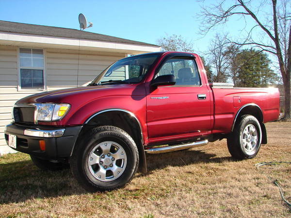

    If Im not wrong I think 01-04 tacomas had to have 16'' rims to clear the calipers. But I have some 16'' off a 09 tacoma on mine. Here are some pics.

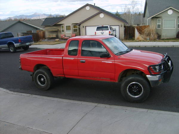

    Black Ultra Type 175 Rogue wheels, 33x12.50's, exhaust, sony deck,JL tweeters, hella 500ff's, painted rear bumper, brush guard, tail lights, kc's, custom tube bumper,5100's w/trd springs, toytec aal, custom tire carrier
    These are 15x8 but not sure on the backspacing. I have 31x10.5 toyos
