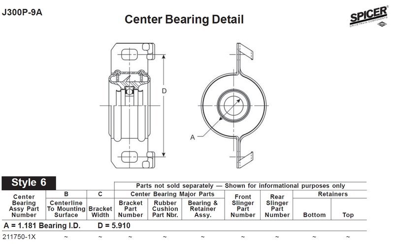

    Looking at Spicer Drivetrain Components Catalog (attached) I found the dimensions of 5002007
    Bearing I.D.: 1.181
    Center to Center of Mounting Holes: 5.906
    Centerline to mounting surface: .244
    Bracket Width: 2.244
    Thought I saw the dimensions of 5002334 but can't seem to find it in the catalog, which is from 2008 or Spicer's website. It might be listed as a Dana part #, but not sure which. The only one I found that was close was 211750-1X.
    Bearing I.D.: 1.181
    Center to Center of Mounting Holes: 5.910
    Even the pictures on drivetrainamerica's website of 5002334 and 211750-1X look the same except the holes on the bottom.
