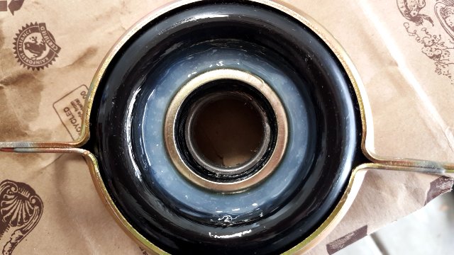

    Hi Everybody, I have 2004 Taco 4x4 with all IRD suspension. It sits a few inches higher than the average SR5 4x4 Taco of that generation. I have been having a HELL of a time with carrier bearings. I had been eating up carrier bearings, and most recently, at the end of 2017 I got all the angles of the drive-line happy and got a brand new carrier bearing installed at the same time. (I think it was a Moog). Here we are in the beginning of 2019 and the rubber of the bearing is completely smoked. My driveshaft was just wobbling around in the outer metal ring of the bearing. So now that I have been through almost a new bearing per year for a few years now, I created the final solution and I would like to share that with you here. I hope you enjoy my write-up. Maybe it will help you. If you are as fed up as I am, and at wit's end, I could probably even make you one of these if you buy the parts.
    First, there is a difference between the 4WD version and the RWD version. Its basically just an extra metal ring that acts as a dust cover / shield. Either bearing will mechanically work in either truck (RWD vs 4RD). Second, there is a large range in the quality of parts available. There are $25 Doorman bearings, $275 Tacoma OEM bearings, and everything in the middle. Yes, the OEM are actually Spicer / Dana and you can get them for $100 probably somewhere. There is a difference in rubber thickness and quality of the material. I find it almost impossible to distinguish a $25 bearing from a $100 bearing by looking at a photo. So if you are trying to save money, I would stay away from Amazon sellers due to counterfeits. You get what you pay for.
    I started by buying a brand new carrier bearing from Rock Auto. They offer a range of $11 - $72 bearings (at the time of this writing). I chose the "National" brand. It is usually $65 at Rock Auto, but they are having a wholesaler closeout, so it was $31. This one made by National sells for $75 at Autozone, and I have seen them sell for more. The point here is that I started with a higher-end bearing, and I did get the 4WD model. So start with the best.

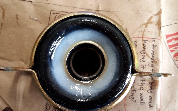

    STEP#1:
    Now if you look at the part (OEM showed below):
    You see how the rubber curves from the outer metal housing, down into the center where the bearing is located. It creates a little "valley" in the rubber around the outside of the bearing. The most stress on the rubber is right at the edge that is bonded to the bearing. That is where the rubber will fail first, and once that breaks free the whole thing will hand grenade soon. So the first thing I do is "preinforce" this area on the new one.
    Loctite makes a family of products called Hysol. Hysol is a structural polyurethane. The key word here is "structural." There are different varieties of Hysol, but we want the one that bonds to metal and rubber, U-05FL.
    The amazon link below shows a picture of the *wrong* stuff, but it is actually the link to buy the right stuff. Good luck. I got mine at Granger.
    https://www.amazon.com/LOCTITE-Adhesive-Urethane-Hysol-U-05FL/dp/B00E2Y26XY
    This stuff is similar to a binary epoxy. Squirt from both tubes simultaneously and mix it up on a cardboard palette. Its a 2:1 ratio, but the tube diameters do that for you if you just push them in the same amount. Now I filled that "valley" in the rubber that circles the bearing.
    The stuff only has a few minutes of working life before it sets up, so do it little by little. Do both sides. Only one side is shown here, but they look the same. I ended up using the entire 1.7 fl.oz. tube. After the "valleys" on each side were filled, I used the rest to basically make a solid surface of structural poly that went from the ridge of the rubber down to the edge of the bearing.
    After both sides looked like that I just let it dry for a day. Now, the structural polyurethane provides added strength. It should help keep the rubber from drying out and disintegrating. It also bonds to the rubber and metal on the outside of the bearing in the center, which should keep the rubber from "pulling away" from the bearing, which has happened to me in the past. This poly does actually flex to absorb vibration, so it does not transmit the vibration like a solid block of poly would.
    STEP#2:
    Step 1 might have been enough. But not for Captain Overkill! So the *outside* of the rubber has been reinforced... but the part is made with two sheets of rubber joining the outside of the center bearing with the inside of the outer metal ring. There is an air gap in between the two sheets of rubber. The air gap lets the rubber dry out and obviously provides no structural support. So the next thing I did was buy a tube of black polyurethane and fill the gap completely.
    Loctite black polyurethane for roofing will also bond to just about anything. The nozzle on the tube easily fit into the openings on the outer metal housing.
    I moved the nozzle around to various angles and filled the air gap with poly. I did this for both sides. It took a while to dry. I think it was 4 days before I had time to get back to this project. The poly I added to the inside took the flimsy rubber sheets and made it into a brick. The poly actually dried softer than the rubber. I don't know how much extra support it will provide, but I do know:
    1. It will be more than the air did.
    2. It seals the rubber from hot dry air that had to contribute to killing it.
    I had my shop install this to just to verify that angles were still good, shaft was still balanced, U-joints weren't smoked, etc. I have been driving it about a month. I am sure this bearing does transmit more vibration to the truck / my butt. It would about have to. But it hasn't been enough to bother me. I don't notice it. You know what vibrated more than this? Have the driveshaft wobble freely being held in place by nothing other than that outer ring of metal and no rubber. So I will see how long it lasts and report back.
    But that is my recipe for Taco Mayhem's Bomb-Proof Bearing. Hit me up with questions.

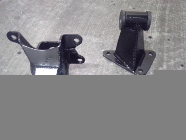

    I replaced the support bearing and u-joints with a very small improvement.
    It wasn’t until I installed solid engine and trans mounts that the oscillation went away. Pretty expensive and somewhat difficult install, but I was going that direction anyway.
    A friend suggested I check the slip yolk and I did notice a good deal of slop pulling it side to side. It’s probably the result of shortening my drive shaft for SUA long travel.
    Might be something to consider though.

    You shouldn't run both solid engine and transmission mounts- too much rigidity and can lead to a cracked transmission case. Google it, it's common when you have all 3 mounts solid. You should use a rubber or urethane transmission mount.
  18. Jul 30, 2019 at 1:51 PM

    I guess we’ll see... I shouldn’t have done most of what I did to my truck if I didn’t want things to break.
    Not sure if it matters, in regard to those cases, but my “solid” mounts have urethane bushing isolators.
    Edit: something like this. Mine are by DMZ.962E8473-09DD-4635-A14A-EF9A800C1165.jpg
