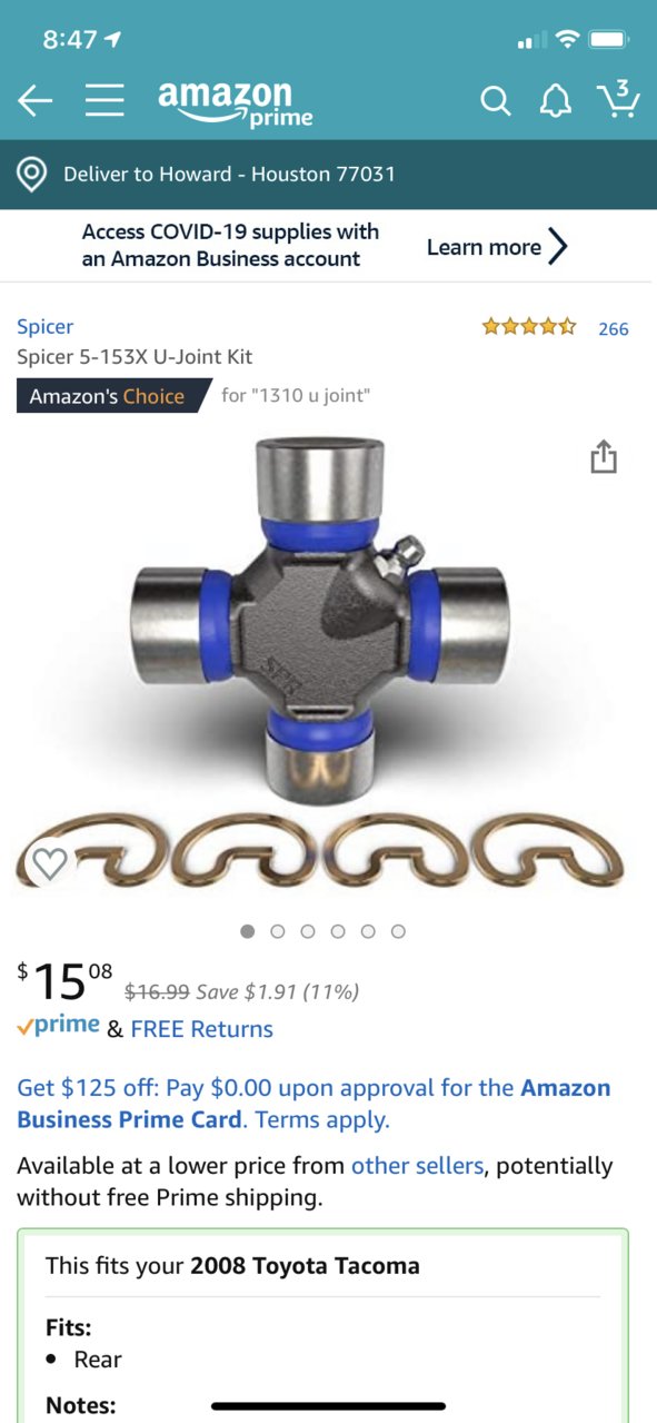

    So this correct for a 2008 u joint, right?

    Any help here guys ? I’m getting conflicting info on which joints I should use in a extended cab 2008 4wd with a 6 foot bed

    I used Spicer 5-1330-1X that I got from Rock Auto w/ the 5% discount in my 2011 4wd DCSB. Doesn't fully answer your question, but I would think those should work for your application.
    The ones in the image that you posted have the zerk on the crotch and not on the end. The ones with the zerk in the crotch may be for the front DS, but I'm not sure about that as you can get either style for these trucks. The OEM ones are in the crotch on the front DS and on the end of the rear DS.
