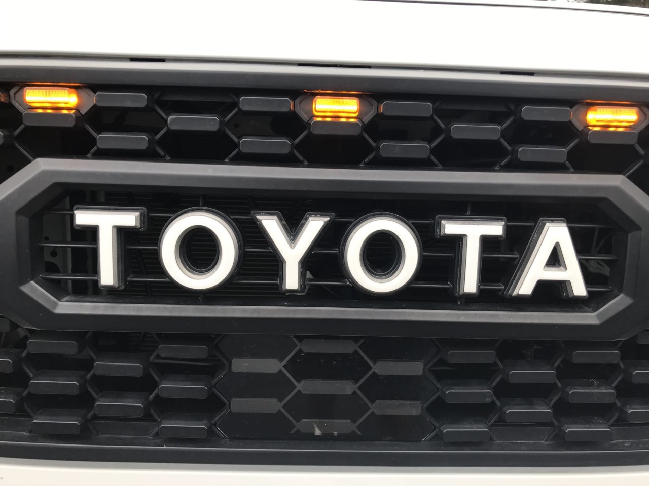

    mine was $100 and its horrible.
    doesnt fit, its matte black and not gloss black like the OEM grilles, its fading, the letters fall off, etc.

    Oh it sounded like you told @brandon78lusch oem could be had for just as cheap as aftermarket.

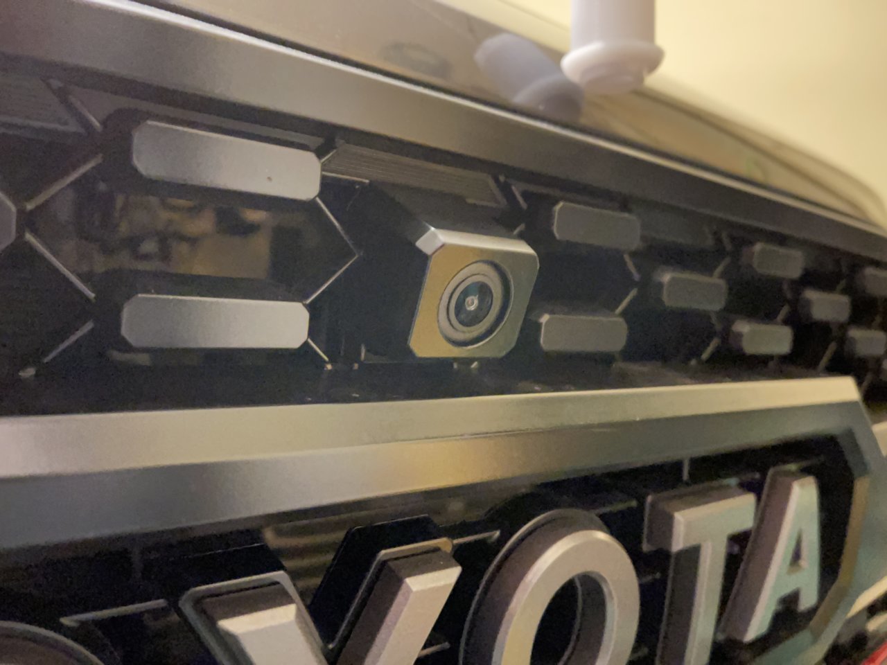

    Here is my setup using this grill and the anytime backup wiring. I modified one of the mounts DamGuide made for the camera to work.
    Sounds like he’s going to try to make a mount for this camera so I won’t get to much into it.
    I’ve been running this setup for 2 weeks now without any issues. The original issue was making sure it wouldn’t rotate while going over rough terrain. I solved that but I think it’s best to see if DamGuides new mount works before everyone goes out and purchases the camera.

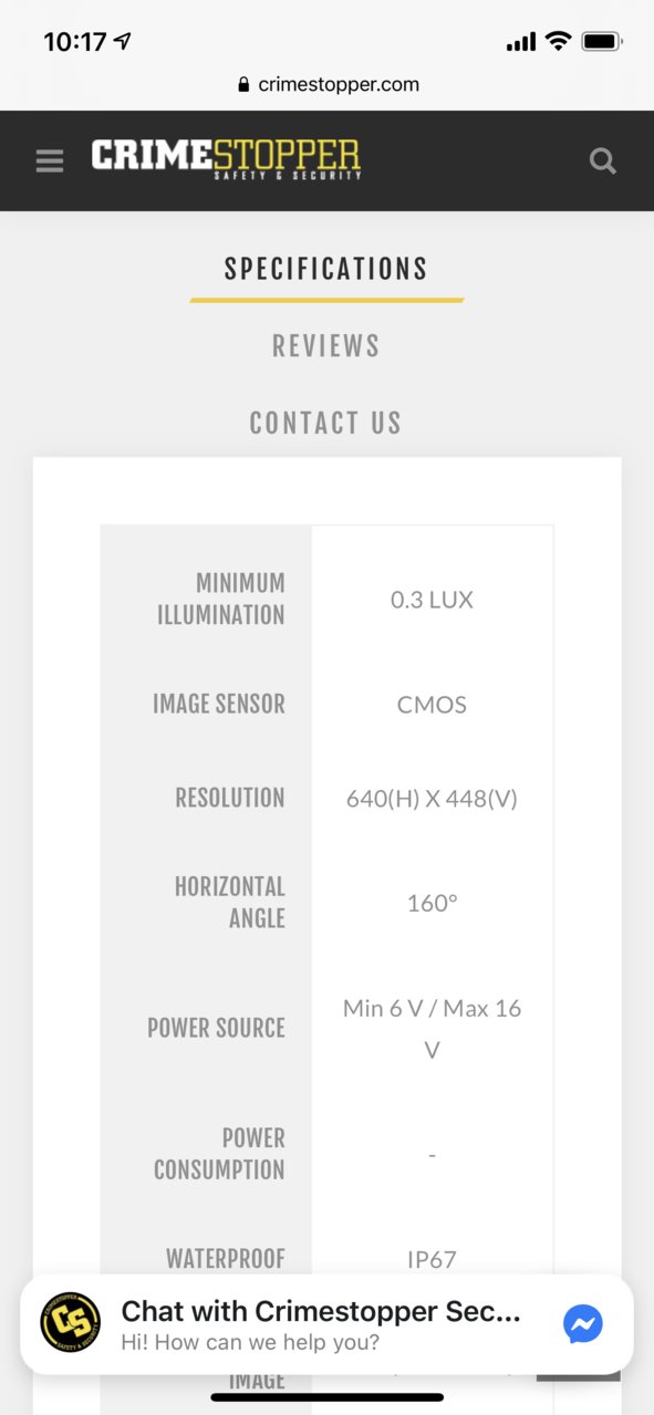

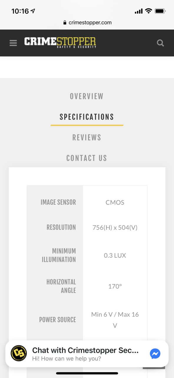

    I’m interested in image quality comparison.
    I went a different route for camera and got the crime stopper 300 because of the multiple mount options and I’m using an sr/5 grill. Just noticed they have a new cam 400 supposed hd just not sure if the quality would be noticeable just comparing the specs from them (or how they compare to the cameras you’ve bought?)

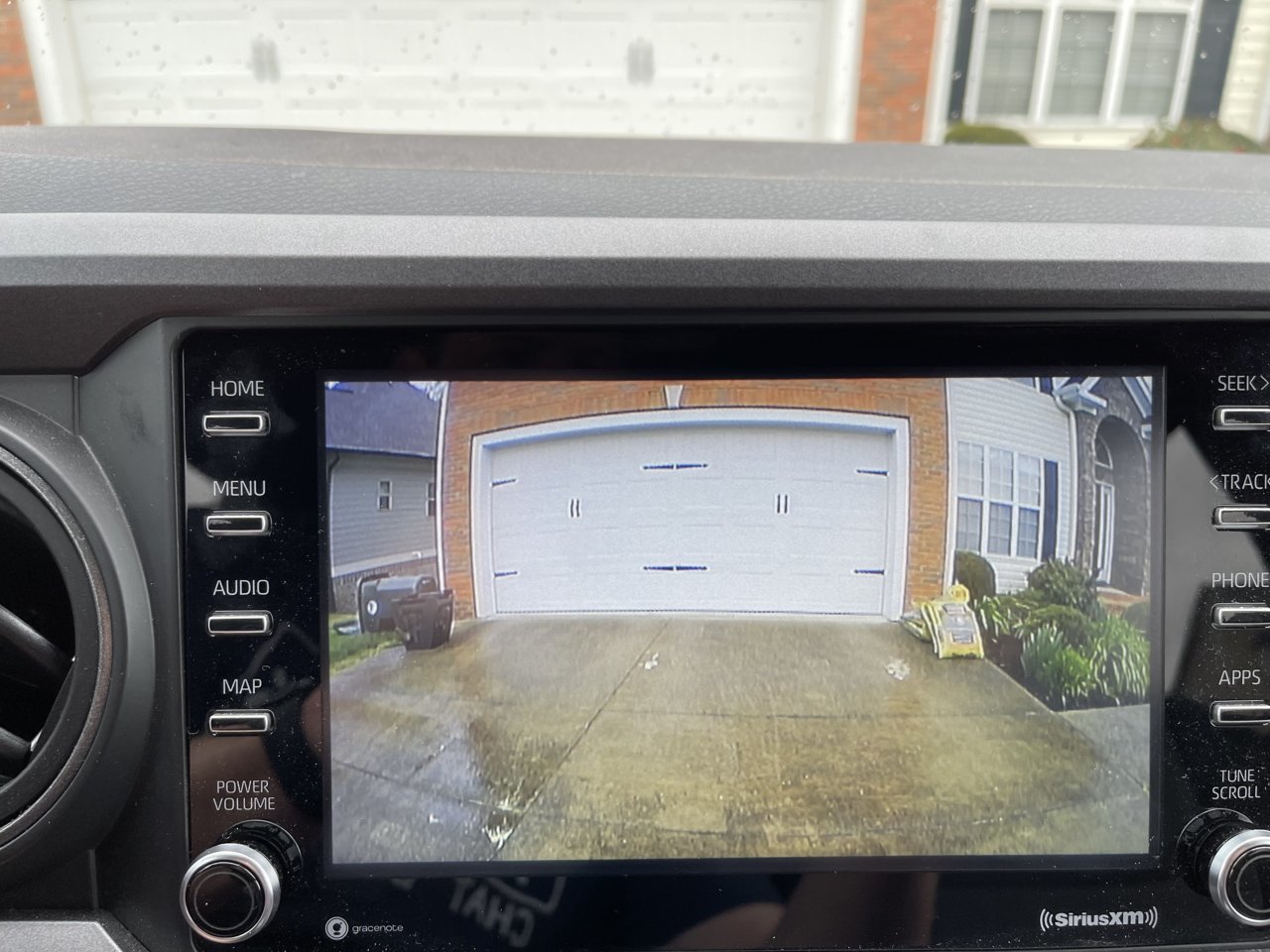

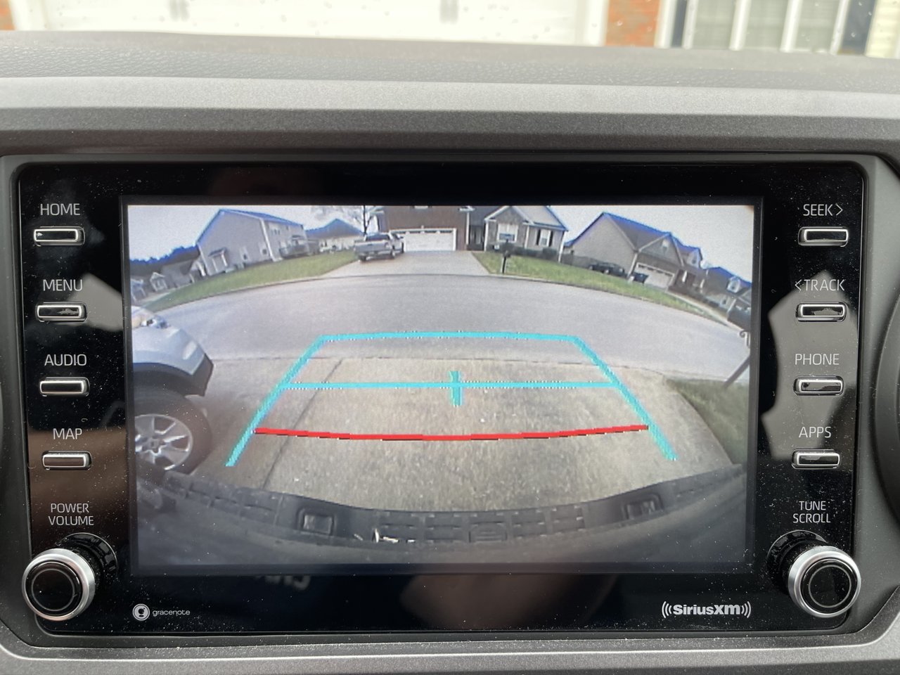

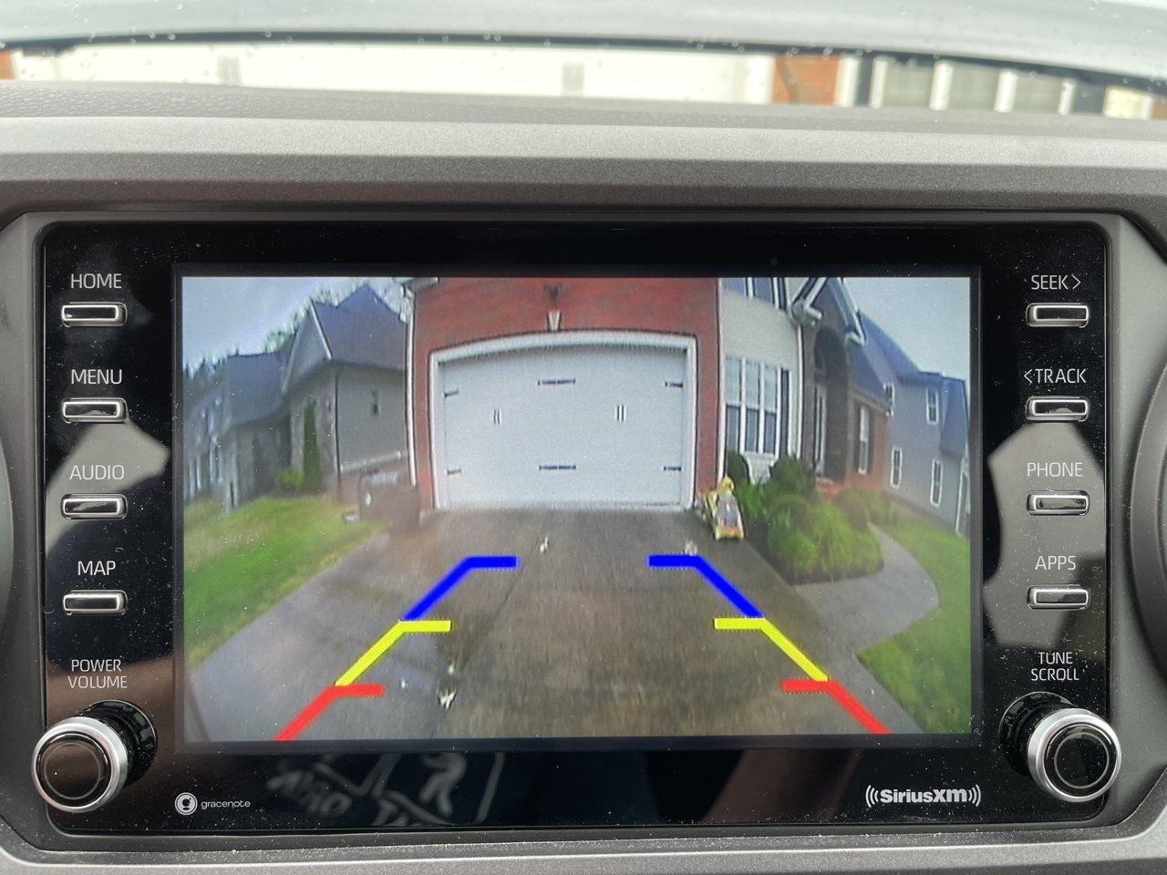

    Found some image quality comparisons on my phone since I have nothing to do while driving back that I did awhile ago. The nakita wasn’t installed, it was taped in front of where the camera goes because I was lazy and didn’t feel like taking the grill off the truck to get a picture of the image quality, but you can see how wide angle it is that it even pickups up the sides of the lens in the corners. You can even see with it an inch in front of where it normally sits, you still get way more FoV than the other camera that’s an inch back or so.
    1 OEM rear camera
    2 ruyoet
    3 nakita
    ruyoet comes with the lines disabled, you have to cut a wire to enable them. Nakita comes with the lines enabled and you have to cut a wire to disable them. That’s why the lines or there or not there.

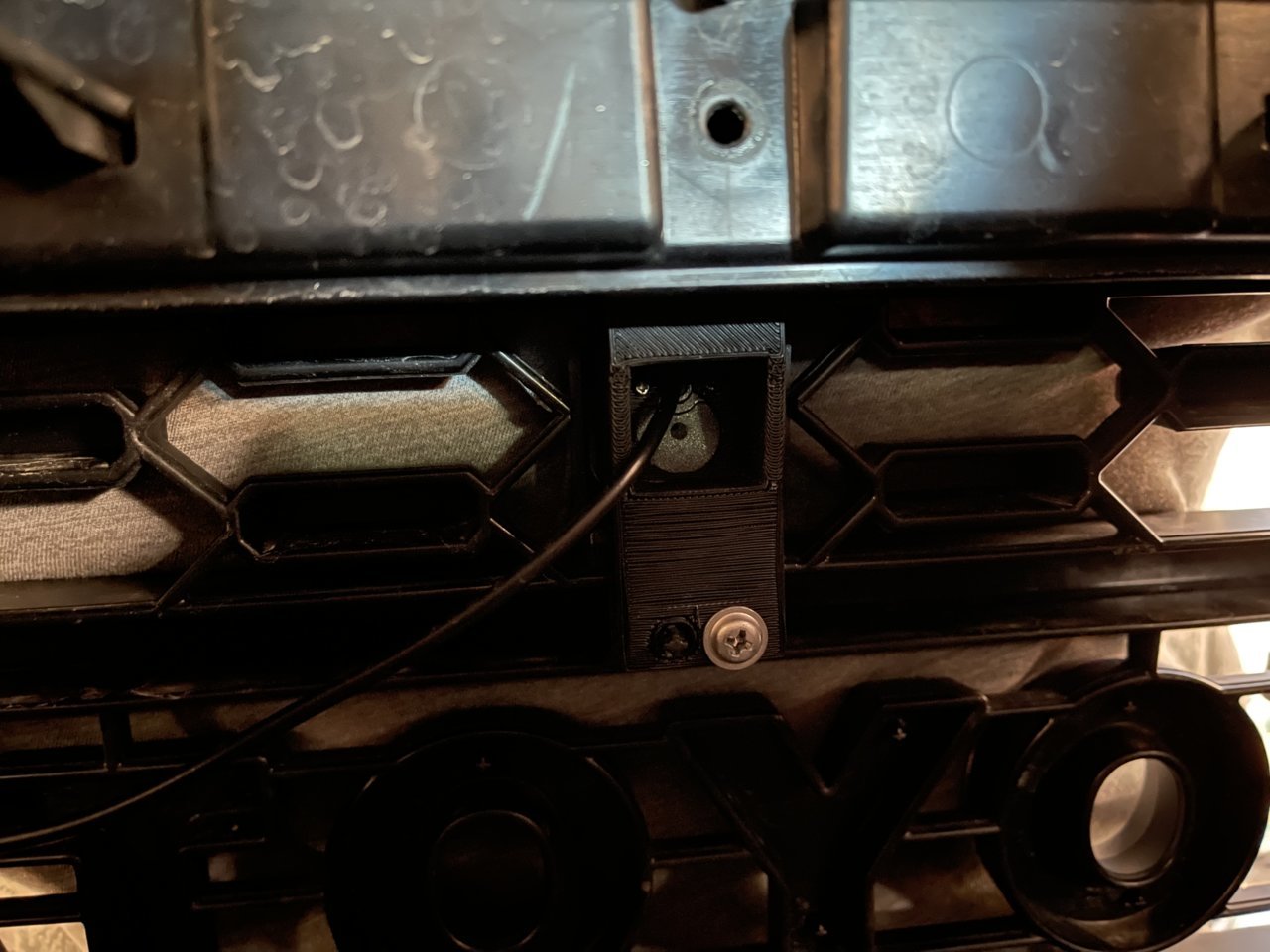

    DamGuide I removed the 3rd camera option this week and made a shim that works perfectly. Now the camera isn’t going anywhere. If interested and want to message me I can explain so you can manufacture.

    That’s pretty much the direction I am going to go, a shim that is doubled layered that will keep it centered in the hole and be flush with the surface of the grille.
