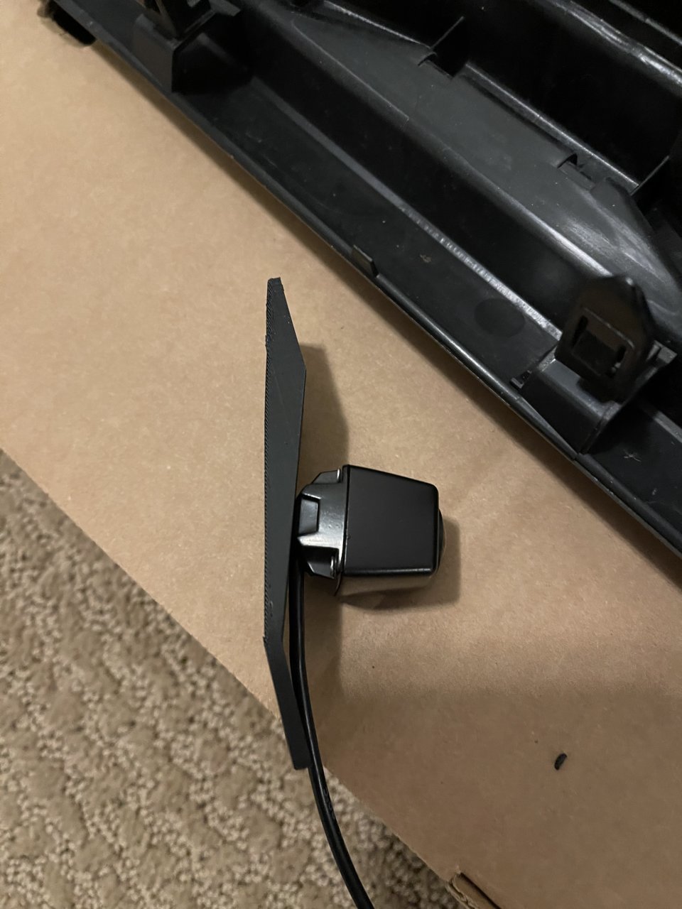

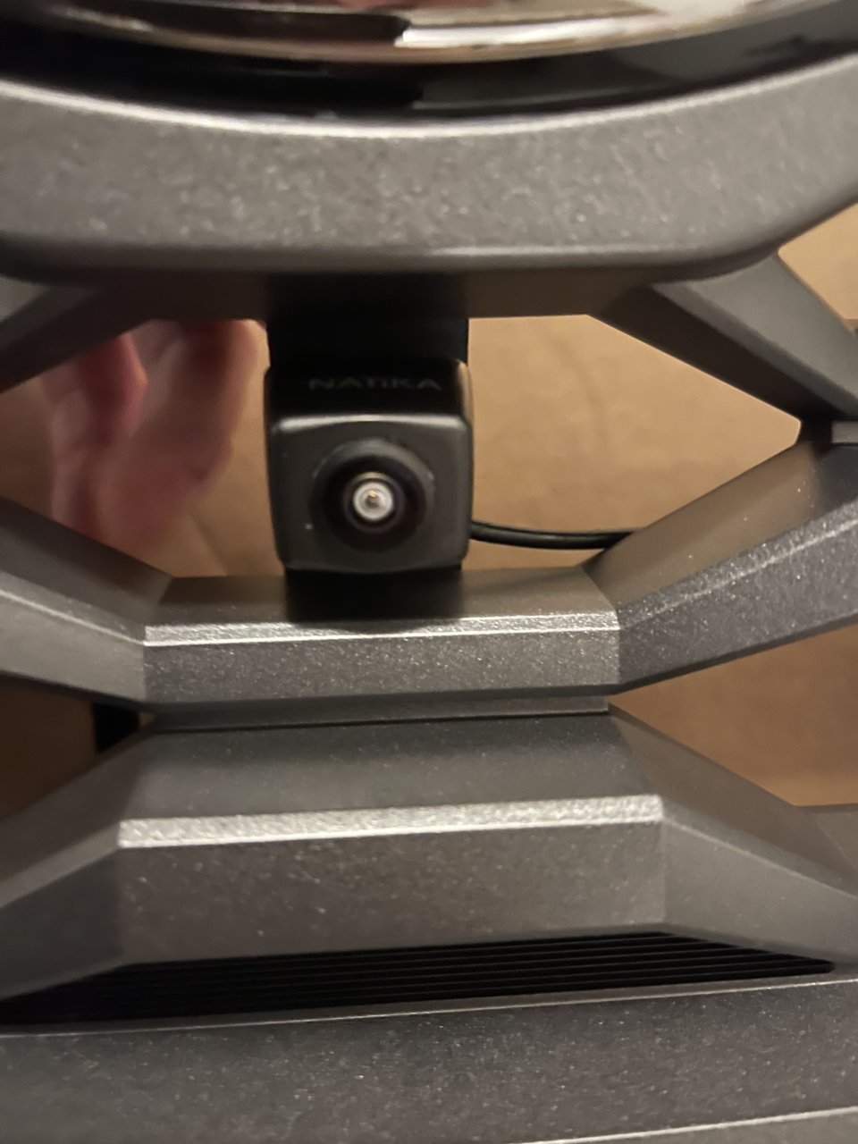

    I just installed the ABC kit with the upgraded front camera, and I’m a little disappointed in the image quality. But it does work as advertised.
    I have the new 2020 OR grill and it comes with the holes for the oem camera. I just grabbed a metal piece and bent it accordingly.

    You make one for the 2020 OR grill right? You have a pic? Price?

    $8, this is the nakita version, I’ve not made the ruyoet version yet.

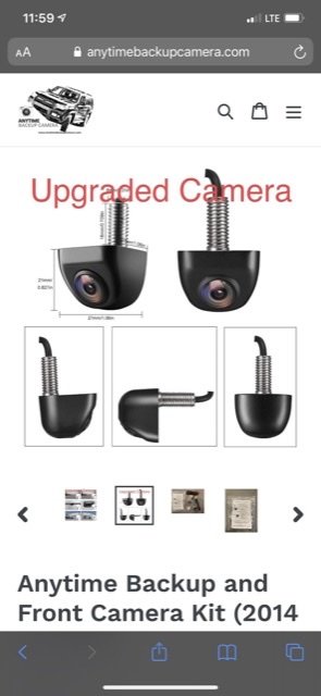

    Yea I have the anytime backup camera with the front camera mounted to my grill and it looks like absolute dogshit. The rear OEM camera looks pretty darn good to me, but this front camera looks like less than 480p. It's hardly useable. Wanted to be able to see rocks on the trail but the resolution is not really good enough for that.

    I have the natika version that comes with the ABC kit. 70733314-4517-4117-AFFF-37B283413ED9.jpg
    But I had to make the bracket extend forward

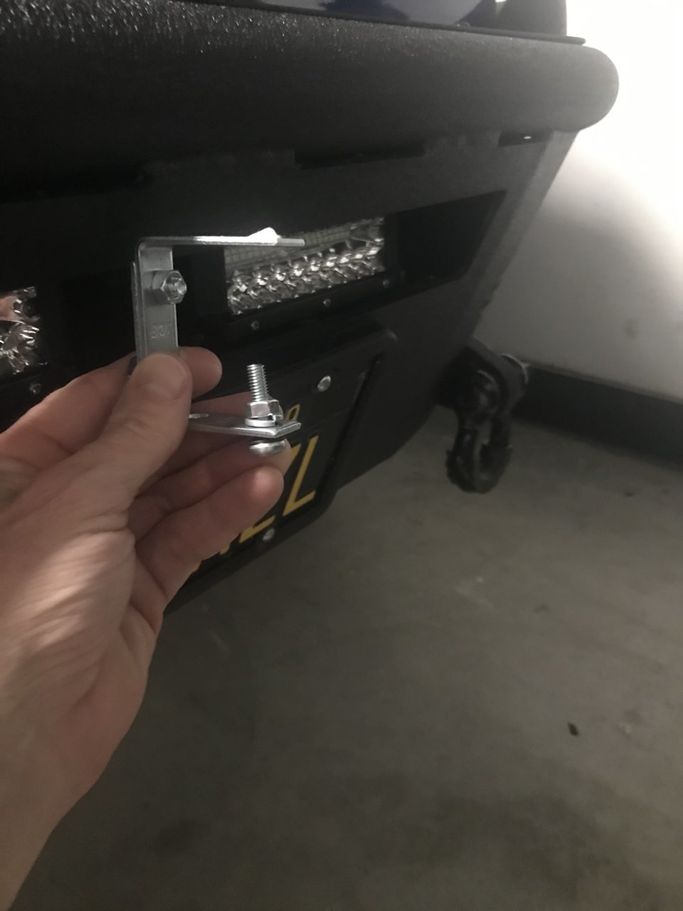

    I made a custom install bracket out of a couple of these little "Ace" brackets.

    That’s what I experienced this weekend. First time with the front cam on the trails. Better than no cam but cannot rely on the front cam at all.
