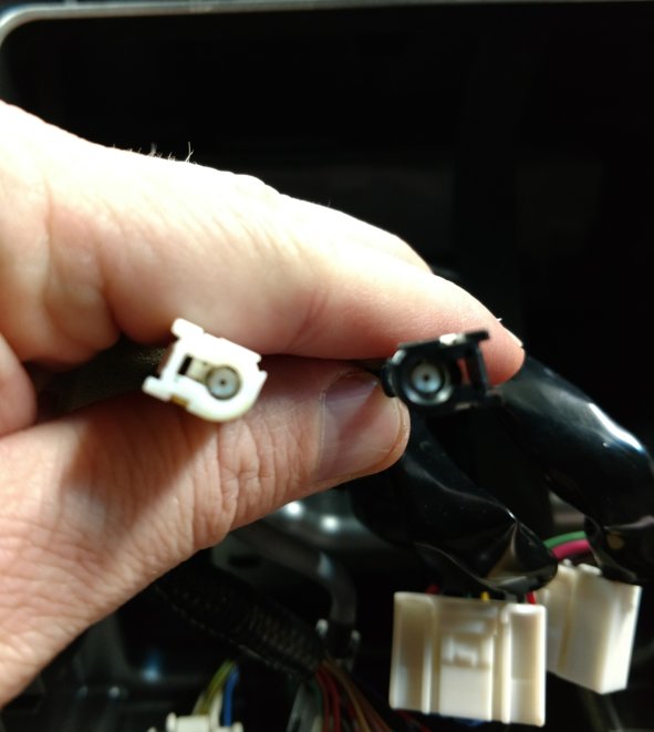

    Anyone know what these connections are for?
    My guess is the XM antenna and the mini jack near the usb plug..... new stereo does not utilize them.....
