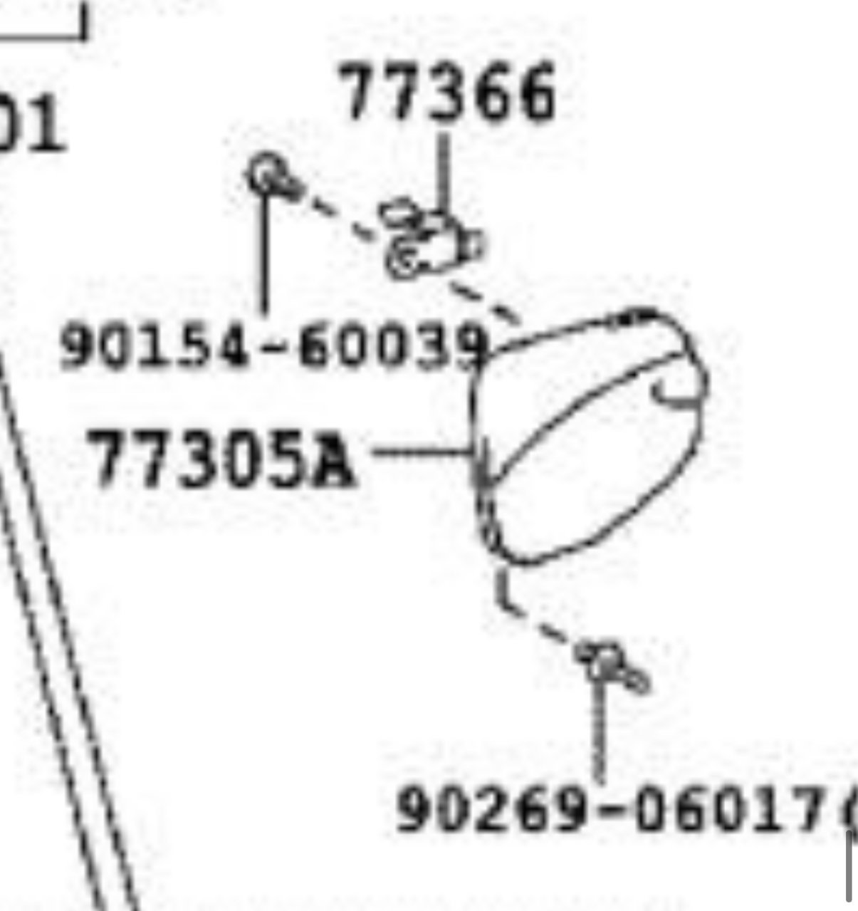

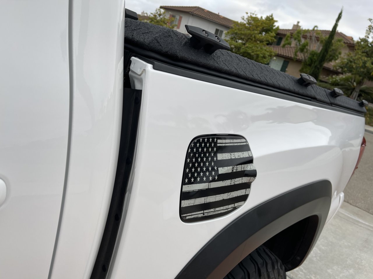

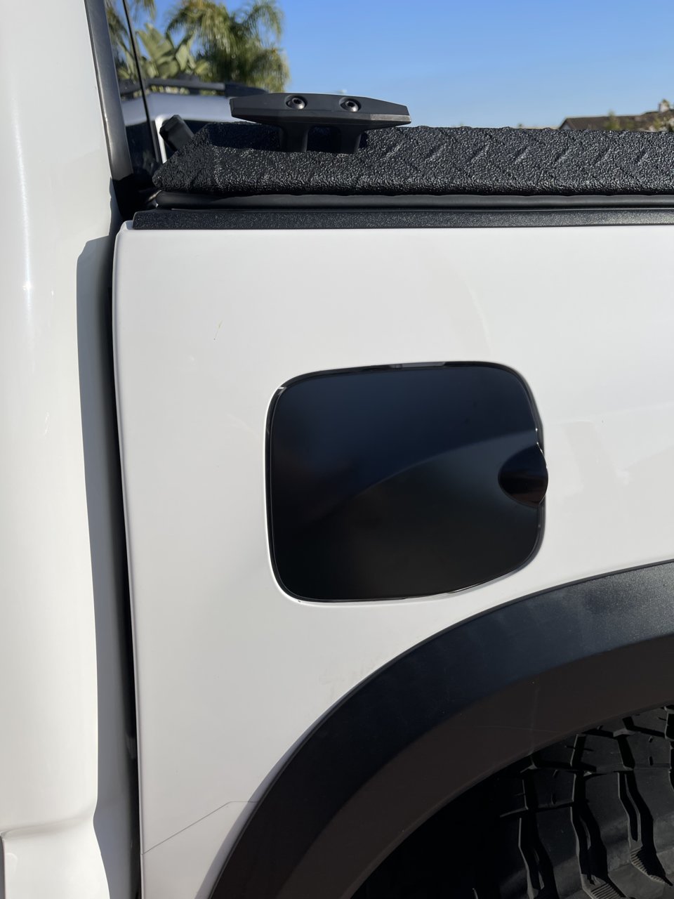

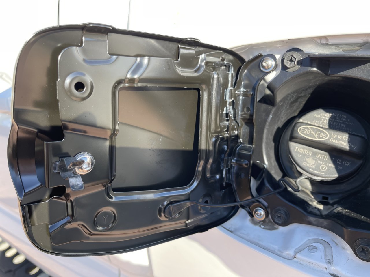

    https://www.tacomaworld.com/threads/fuel-door-rubbing-all-of-a-sudden.552936/page-2
    Found it while I was looking for the screw size for the spring clip because I couldn't remove mine from the old door even with locking pliers. Had to drill out the screw to get the clip.
    The screw is Toyota part # 90154-60039. Its about $1 but 2 local dealers will have to order them and I didn’t want to wait 2 days so I went to Lowes. M6 will fit perfectly. I also got a few washers because the top portion of the door isnt flush to the body. I used 2 m6 stainless washers and got it to align without bending any metal. I’m glad I used rivnuts instead of rivets or I wouldn’t be able to adjustment the door properly.
    Not done yet but this is what it looks so far. I can easily take it off with m5 hex if I decide to paint it.
    So yes its not aftermarket (mainly because theres none available) but the little changes made a big difference with the alignment. I don't think the old fuel door gaps were ever perfectly aligned with the body and now it is.
