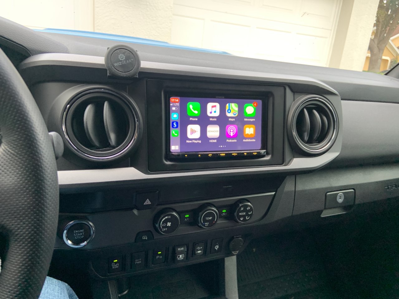

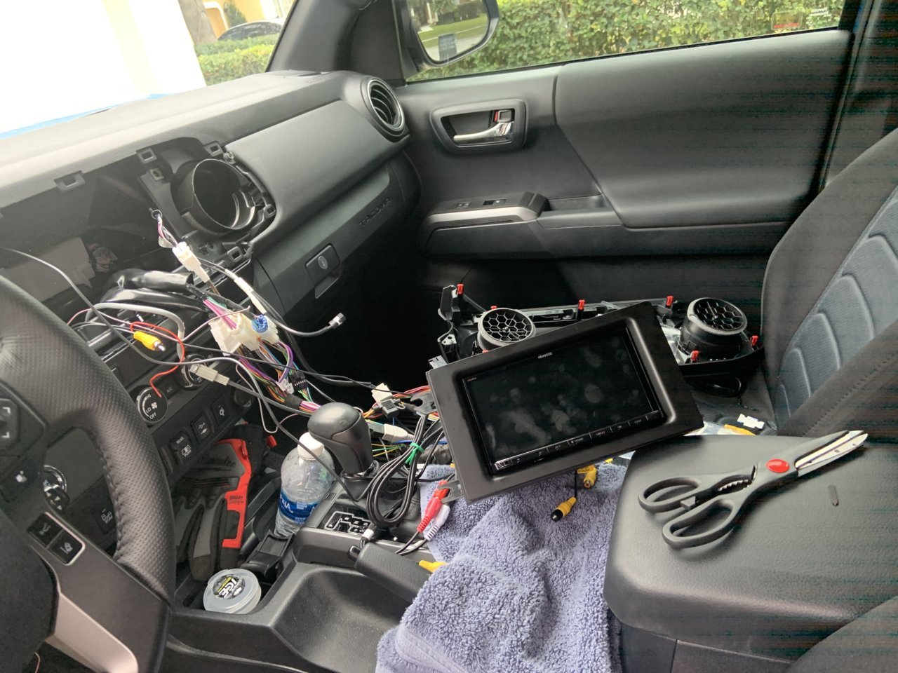

    So.... I did it, and I am pretty happy with the result!!
