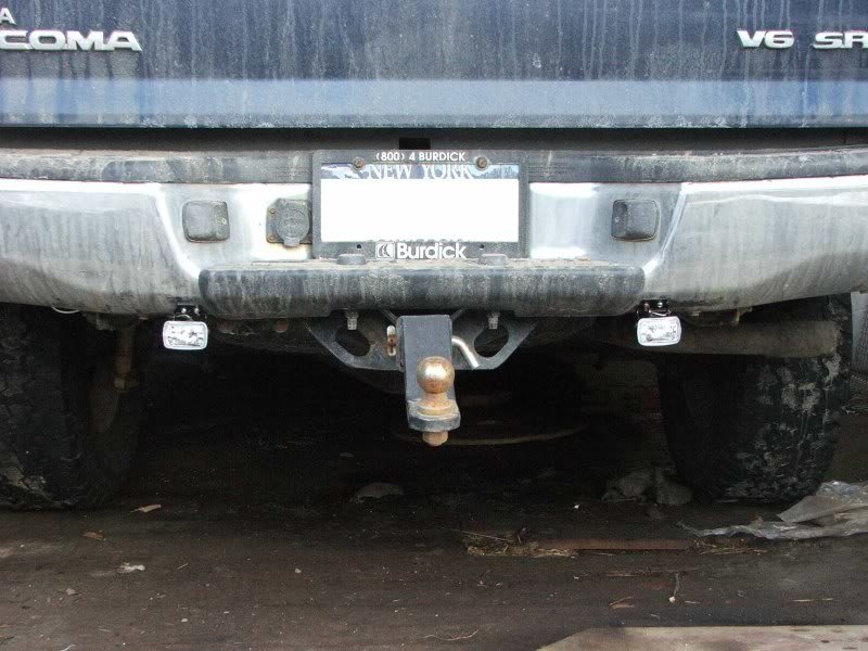

    I did a relay behind the driver side tail light with 12v coming straight from the battery since I've had too many fog/driving lights melt wires so I didn't want to splice them straight into the factory reverse light wires.

    Yeah, I just realized you have the round ones. lol I was looking for the smallest, least likely to be ripped off ones. So far I've only had to replace one bulb. Probably due to the rubber cap failing so I cover the back side with liquid electrical tape to seal it up. So far so good about a month later.

    I had figured that since they're level w/ the bottom of my hitch my tow ball will hit 2" or so before they do.... and even if they do, they were $15

    Well that was my thought too, but no point in tempting fate. :D
    I wanna get them switched as well so I can turn them on as work lights (or get off my ass lights sometimes), but I want to do a dual battery setup first. No point in draining the battery or wasting gas when I'm at my buddy's house trying to work in the dark.
