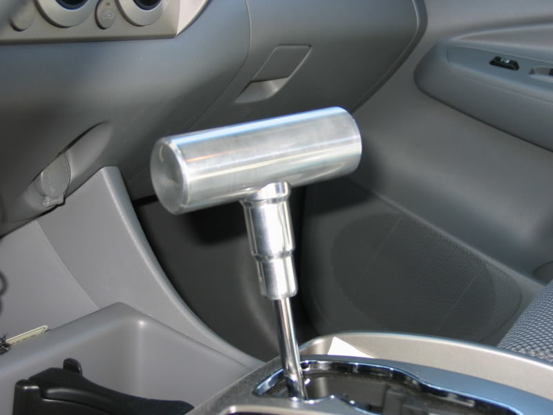

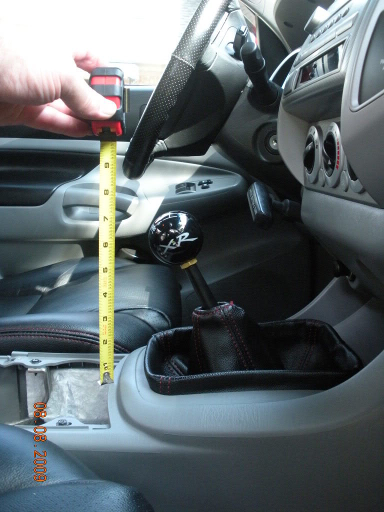

    Lots baby!
    X-R (X-Runner) on a shortened shifter.

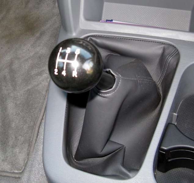

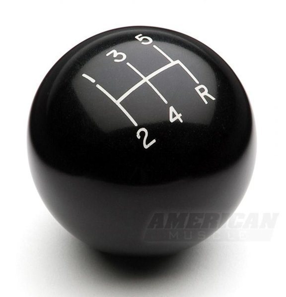

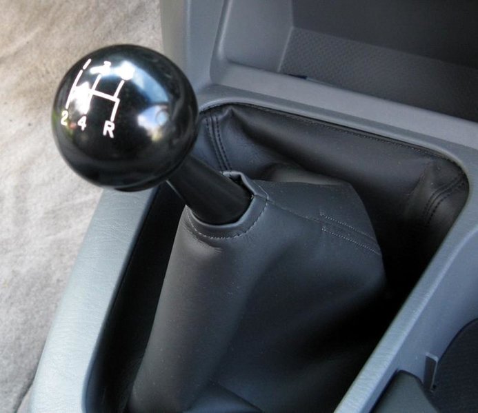

    Bought a black(also comes in white) Mustang 5-speed shift knob for $30 total, it worked out fairly well, I like it much better than the OEM knob. It came with a threaded metal insert(inset ~1/4"). I ran a M12x1.25 die down as far as I could on my shift lever, that way I was able to screw knob all the way till metal insert hit the shifter ridge. So my shifter is a tad bit shorter now... :cool:

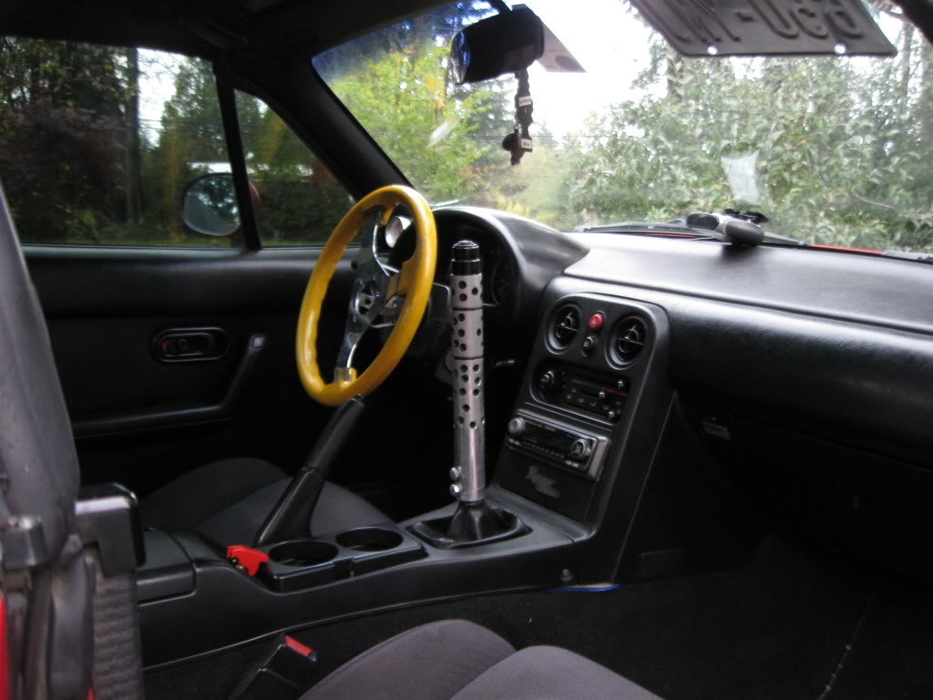

    :eek:Holly shit man that is crazy looking. What is it supposed to be a light saber or something?
  10. May 12, 2010 at 8:15 PM
    #30
    sb_mech22
    sb_mech22 yo quero taco's?
    May 1, 2010
    #36356
    155
    Sandy Eggo
    2019 Cement 4X4 TRD OR DCSB
    ahh yes....retards and their miatas. that could be the "pole" for the *** who drives it lol

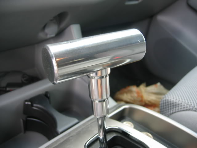

    Ooooo I'll play!
    Here's mine I made it a long time ago!:D

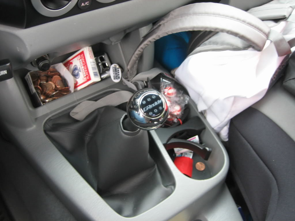

    my weighted greddy
