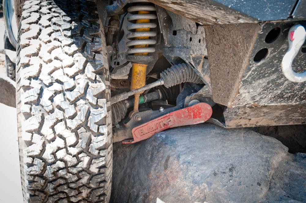

    LCA Skids
    BAMF
    Cost: $175
    http://www.bayareametalfab.com/LCA-Skids_p_11.html
    CNC cut 1/4" mild steel
    Has castor bolt protection
    the skid is the most protected LCA skid on the market. It comes up all the way up the LCA blocking tree roots and other things from hitting your CVs.

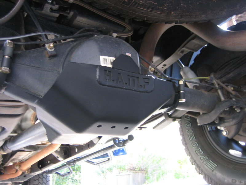

    Rear Diff Skid
    BAMF

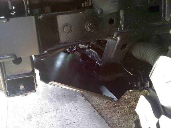

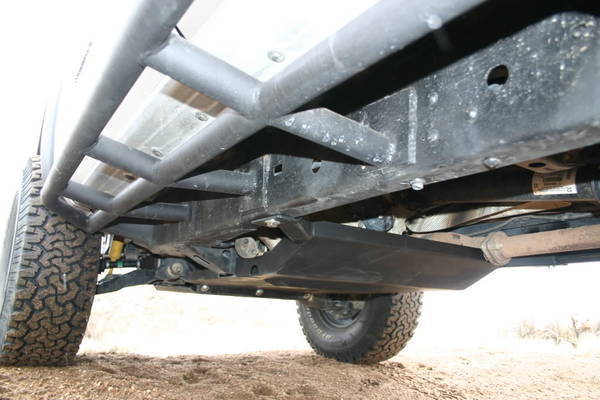

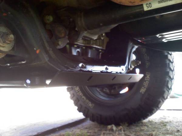

    Here are a couple of poor photos of Pelfreybilt IFS and MID skids on my 2006. I do not yet have the Transfer Case Skid.
    There are several good skids on the market. I selected Pelfreybilt for several reasons; I felt the skid coverage of the lower control arm cam alignment tab plates was very good and would protect them from bending during bottom outs and hard front impacts (Note in the photo that the skid is banged up where it protected the drivers-side cam tab). I also liked the three peice skid design with two flat bottoms, the IFS area and then the MID-Transfer case area which has a bit more clearance, which I feel maximized clearance.
    The skids fit well with no real installation issues. I sanded them and then rattle-canned them with clean metal primer and 3-4 coats of paint. Like any steel skids, they will rust where metal is exposed, and they take a beating on my truck, both from sandblasting by rocks kicked up by the front tires on high-speed gravel/desert roads (note the edge of MID skid in second photo where rock from the tires have blasted it) and from actual impacts on the trail. I am happy with the Pelfrey skids and would buy them again.
