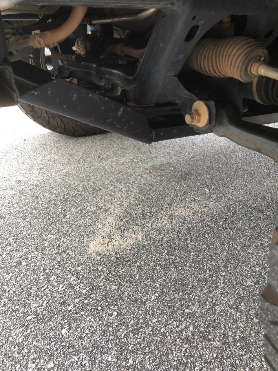

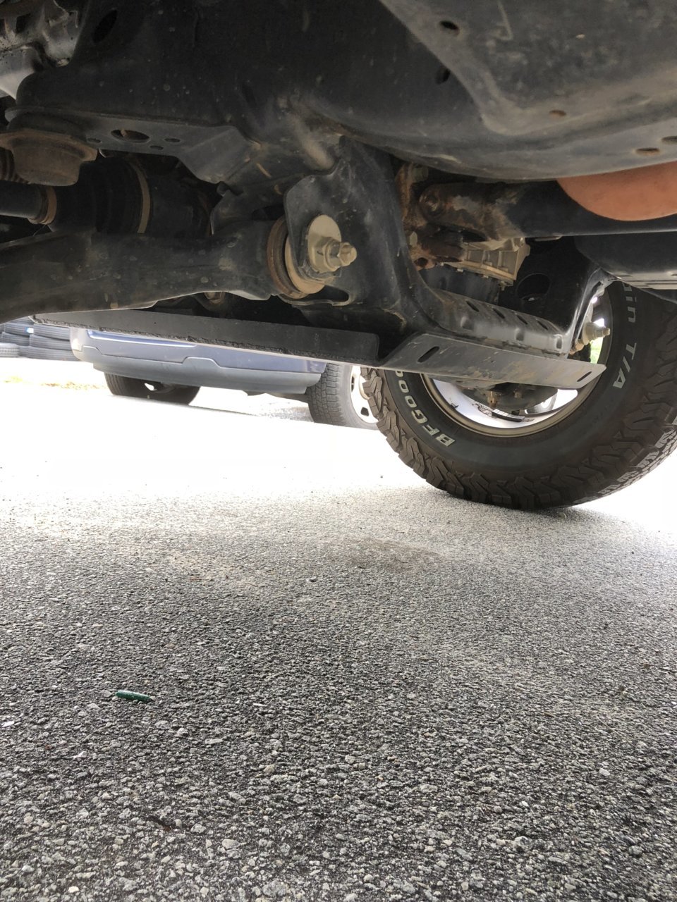

    Snapped some installed pics

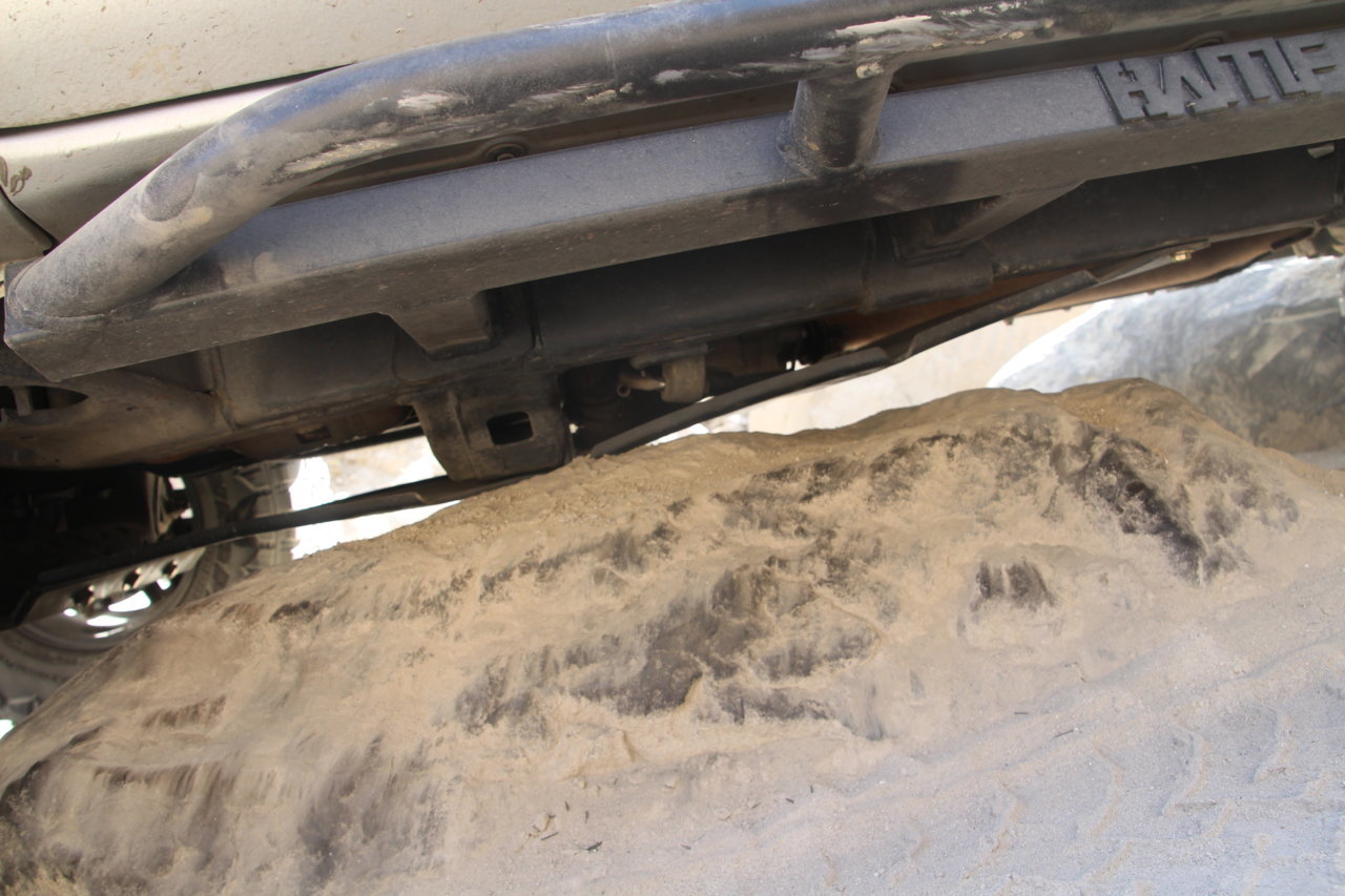

    Can’t say I would reccomend pelfrey if you actually wheel your truck and use the skids..
    T case skid is extremely bent after another trip (after this photo) and pretty much useless

    Jeez. What thickness is that skid? Looks thin!

    3/16”
    I’ll try to take a new pic....it’s pretty much taco’d
    All 3 are bent

    damn, good justification to go with the BAMF 1/4" skids...

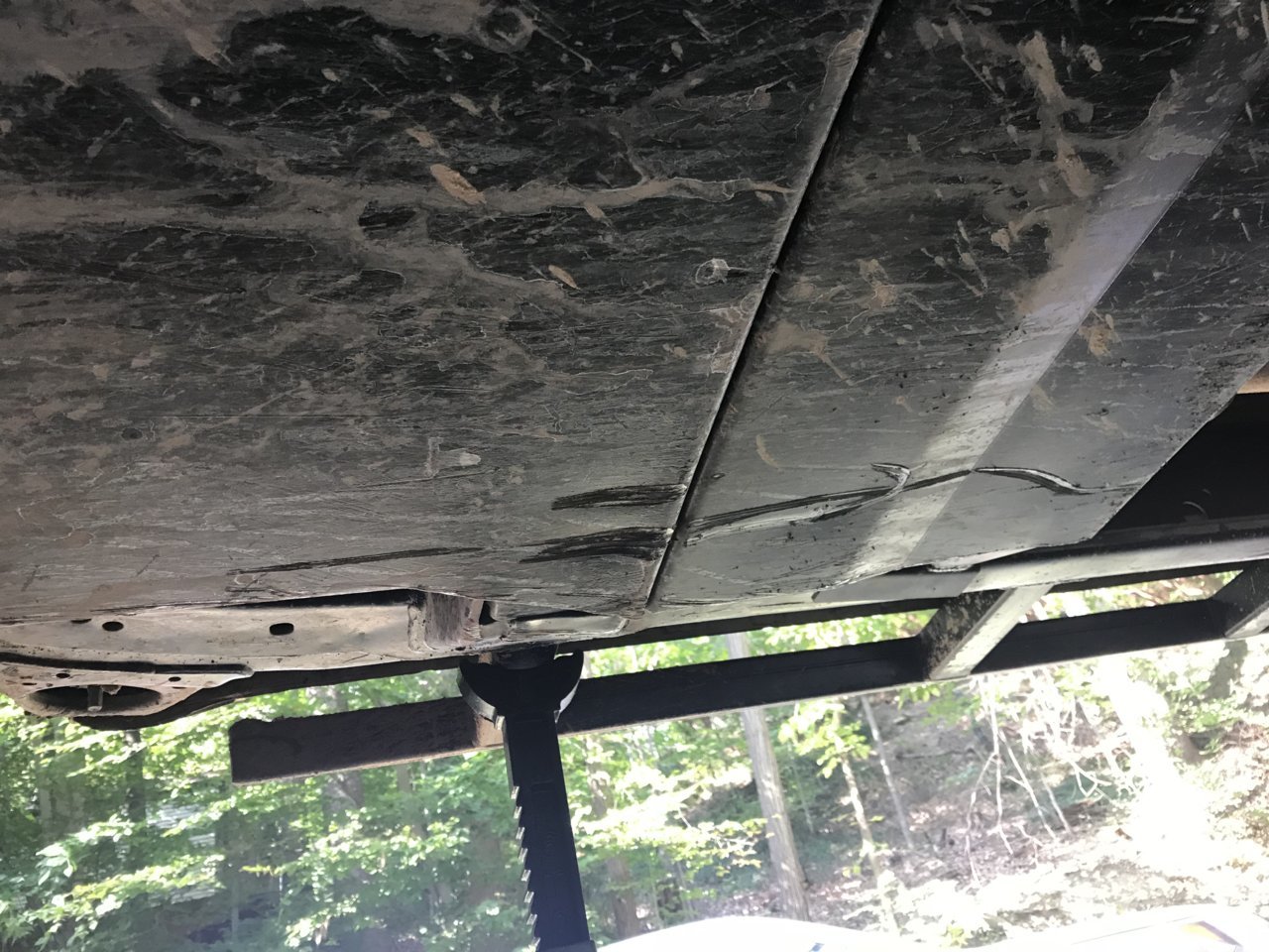

    Got this new battle scar from my most recent trip. Aluminum would not have fared well. If anyone plans on using their skids vs having them as an “oh shit” moment saver, go steel.
