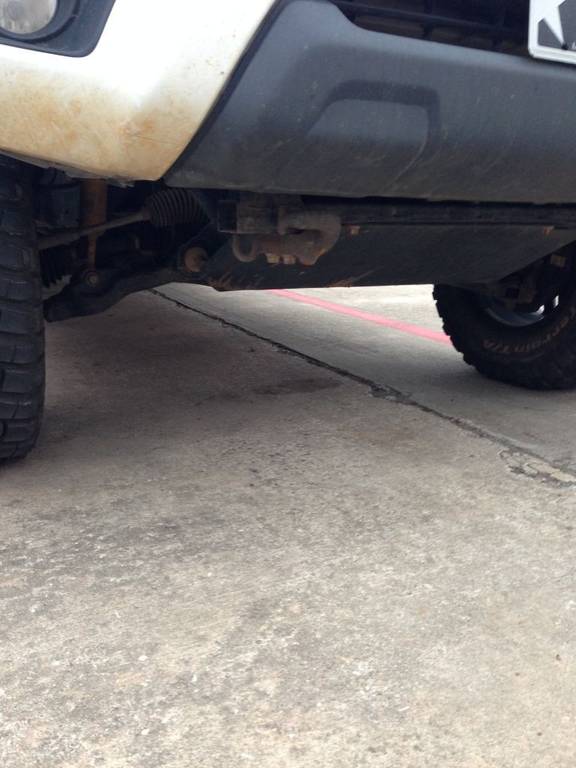

    Here is a pic, not the best but this skid has taken a beating.
    It was getting dark, I will take some better ones with a better camera in better lighting.
