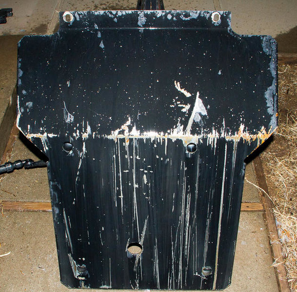

    2006 & 2016 DCSB TRD Off Road 6-Speed
    It does. This photo of my Pelfreybilt IFS skid shows the cutout for the oil drain plug.
    Also shows what a beating my truck would take without skids. This beating is from 6 months worth of wheeling since last paint.

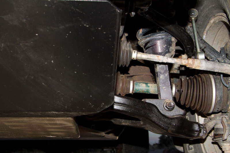

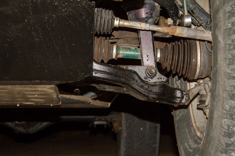

    I'd like to again point out a design feature that I feel is important. The coverage for the alignment cam tabs and lower control arm (LCA) bolts. One reason I went with Pelfreybilt was because of the coverage their design has for this area.
    Take a look at my beat up Pelfreybilt IFS skid (that I dropped to put my sway bar back on) and note the impacts in the areas that protect the alignment cam tabs and LCA bolts. The Pelfreybilt IFS skid clearly protected these somewhat fragile areas of my truck.
    Some designs cover this area, others do not. I think it is important.

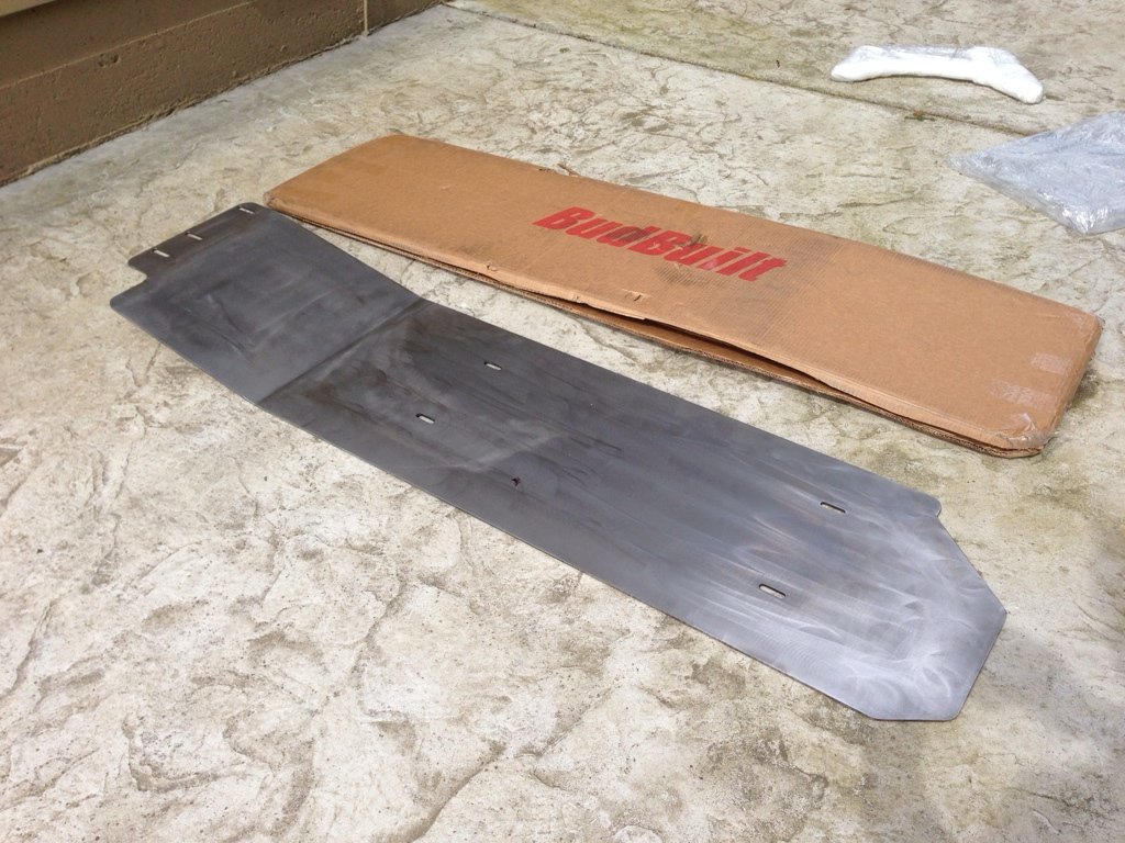

    I received my Budbilt gas tank skid today. Very nice product...

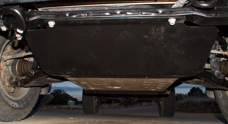

    ATO Full Skid (Not Including Gas Tank Skid) Set Review
    Pros:
    The fit of these skids are great, and the IFS even helps protect against damage of the LCA cam tab bolts by being fairly wide in the front. IFS is 1/4'' steel and very heavy duty. It weighs about 70# and is quite a beast to put on by yourself, (but doable) although a floor jack definitely helps. Transmission skid is 3/16'' steel and weighs about 30#. Fits well and protects a large area. Transfer case skid is also 3/16'' steel and weighs about 50# with the crossmember piece. They all fit together very nicely, and all holes lined up great.
    Cons / Observations:
    You will have to reroute your stock exhaust to fit the transfer case skid. The bolts provided from ATO are cheap allen heads, which I highly dislike. I tossed all the allen bolts after stripping two of them while just test fitting the skids, and upgraded to Grade 8 hex bolts for all holes that didn't reuse stock bolts. I highly recommend doing this if you get these skids. These skids are very heavy (about 150# for full set) so be prepared to see a drop in your front suspension, especially if you are not running at least 650# coils. This is just an observation, although it could be a con to some users. Just be wary of the weight you are putting onto your truck, as it affects acceleration, braking, turning, etc.
    Overall, I am happy with the ATO skids, and I fully trust them to protect my undercarriage.
