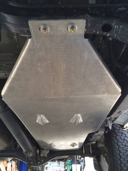

    mounted this yesterday. OR stock skid hanger used, washer plate on cross member up front.
    "darts" protect hanger nuts
  13. Mar 15, 2015 at 11:53 AM
    #173
    yeos
    yeos OCD Member
    Feb 24, 2013
    #98297
    1,221
    Moses Lake, WA
    2007 Lexus GX
    Those look great! I'm actually in the market for a Pelfreybilt aluminum IFS skid.

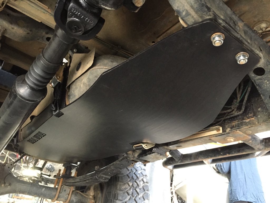

    My skids are from Skid Row Offroad.
    I was initially pointed towards Bubuilt by a few people but after my research I found these guys (and someone recommended them as well). At first the price wasn't too good on the wallet, but the design is superior than the Buds. These ones have countersunk bolt holes, openings for changing oil, extra metal on the sides to protect (where Buds didn't have any), and they also came powdercoated.
    What really changed my mind too is I found out you can get them through Four Wheel Parts...they were cheaper through them rather than direct online from the company AND I got military discount AND free shipping! So I got something nicer for way cheaper than the Buds.
    I did have to space mine out a little to account for my 1" diff drop.

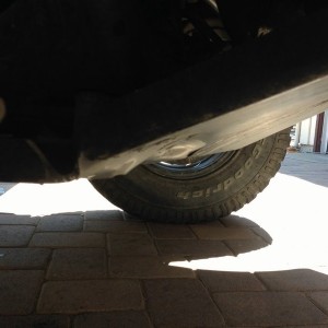

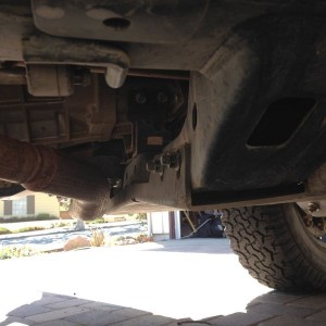

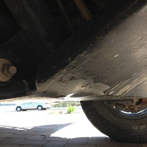

    [​IMG] [​IMG]
    This is the IFS aluminum skid. Ever since I hit the boulder, my steering wheel isn't straight but my wheels are. It's not like my truck drifts at speed, but when I left go of the wheel it goes straight on the highway but my steering wheel is at one o'clock. Hoping it's just alignment (and not a steering issue) since the plate was forced up into the LCA, just put on new UCAs and getting an alignment today. It seems the support tower in the front of the skid that touches the front crossmember may have pushed it up a smidge? You can see where the post is by the amount of warping around the hole in the center of the photo surrounded by bare aluminum. But then again it's aluminum and maybe it warped instead of causing damage. Is it worth taking off and trying to bang out the dents?
    This is the damage to the 3/8" steel mid skid (and yes I am very lucky it didn't damage my pipe. I think when the boulder hit the mid skid, there was enough force to launch the truck off thanks to the strength of the steel)
    I've also noticed a slight metallic whirring sound...almost like when you have loose washers spinning around a bolt...when I'm driving down the street and hitting whatever tiny little bumps there are. It's only noticeable when the windows are down, the radio is low and I'm driving next to parked cars or walls. Any ideas? I checked all the skid plates, the nuts are tight. When I changed out the UCAs, I checked for any visible parts that may be loose. I wonder if it's also affecting the steering?
