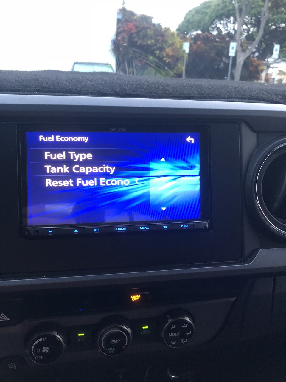

    Yes you can change things in settings.
    Not sure on apps for mpg , I just look at the hud for that.

    Awesome, thanks for the quick update. Probably going to order this tonight. The reason I ask about the mpg is because I have the Sr and it's not in the HUD.

    Doesn’t seem it’ll show mpg like the hud but there is a few things like:C4CEF264-E176-4171-B64B-F623D88C31A8.jpg

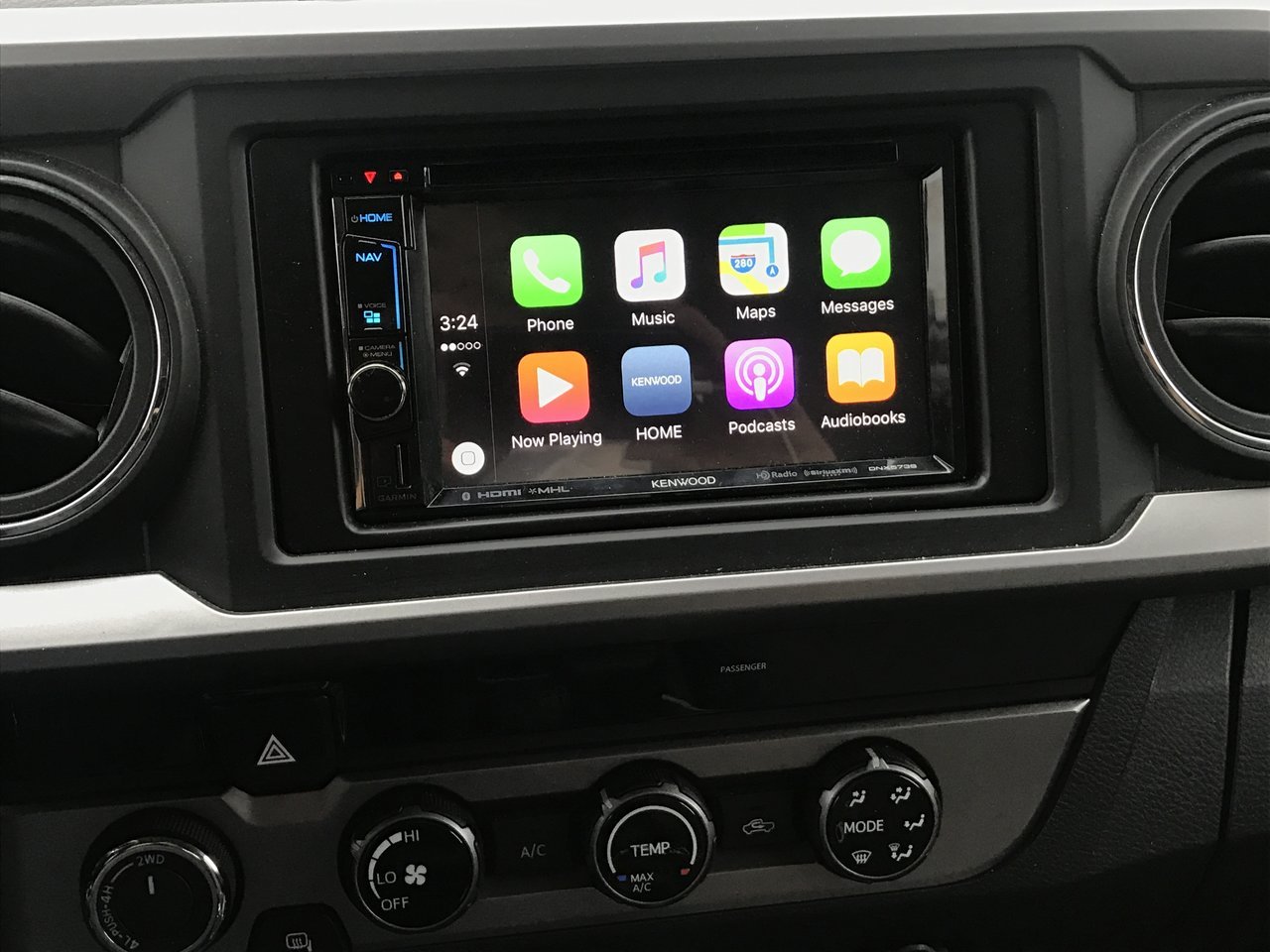

    Kenwood DNX-573s, installed it myself, got everything from Crutchfeild. You do have to hook the mastreo to a PC and then go to their site and answer a few questions about the vehicle and head unit and then it programs the mastreo. It can still change vehicle settings. I did have to install the mic it came with. Really wasn’t any harder than others I’ve done just a bit more time consuming with the mastreo and such. I didn’t want the Sirius/xm so idk about that part.
