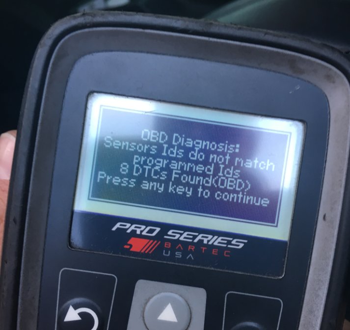

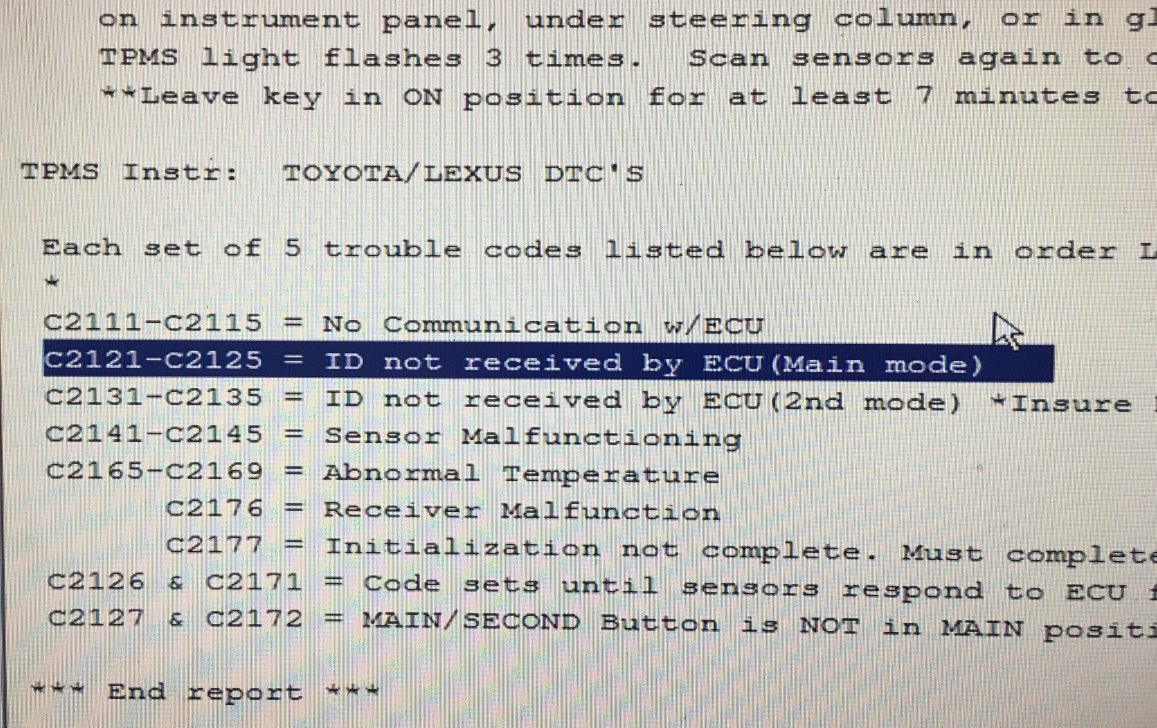

    I've had 5 shops/dealers try to get my TPMS synced to the stupid truck with no luck. I finally had the error scanned today (see pics). When I contacted Custom Offsets (CustomOffsets.com) they told me they "have better results with their sensors compared to Toyotas OEM, and that OEM sometimes isn't made for the thickness of some aftermarket wheels to give a strong enough signal." They also said "All Toyotas are finicky about syncing with any aftermarket sensor" which I'm gonna call bullshit on, and they conveniently failed to mention this when they were eagerly selling me the wheel/tire package. Instead I was told "The TPMS work wirelessly and we are up to speed with the latest vehicle TPMS systems." Yeah, obviously. I've long since sold my stocks with the TPMS in them, so now I'll be out the cost of a breakdown/remount and a new set of OEM sensors - with only the hope that it'll work.
    Anyone else had problems with aftermarket sensors? Anyone had problems with Custom Offsets sensors specifically? Anyone found a way around the errors I'm getting?

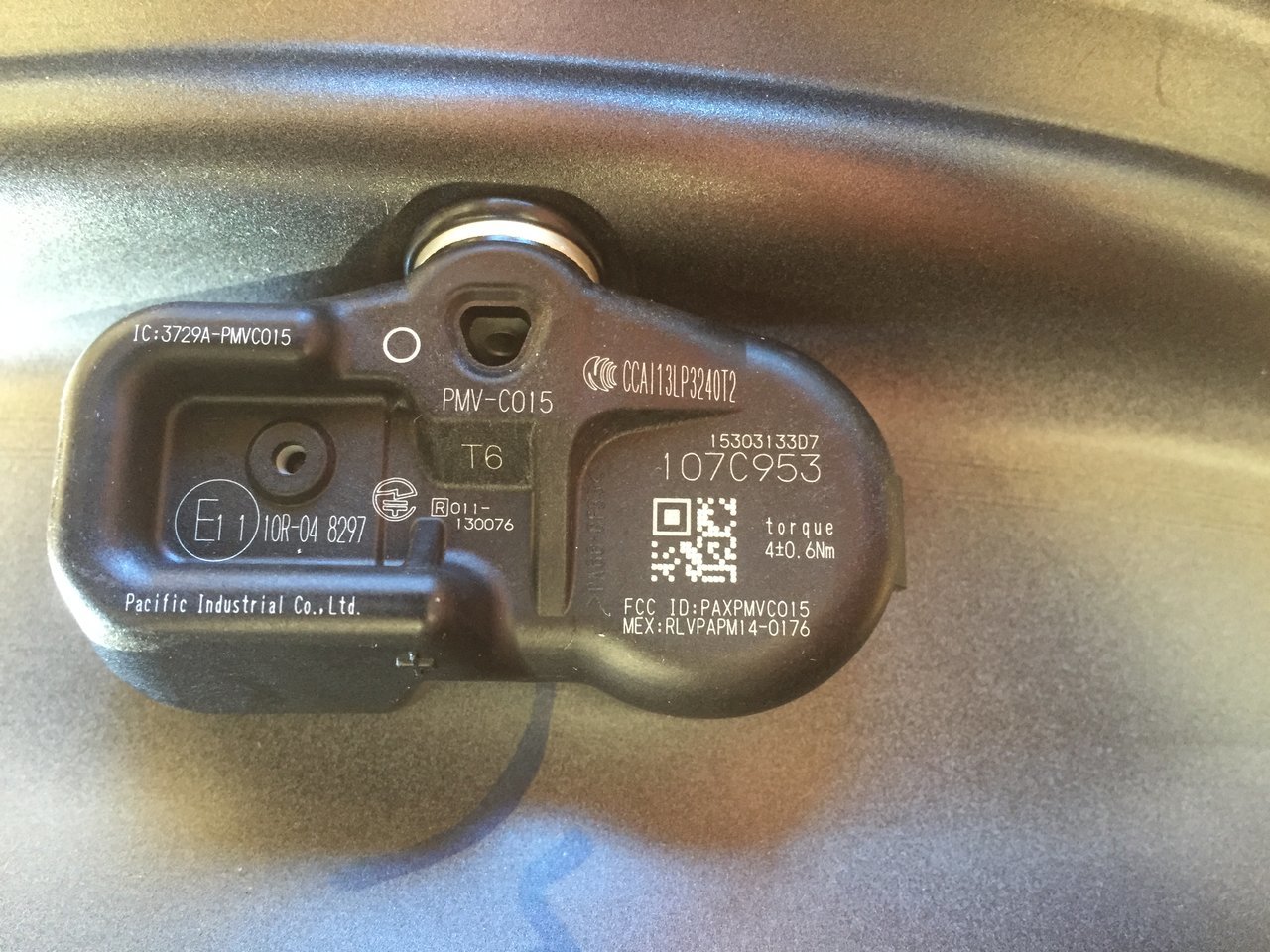

    OEM sensors are made by Pacific Industrial. I've only seen a couple of people on these forums say that they got aftermarket sensors to work and no one has provided specific info on what they used. Picture is an OEM sensor. 107C953 is the ID number of this particular sensor.IMG_0397.jpg
