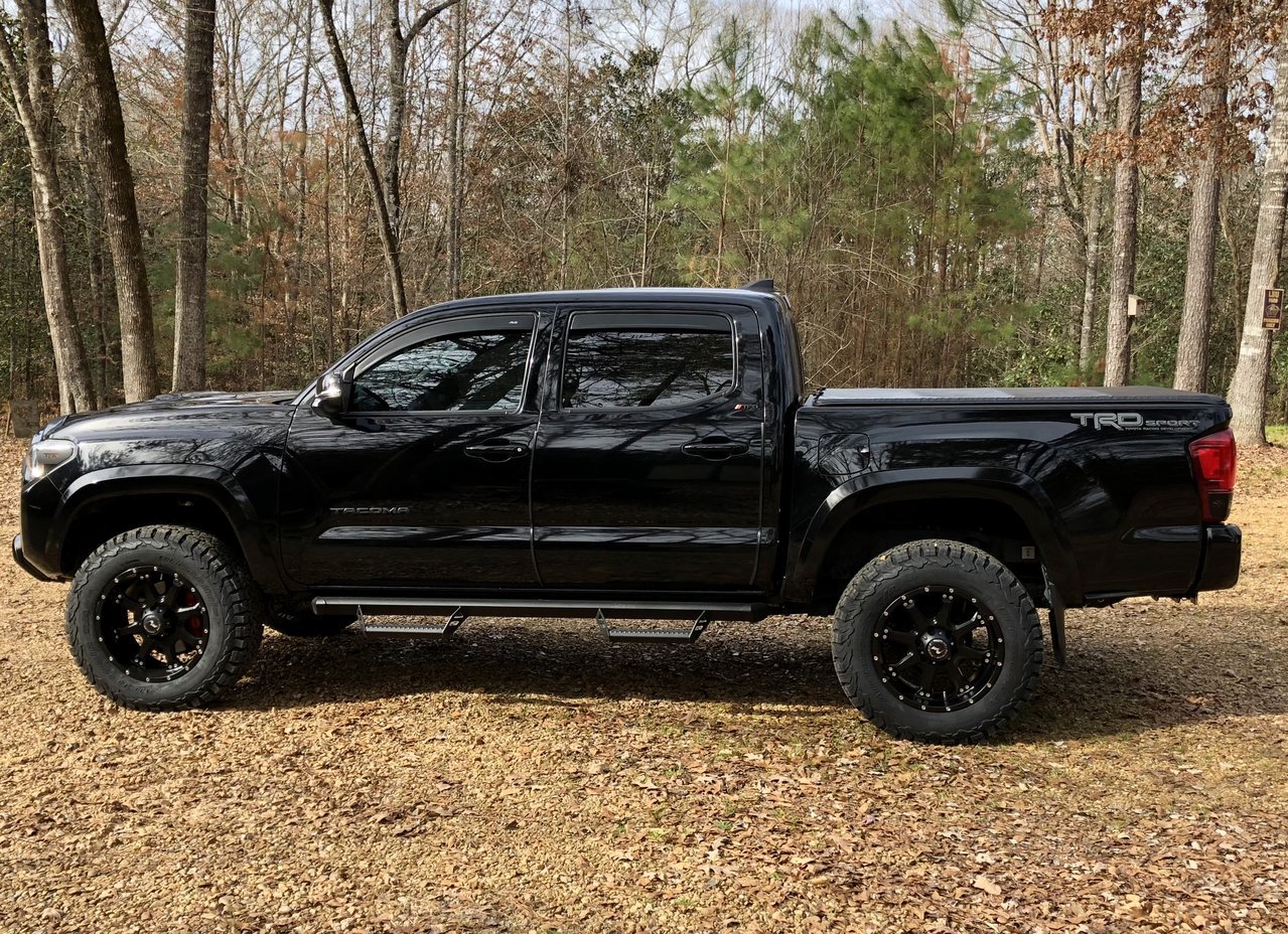

    GTS Dobinson's lift, 33"-Wildpeak Atw3-18x9 -6 Offset ,265/70/18 tires, Raceline Assault wheels, Backflip G2 bed cover, Magnaflow exhaust, Pro tail lights, Pro fog lights, Pro grille, Raptor grille lights, Predator side steps, RedLine Hood Struts, Toyota bedmat, tinted windows, Retrofitted-BHLM-Amber Halo-Amber DRL-HID headlights, LED Highbeams, LED Hood Scoop lightbar, LED hidden bumper lightbar, LED under hood light, LED Bed lights, LED license plate lights, Tacoma tailgate 3d letters, Tacoma glovebox 3D letters, removed air dam, Custom TRD Sport emblems, Pro Shift Knob with Meso ECT Stealth button, Meso LED dome and map lights, Meso V3 smoked mirror turn signals, Meso Stage 2 Tail lights, Meso Mirror Puddle lights, Meso KC-5 Brake/Cargo light, Meso center console bucket with OG lid, Tailgate PNP kit, Garage door opener button in overhead console, Meso Minimalist keyfobs, Matte black Pro hood decal, KTJO4x4 Led door handle LED lights, Pioneer 6x9 3 way front speakers, Rockford Fosgate 6.75' rear speakers, TacoTunes tweeters, AJT black vent rings, JDM Gas cap cover.
    Got my rims and tires from Custom Offsets with TPMS installed by them. Just had my local tire shop scan them and hooked up to my truck’s obd to set them up. Took about 5 minutes. All works good! I guess you gotta find a place with the right TPMS reader. It was a handheld machine that the guy used. Ross tires in Central, Louisiana was the place.
    Ps. Love my new rims and tires. Raceline 18x9 -6 offset. Bfg KO2s 275/65/18 E rated. $1771 with TPMS and black lugs, mounted, balanced, and shipped ready to put on.
