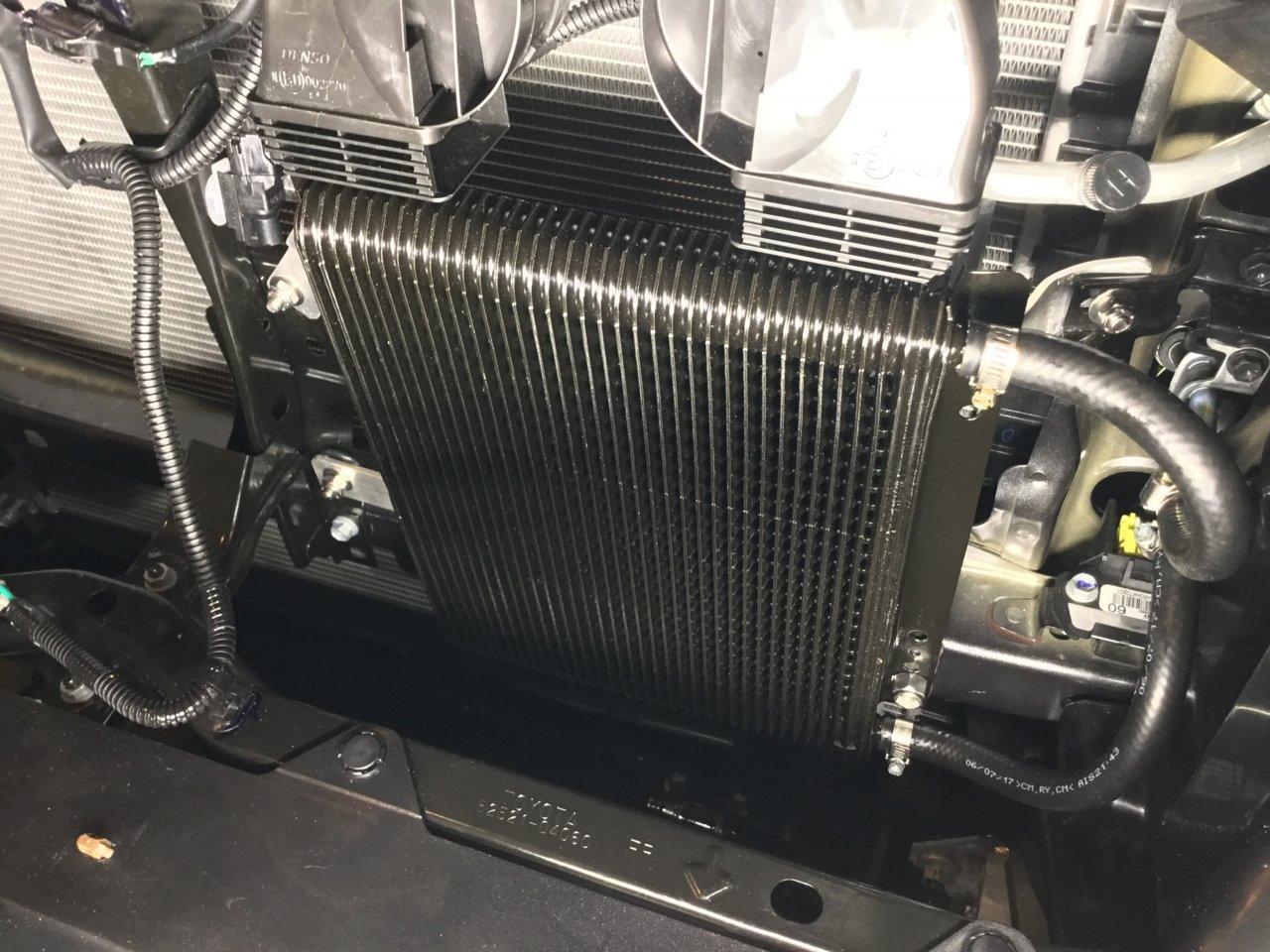

    Long Manufacturing makes both ‘B&M’ super coolers and ‘Tru-cool’ coolers which are exactly the same.
    Both have had ‘Long Manufacturing’ stamped on them.
    I have purchased both before.
    Save yourself $30.00 to $40.00 or more and buy the Tru-Cool cooler.
    This is a 4589 installed. A 4590 would also easily fit if you want to go biggest.
    AA2B45B0-022C-4321-A32B-2D2B8F4F6C2C.jpg CA9403A3-8729-46CA-ABD5-D04A25E99CFB.jpg 57E0A287-844B-4CBF-885B-0D3346D895C9.jpg
