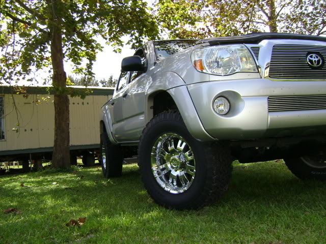

    I have a 3" lift and 33s all my trimming is done, only rubs at full lock in reverse. Aftermarket 17" wheels. TC UCA's.
    I'm wanting a set of TRD Offroad rims, negotiating purchase now. I know the largest tire size I can install without spacers is a 265/75/16 which are 31.6" tall.
    I would really prefer to have 33s on the truck though or at least closer to 33s. Its my understanding that the 285/75/16 (32.8") rub the stock UCA's and require trimming. I already have the trimming done so the question is will they rub my TC UCA's?
