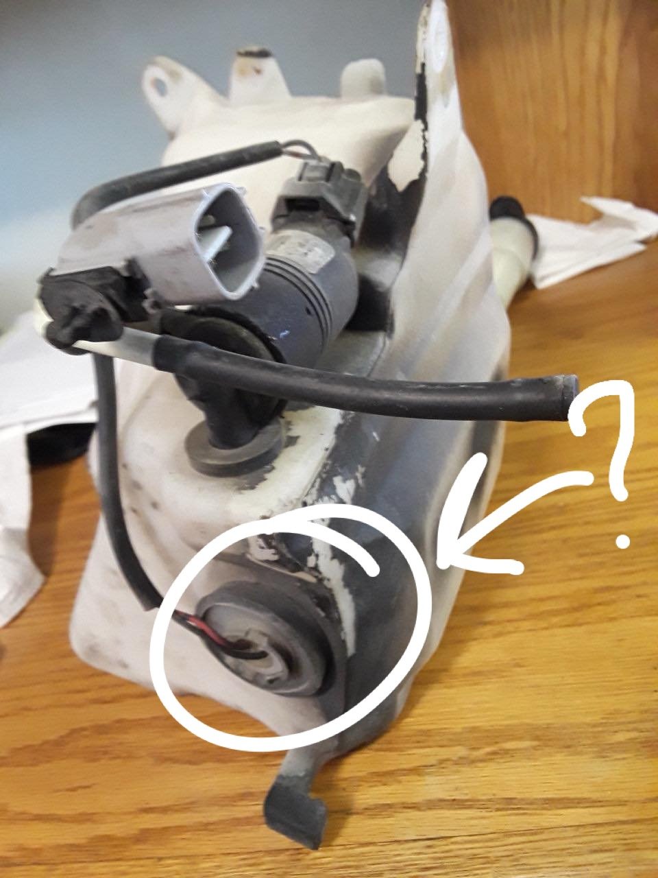

    I put an aftermarket reservoir and pump combo on my 2002 prerunner and it works great. When I got the truck the low washer fluid level was on , after I changed everything the light is still on. I do not understand where the sensor foe the fluid level is.
  3. Jan 18, 2024 at 2:45 AM
    #23
    rocknbil
    rocknbil [OP] Well-Known Member
    Jan 5, 2023
    #414860
    1,099
    Bill
    2003 Taco Ext Cab DLX TRD 4WD MT 3.4L
    See the second pic in post #2 - the sensor is in the bottom hole secured by a rubber grommet.

  5. Jan 18, 2024 at 7:18 PM
    #25
    Madjik_Man
    Madjik_Man The Rembrandt of Rattle Can
    Dec 2, 2009
    #26893
    19,692
    Colorado Front Range
    1998 Ext Cab 3.4 4x4 TRD 5MT, 2004 DC 3.4 4x4 TRD
    Cold weather package also included a beefier wiper motor (to help push snow/ice/etc)
    PN 85110-04020 (the non cold weather motor is 85110-04010)
  6. Jan 21, 2024 at 8:16 AM
    #26
    newoldstaco
    newoldstaco Well-Known Member
    Jan 11, 2021
    #352422
    91
    is it the thing I have circled???
    otmeeks77 likes this.
  7. Jan 21, 2024 at 12:32 PM
    #27
    rocknbil
    Jan 5, 2023
    #414860
    1,099
    Bill
    If by "it" you mean the fluid level sensor, yes that is correct. The other thing above it is the actual washer pump. Many A.M. reservoirs come with a new pump, see previous posts (mine did.)

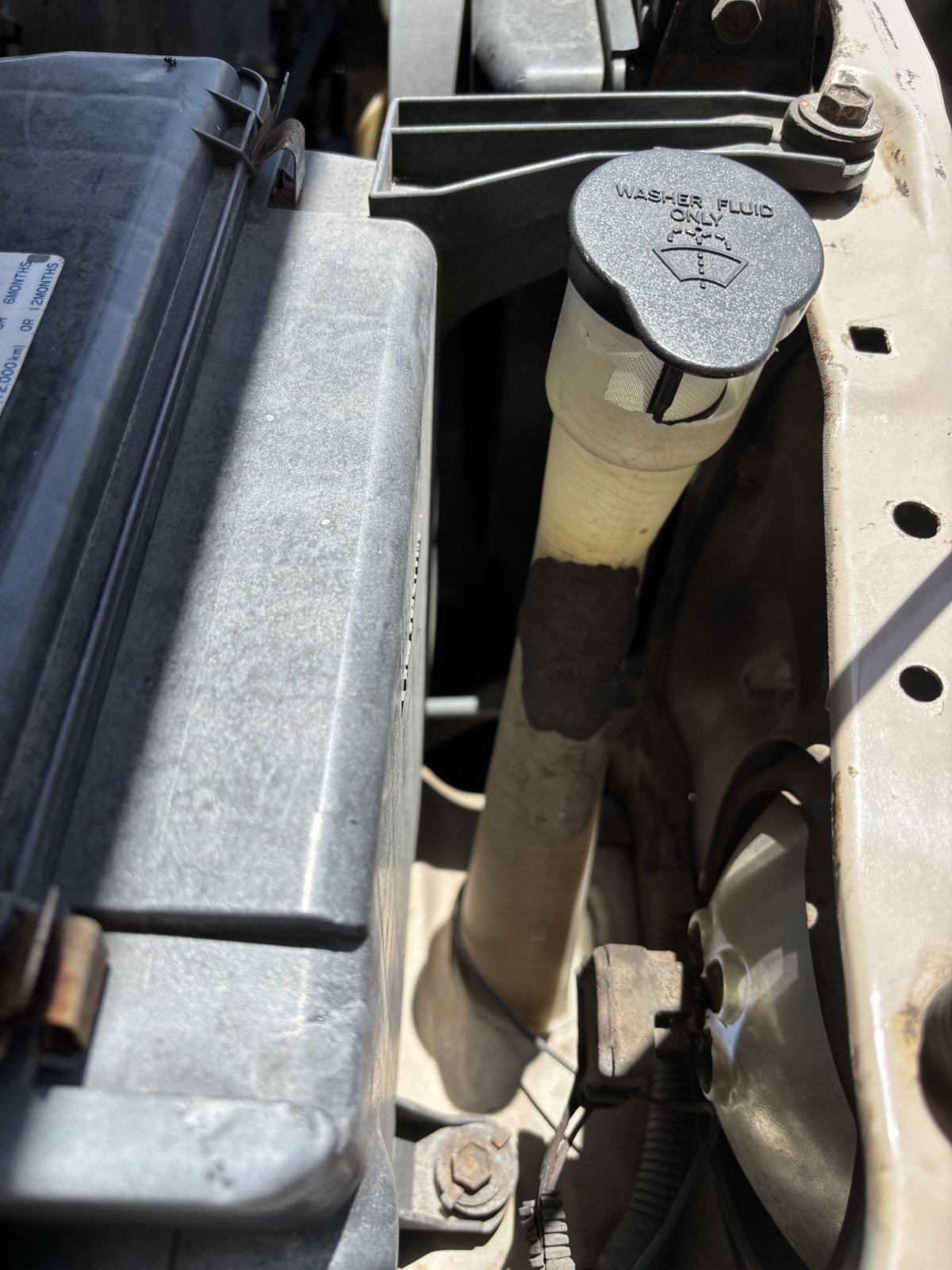

  8. Apr 1, 2024 at 11:07 AM
    #28
    c808nner
    c808nner Well-Known Member
    May 29, 2019
    #294700
    205
    Oahu
    1995 Tacoma 3.4 MT Extracab
  9. Apr 1, 2024 at 3:07 PM
    #29
    rocknbil
    Jan 5, 2023
    #414860
    1,099
    Bill
    For what truck? Your profile says 2002 double cab but that part is for a 1995. Mine is an MT Extracab and not familiar with the double cab but think they are the same. If it's for your 2002 I doubt that's the one. You can pull the tire and washer guard to check it. See the pics earlier in this thread, and yes, the only reason I had to change out mine is the neck. Which is not sold separately, on OEM it doesn't separate. On these aftermarket ones they separate but still not sold separately. :-\ OEM's don't come with a cap, aftermarket ones usually do.
    Here's the ones for a 2002 3.4L. Be very sure if it's got a fluid level sensor or not, see the posts on page 1. Saw a guy who bought the wrong one and plugged it with a bathtub plug LOL.

    Yeah I need to update my profile. I have a 95 3.4 MT Extra cab now.
    So basically the rock auto ones are no good since they dont come with the neck. Do you know of any other decent aftermarket ones that include the neck? I couldn't find any with reviews.
  12. Apr 2, 2024 at 5:06 PM
    #32
    rocknbil
    Jan 5, 2023
    #414860
    1,099
    Bill
    Did you look at the one on your truck and compare? Does it look like it? Share a pic of the top end with us, Rock Auto is usually pretty spot on with their items, it may be the right one, it's just not the one for a 2002.

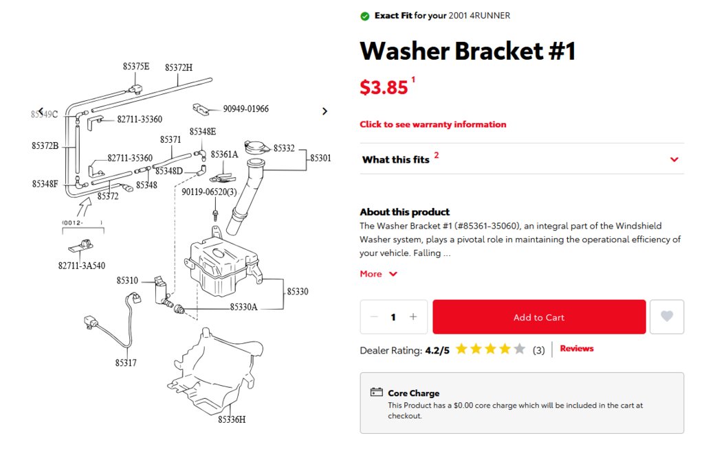

  15. Oct 28, 2024 at 7:24 AM
    #35
    mjhenks
    mjhenks Well-Known Member
    Feb 2, 2010
    #30553
    491
    So.Cal
    04 Jade Green TRD V6 DC
    @rocknbil. Did you find that filler neck support part? Wonder if that is a fourRunner thing as i did not see it in the Tacoma parts list.
    Follow-up. Part located from a 2001 era 4Runner.
    Part number 85361-35060. Called "Washer Bracket #1"
    Unclear if it fits Tacoma's but i know my 04 has the clip attachment square in the front radiator upper cross member.
    $3.85 from Toyota or $30 on Ebay.
    https://autoparts.beachcitiestoyota.com/products/product/bracket-washer-no-8536135060
