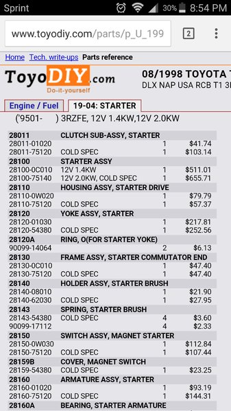

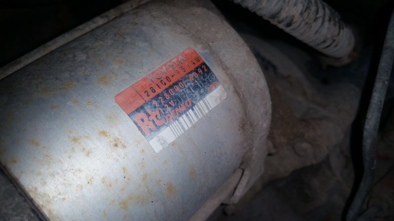

    I went to order new starter motor contacts and found that I couldn't without knowing if my truck was cold spec or not. The dealer couldn't even tell me! Google searches did nothing, so I am putting this out there for others to find.
    I discovered the following method for determining if your truck is cold spec:
    1. Read the part number on the side of your original starter. If your starter was replaced at some point, you are probably out of luck. This is mine, 28100-75140
    2. Head to toyodiy.com and punch in your VIN for part lookup
    3. In the part number catalog, go to engine/fuel - starter
    4. Compare the starter part numbers to your starter. Notice my starter is cold spec.
    I am now feeling safe in assuming my truck is cold spec. I went ahead and ordered the following part numbers for my starter repair:

    Apparently trucks sold in cold climates came with this package. Different washer tank, heavy duty starter, not sure what else.

    Both of the starters, "cold spec" or not, will fit.
    Just get the cold spec, wherever you live. Why? It has more cranking power. Why do they even sell a regular starter? :notsure:
