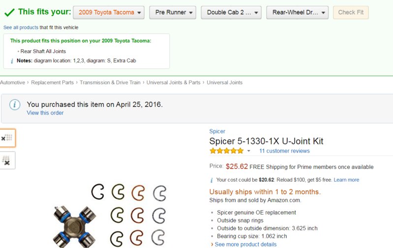

    Yup, installed on mine. It cured some vibes but I still need to mess around with the spacing to see if I can get one take off vibe out...lazy :anonymous:
    Not sure if the AC's are different than the DC, but I also had to use square tube to build spacers. The IEDLS CB is flipped with flat bar across the bottom and 1 1/4" long square tube spacers to drop it down so the DS doesn't rub on the support. I never tried it hanging down due to comments from others with issues they had that orientation. Also, don't forget if you do have to use the spacers you will need longer bolts.
    Edit: for additional reference these are the u-joints I used https://www.amazon.com/gp/product/B00DOI8BDS/ref=oh_aui_detailpage_o03_s00?ie=UTF8&psc=1

    Thank you!!! I just have a take off vibe and I think the AC and DCSB are the same as far as mounting the CB it's the DCLB that mounts up different.. are you SB or LB??
    EDIT::::Why does Amazon say these ujoints will not fit my truck??

    So link posted above are correct ujoints ?

    Should be unless there is something different between an 08 and 09
    Edit: I also just put in a 2008 Access Cab in my Amazon garage and it showed that it was a correct part
