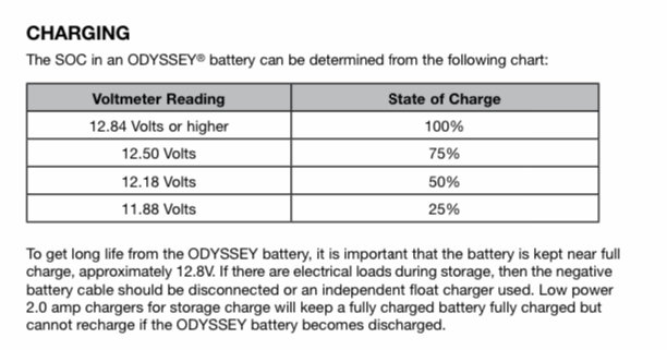

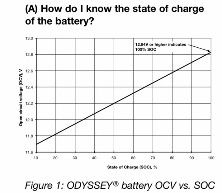

    I misread your post thinking Optima. I agree with using the specs recommended by the specific battery manufacturer. I note that the float voltage (such as maintained on a separate charger) a voltage of 13.5 to 13.8 is adequate. I wouldn’t be concerned therefore if my alternator produced 13.8 or higher, the capacity loss will not be that much of any. But if you want to increase your alternator voltage that’s ok too, just don’t think it’s going to give you much of an increase in capacity.
    Here’s a link to the Optima battery data sheet for those interested:
    https://sqlvawbi4pg46k2imi.blob.cor...rary/battery_user_guide.pdf?sfvrsn=2c363857_4
    And here’s a link to the Odessey battery spec sheet:
    https://www.odysseybattery.com/wp-content/uploads/sites/2/AM-ODY-OM.pdf
    Note that per the Odessey spec sheet at 12.84V your battery is fully charged:
    Therefore if you have this battery using your standard alternator (no boost) and when you turn the engine off the battery is at 12.84 V or higher then it’s fully charged and you really don’t need an alternator voltage boost to keep it fully charged. If it’s slightly less than you have slightly less than a full charge and the note regarding battery life applies if less than 12.8V. Up to you to boost or not but don’t expect a big capacity increase.
    Update: Seeing this post in the Northstar AGM thread, the issue with Tacomas typical alternator voltage allows for sulfation and the manufacturer recommends a higher alternator voltage. So I concur with sticking with whatever the battery manufacturer recommends. I did not see the same requirement for the Optima battery though it appears to have reliability/quality issues these days compared to earlier models per posts.
    https://www.tacomaworld.com/threads...e-booster-upgrade.604478/page-4#post-20407925
    Though I’ve read posts of Odessey failures, Northstar failures (one boosted) as well.

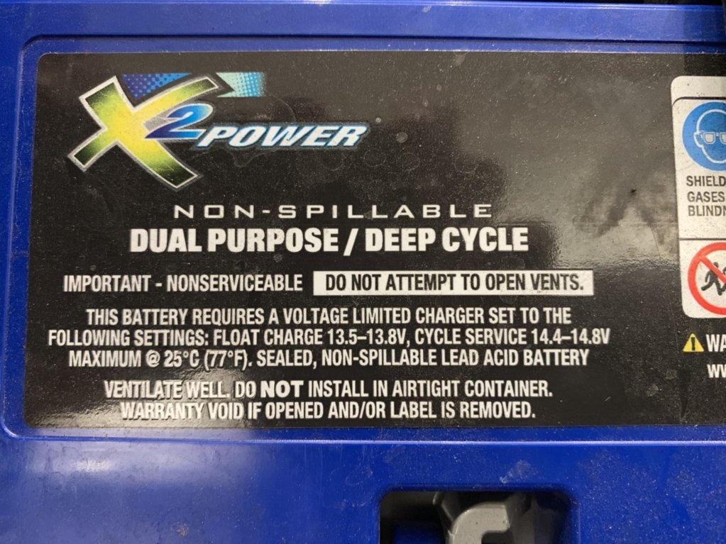

    This is very interesting information, thanks for sharing. Odyssey, Northstar, and X2Power batteries are all the same thing now, all manufactured by EnerSys so it should hold true across the lines. I'm going to call/email EnerSys when I have a bit more time just to confirm some things.
    That being said I'm copy/pasting my response in the other AGM megathread because I'm too lazy to re-type it all here:
    So for now ignore my previous statements about the 14.9 volts. I need to repair/replace some things and then confirm data before I can trust the numbers. Will share back what I find later.
