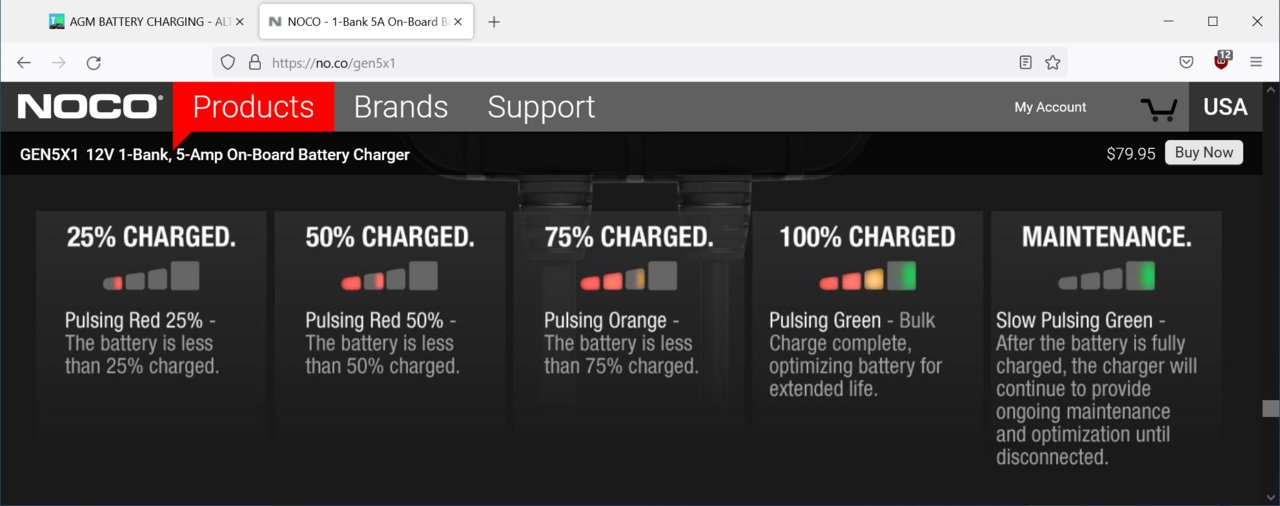

    I have an odyssey 34R AGM battery. being retired I can sometimes not drive the tacoma for weeks..
    In lieu of the diode mod I keep it plugged in to a NOCO 5 amp charger/maintainer when I am not using it which has switchable mode for AGM.
    Within a very short time (5 -10 minutes) it indicates 100% charge and then goes into maintenance mode for as much as 24 hrs. See screen shot below
    Considering how little I drive it would this solution be appropriate in this case vs the diode?

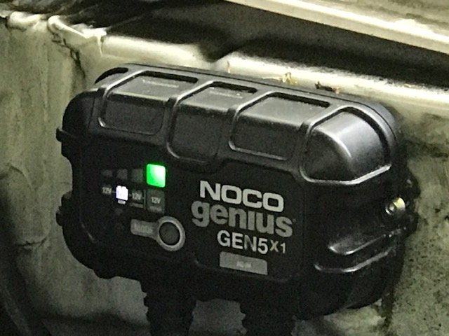

    Since I am retired and drive very little now (maybe 3000 miles a year and sometimes not for weeks) I have installed a NOCO 5 amp charger underhood set for AGM mode and leave it plugged in almost all the time my truck is parked.
    And its overkill but its the marine version so is water proof. I used stainless rivet nuts and stainless button head caps screws to mount.
