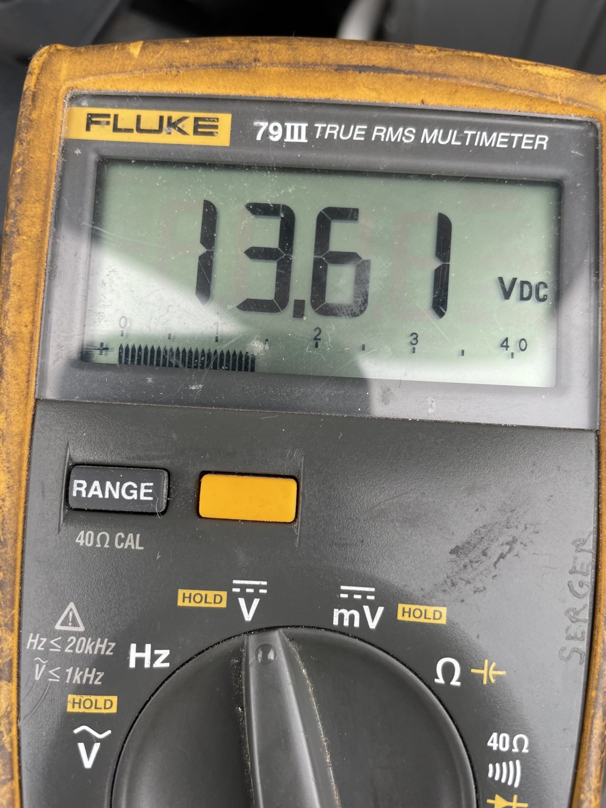

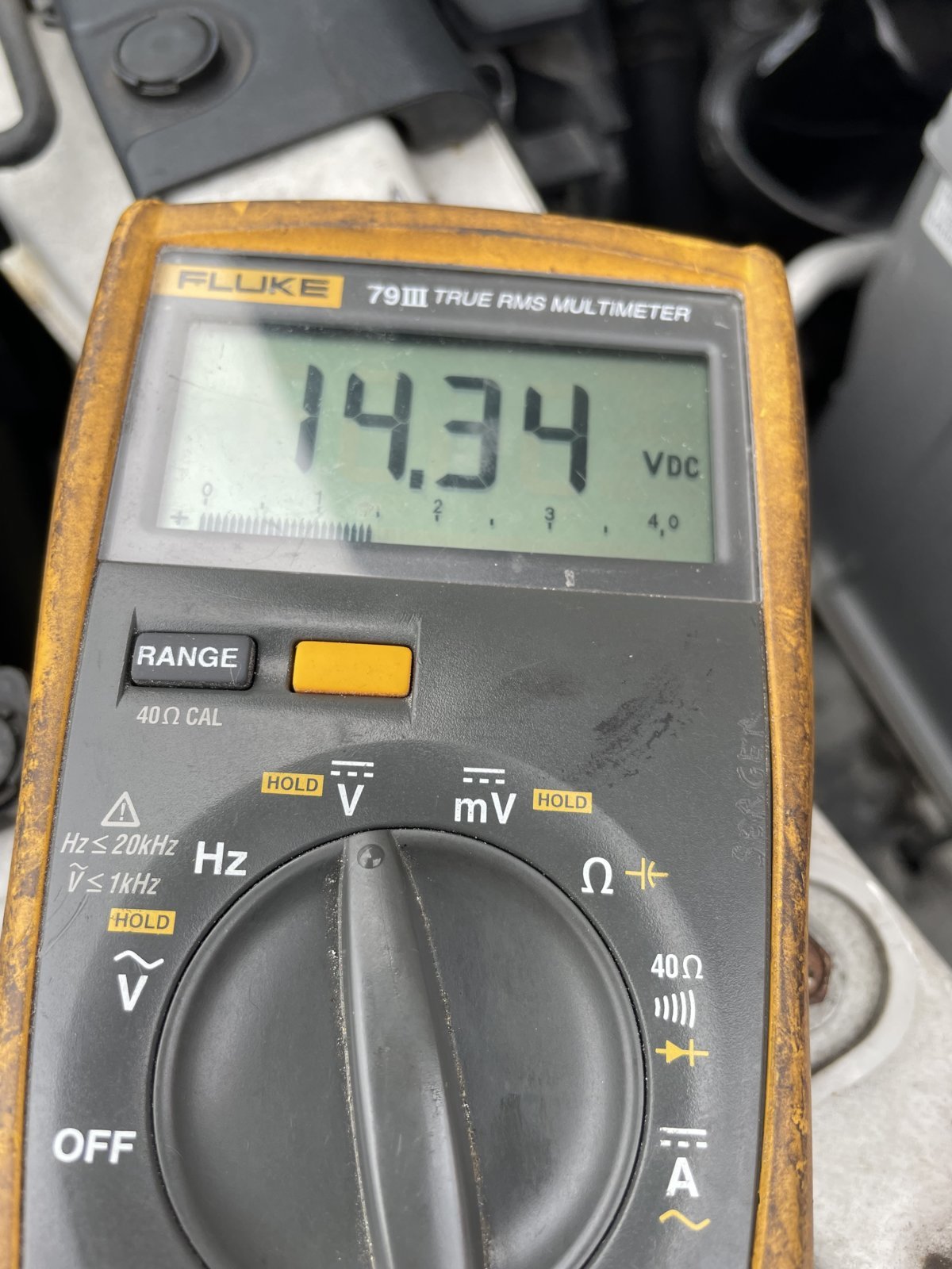

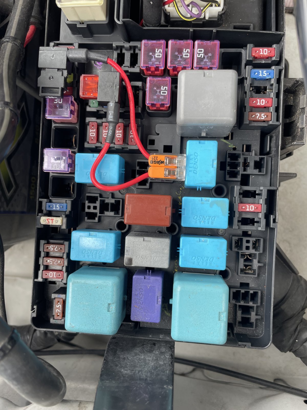

    I just finished this mod using the $4 Littelfuse 1A mini diode and 2 add a fuse adapters.
    The voltage bump went from 13.61 to 14.34.
    I noticed Torque Pro displays a lower voltage than my meter reads at the battery. 13.61 at the battery is 13.1 in Torque Pro and OBD Link. 14.34 at the battery reads 14.0 in Torque Pro/OBD Link. I tried using a different newer voltmeter and it was the same.
    I hope this keeps my second 6 year old X2 24F AGM battery going a few more years. The first X2 battery I bought was replaced under warranty after 3 years. I'm sure due to under charging.
