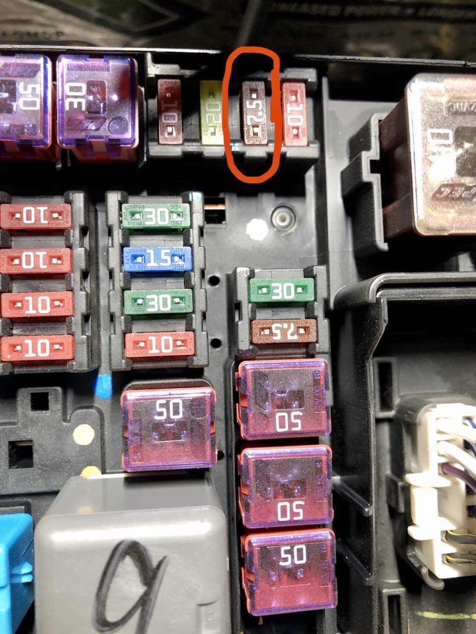

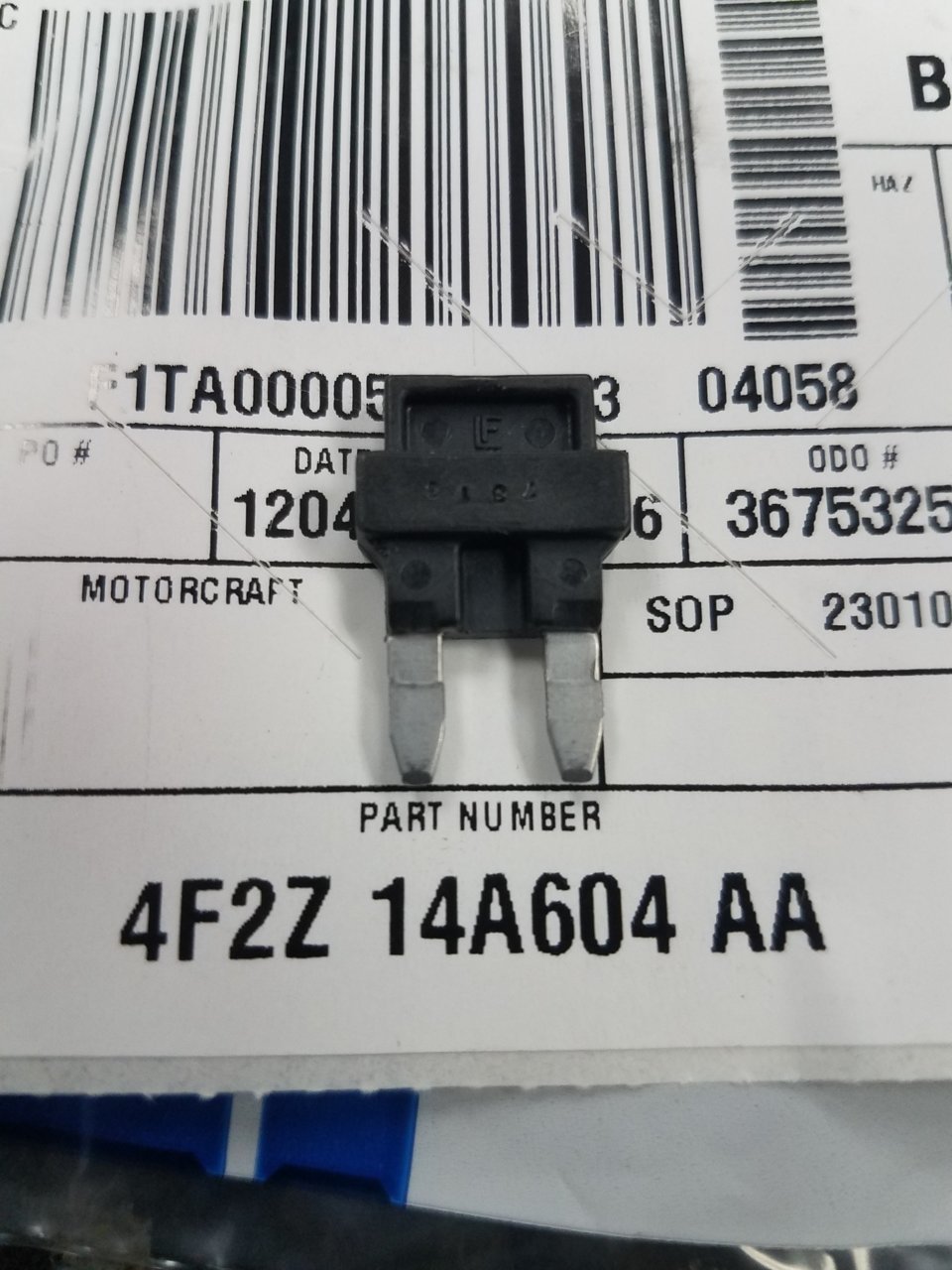

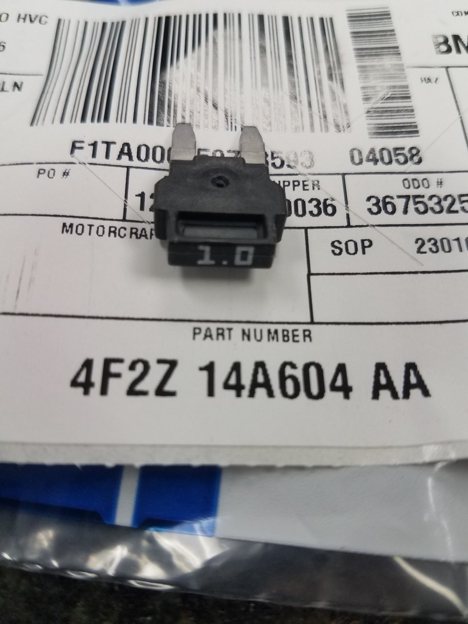

    I have to also add that Ford makes a 1 amp one way diode as well which is a 100% direct fit for our trucks for those looking for alternatives to GM and Littelfuse. I just got mine today. There is no need to trim anything on the housing to fit it in and it fits 05-14 Mustangs Econoline and various other vehicles.
    Just to add on to how easy this mod is, it dropped right in and imediately boosted me up to 14.7-14.8 volts at initial start. In Ford I trust. :laugh:

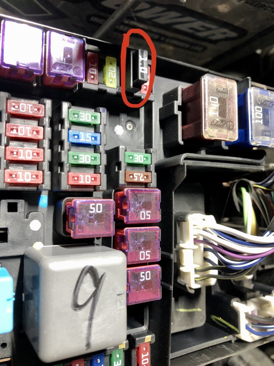

    It won't make it catch on fire. I disconnected nothing to do this. It was a simple remove 7.5 amp fuse, insert the new one in the direction shown in the photo. Start truck and go.
    I would only do this if you have an AGM battery or are towing because towing adds additional strain to the electronics.

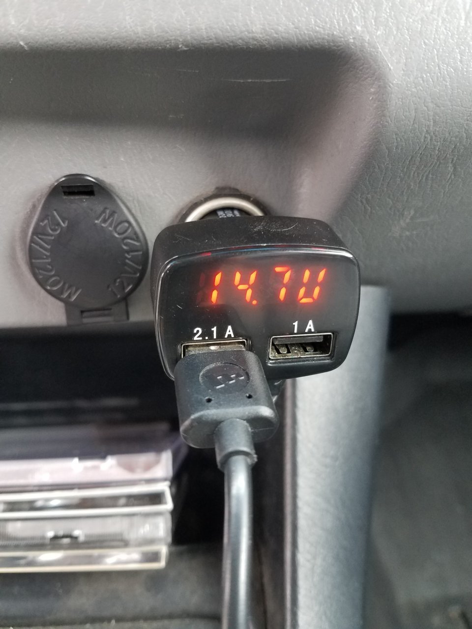

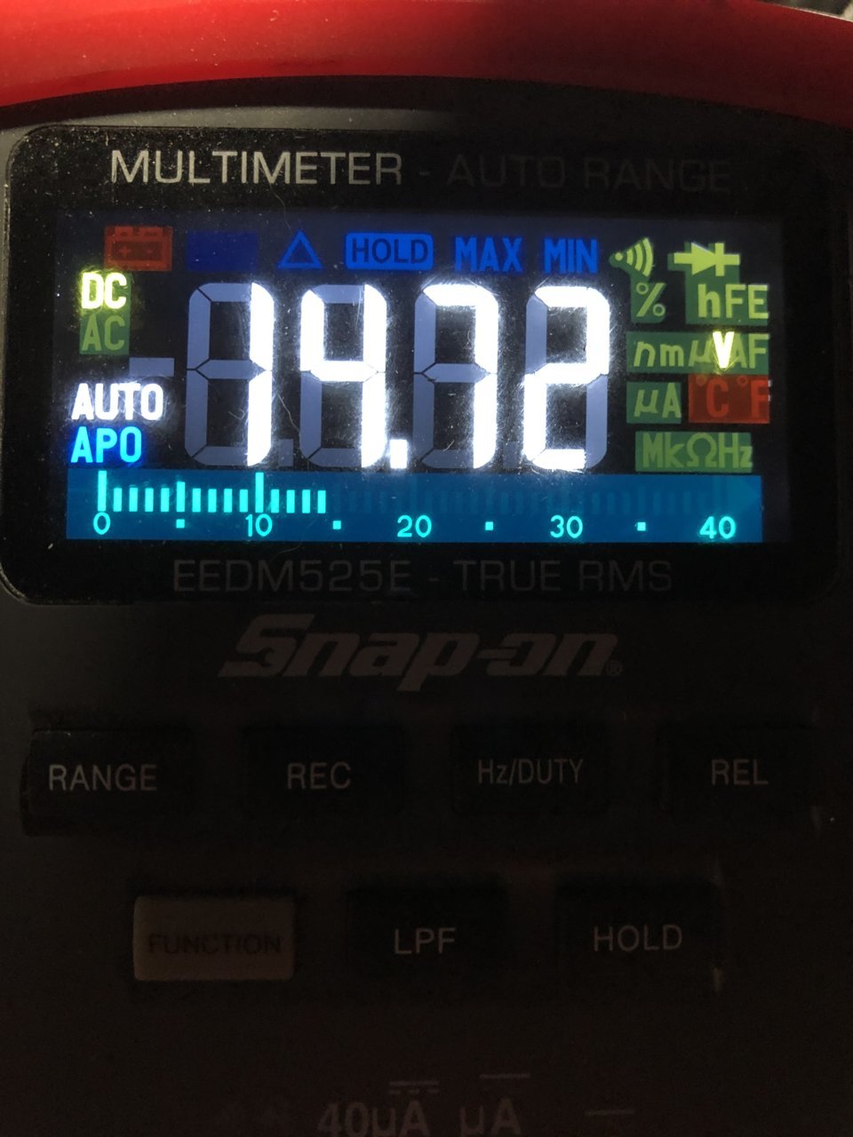

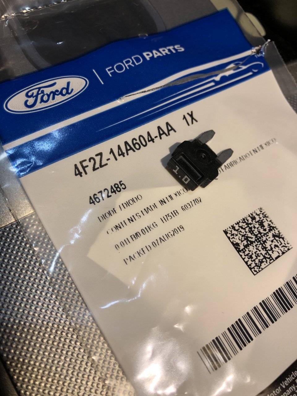

    I just did this same one today. I purchased the diode from my local Ford dealer for $13.xx, part number 4F2Z-14A604-AA. I have an X2 AGM battery. Took a few pictures along the way, nothing exciting though. I did notice that my headlights and fog lights seemed a touch brighter (H4 Philips Racing Visions and H11 GE Megalight Ultra) which is always a nice little tidbit. Though I don’t have a LUX meter to verify....some day I will get one. Time will tell if it helps out the battery, it certainly can’t hurt. Thank you very much guys!!
    Voltage @ idle before was 14.17
    After was about 14.72 is where it stabilized.

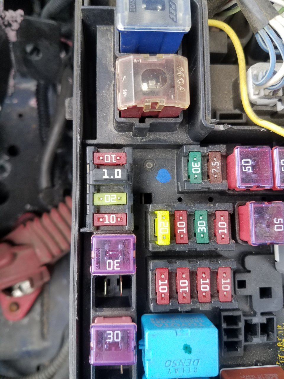

    Thanks to everyone who contributed to this thread! I knew the charge voltage was low, but had no idea I could fix it so easily! I did the littelfuse fix, and bought a spare. $8 for 2.

    I bought the Ford 1.0 diode. Some parts websites say “Fused Diode”, some don’t. It does say 1.0 printed on the part.
    Does anyone know for certain that it has a built in fuse component?
    I really don’t want to test it on a different circuit with more draw to learn in-person.
    But the question did come up in another thread and made me wonder if I’m risking a potential hazard if it’s actually not a combination fuse/diode.
