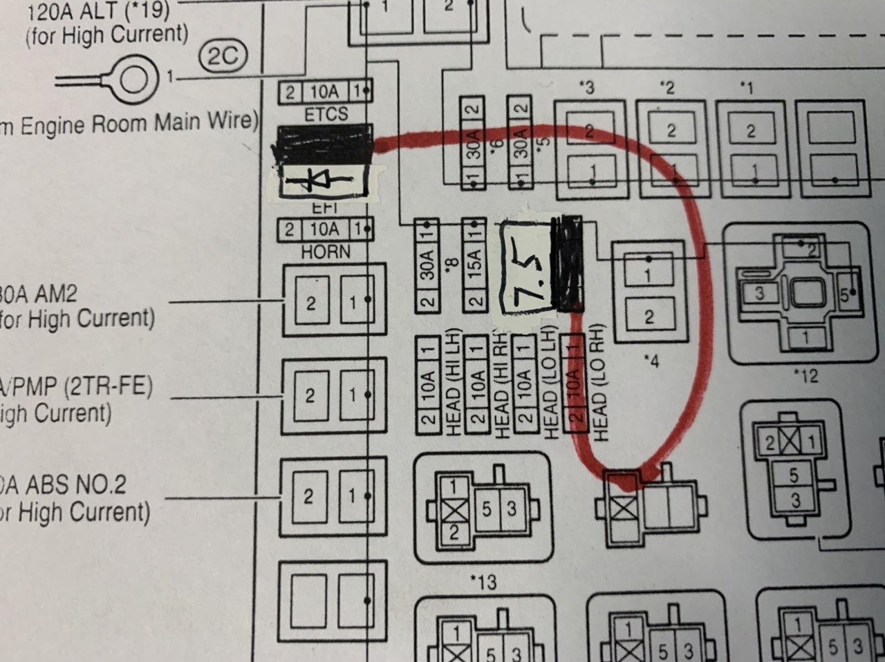

    I have looked at the pics of the Australian diode thing and I'm not convinced of the quality of the product. I have much more confidence in the diode supplied by GM and Ford and installed in millions of vehicles. I agree that in a perfect world, there should be a fuse in this circuit. In theory, the unprotected main battery cable that goes from the battery to the starter has a much higher risk of causing a fire.
    I considered that it would be really cool if you could reconnect the terminals in an add a fuse so the 2 fuse locations were wired in series, and then have the diode in 1 and a fuse in the other. It doesn't look like this is easily done or even possible.
    Another thought I had was to acquire another fuse box fuse terminal, use an unused fuse location for the diode and rewire the underside so the fuse and diode are wired in series. So far I have been unable to figure out the Toyota part number for a fuse pigtail.
    Just 30 minutes ago, I had another brainstorm. Take 2 add a fuses and connect the wire from each of them together. Put 1 add a fuse in the alt-s position with the 7.5A fuse in it. Put the other add a fuse in an unused fuse slot that has 1 constant 12V terminal, and then put the diode in that add a fuse. The result would be a diode and fuse wired in series, for minimal cost, and the only effort being soldering 2 wires together.

    Here’s a crude drawing of what I’m talking about. I decided to put the fuse in the previously unused fusebox slot because that’s where the voltage originates. If this is done this way, the lower slots in the add a fuses should be filled with epoxy or silicone sealer, since they’re not used.
    Edit: I just noticed that there's a 10A fuse in the pic in post 21 above. That slot is unused on my '06. You could still use that slot and just put the 10A fuse in the lower add a fuse slot.

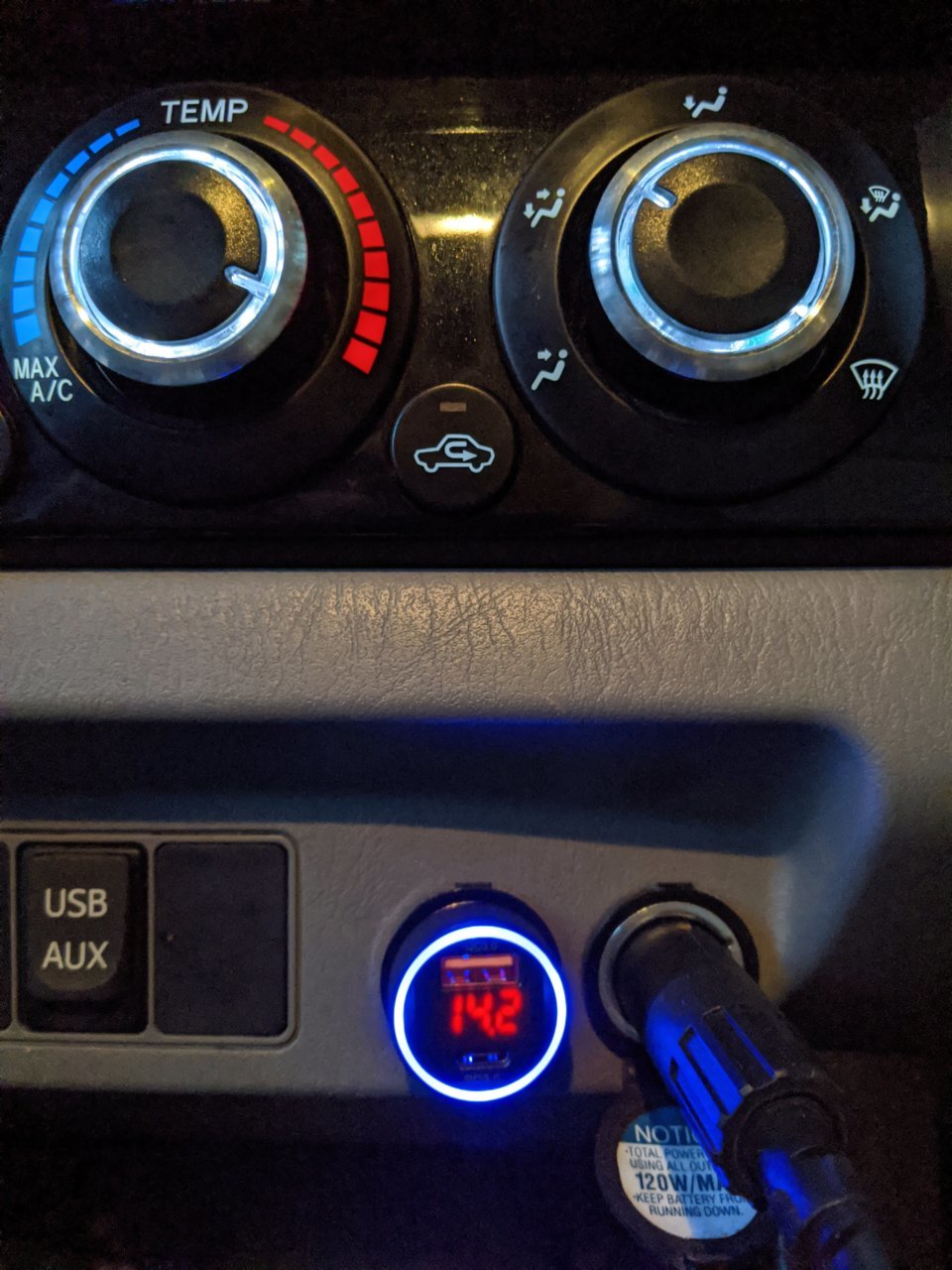

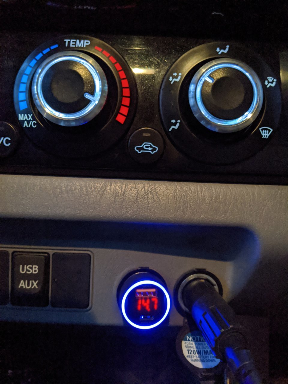

    Is it normal for it to drop from 14.7 to 14.1 after driving 10+ miles?
