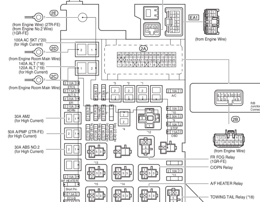

    That seems odd. In this 2006 schematic, you can see that fuse slot feeds from very close to the Alt-s fuse, and then goes on to feed other things. I can’t see how they could make that circuit so it has low voltage and still makes other things work.

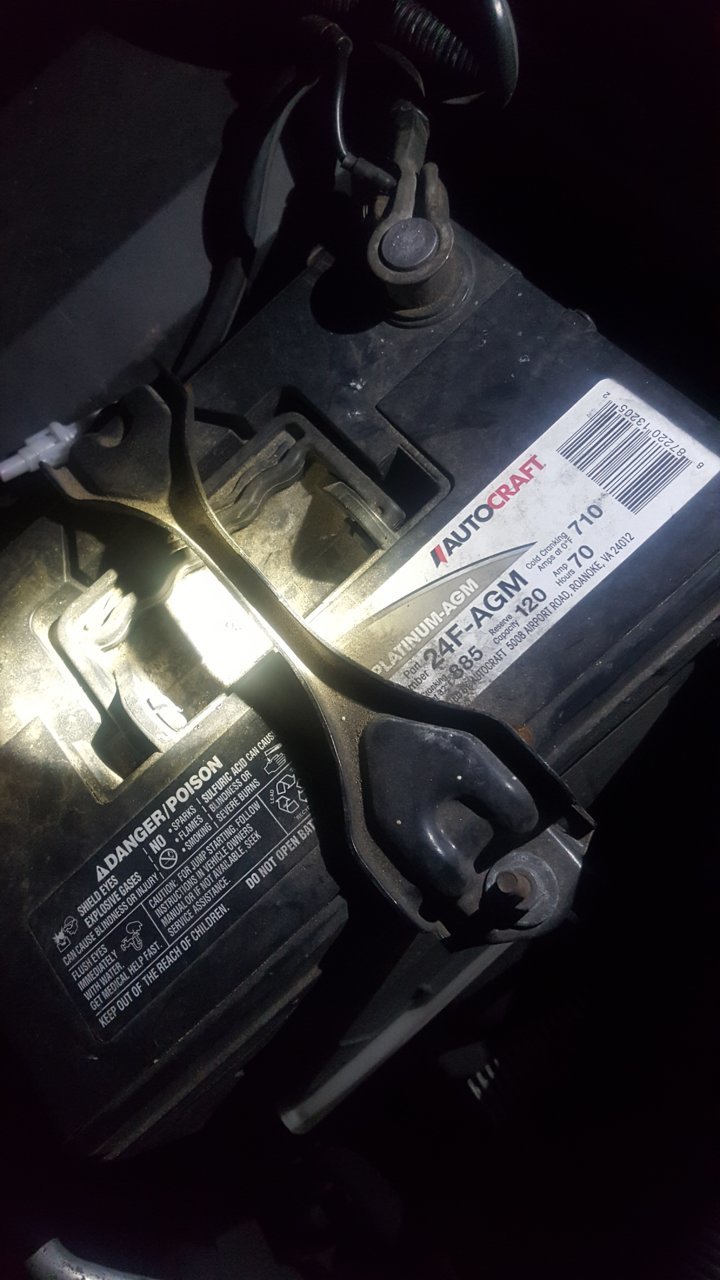

    I can't find a "charging voltage" spec for my battery. It is an agm battery, just a somewhat generic autocraft one I got from carquest. Is the increased charging voltage common to ALL AGM batteries or only certain ones? I've been using this one with no voltage mods for a while but if there is benefit then I'd like to do the voltage mod.

    http://www.carquestprofessionals.com/batteries/maintenance.html#chart_charging
    IMPORTANT! Always use an automatic temperature-sensing, voltage-regulated charger! Set charger at 13.8 - 14.1 volts @ 68 f for GEL, or 14.4 - 14.6 volts @ 68 f for AGM. Do not exceed 14.1 volts for GEL or 14.6 volts for AGM
    So your answer is 14.4-14.6 volts, maybe set to the +0.4 on the booster, since mine with them set to +0.6 volts sets the output to about 14.7-14.8 volts
    vwbuggsy[QUOTED] likes this.

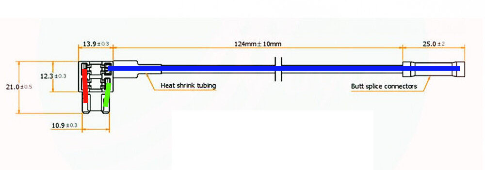

    We're only using the add a fuse terminals that are on the opposite side of the black plastic from the red wire. (blue brackets in pic) We're not using the add a fuses the way they're designed to be used. If you're using a fuse box slot for 12V that is already used, put that fuse in the lower slot of the add a fuse to maintain original functionality of that circuit.
    +12V{fuse}---------------------{diode}------------Alternator.
    vwbuggsy likes this.

    @vwbuggsy, keep in mind the orientation and connections of those Add-A-Fuses.
    The red side is bussed, the green connects the fuse back in and the blue is the new tap.
    @Muddinfun is using the top slots of both Add-A-Fuses and the slot he's picked has +12V available on the top but is unused otherwise. It's pretty friggin' clever.
    Revelations, vwbuggsy and Muddinfun like this.

    N-fab steps, Wet Okole Covers, line-x, tint, vent shades, budget stereo upgrades, weathertech floor liners
    Ahhhhhh, okay now I completely get it and yeah that's brilliant! Very elegant solution. Thanks folks.

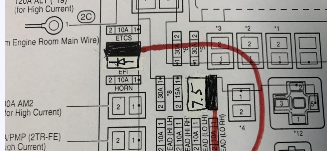

    Did you ever figure this out. I think you can do something like this but you need to plug the 2nd fuse tap into the first (only reversed).
