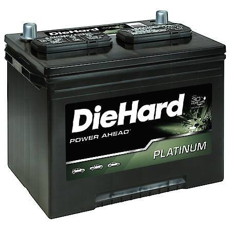

  15. Dec 1, 2021 at 10:08 AM
    #75
    CusterFan
    CusterFan [OP] Well-Known Member
    Sep 18, 2015
    #164581
    8,936
    Southeastern Illinois
    Silver Sky 2019 Tacoma SR, AC, 4X2, 2.7

    I actually just had the Diehard Platinum 24F with the 4 year warranty installed in my truck.
    Passed on the AGM battery. Got a $10 mail in rebate coming too. ;)
