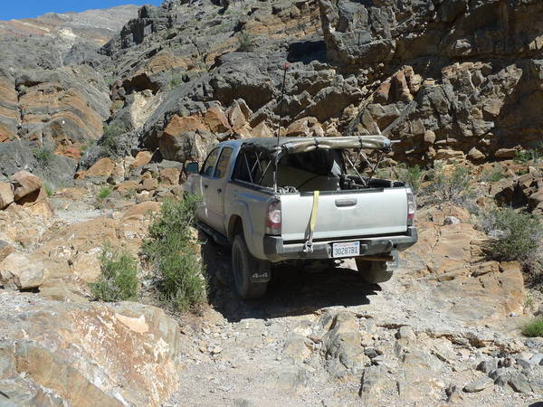

    Thought I'd start listing the stuff I've done, before I forget:
    Suspension
    Front
    Extended Icon 2.5 adjustable coilovers with 700# Icon springs
    Wheeler's bump stops
    Light Racing Upper control arms
    Rear
    Dakar leaf springs
    2.5 Kings with Res
    U-bolt flip
    Armor
    Brute Force Rear Bumper

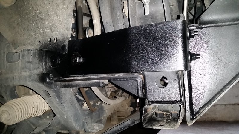

    Pelfreybilt IFS and Mid skids
    BAMF Sliders, Rear diff skid and LCA skids
    Pelfreybilt front bumper
    MISC
    285/75 16R Mickey Thompson Baja MTZ
    16x8 SCS wheels 4.5 bs
    Softopper
    high lift Jack
    ARB Twin Compressor
    Oil catch can

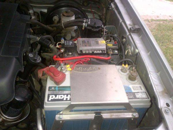

    Blue sea fuse box with 100amp fuse and relay
    20" double LED light bar
    Rigid Duallys
    2 KC 6in Daylighter spots
    31M battery in Pelfreybilt cage
    and other stuff

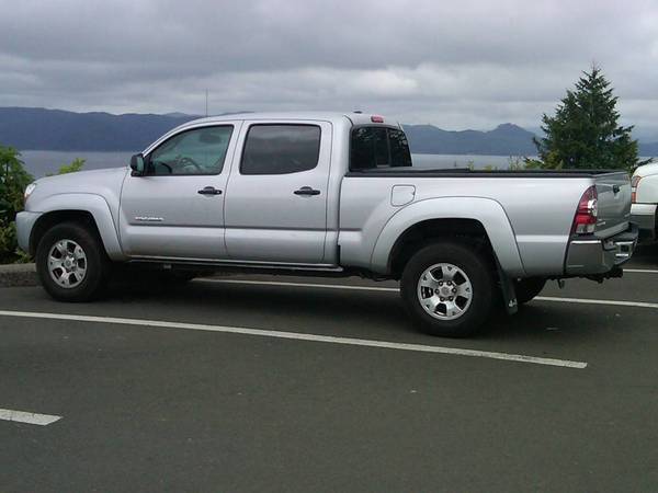

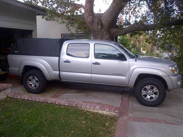

    So I got a '11 DCLB (needed more room to haul outing gear) 4x4 no pkg, figured I would do the mods I wanted this time:
    Basic Truck
    How it sits now-It has about a 2.75" lift in front and just over 3" in the back

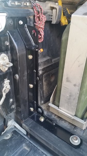

    Added 2 D rings into the back corners.

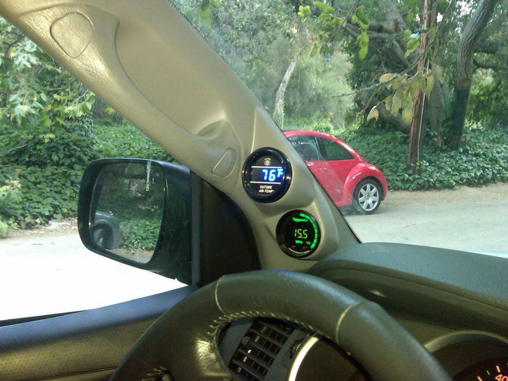

    Added guage pods and a temp guage. (I found out about TW when trying to fix my temp guage on the '05, didnt get one on the '11) also was looking at scan guage and ultra, didnt like the design but found the Ecometer for about 70 bucks. (edit- this can be a hazard with side curtain air bags, there is a risk of them flying out-at you!)
    I like the way it looks:
    http://www.digital-auto-gauges.com/products/Auto-Thermometer-Gauge-for-Trucks-and-Cars.html
    http://www.summitracing.com/parts/ATM-9100/
    http://www.gaugepods.com/toyota.html

    Finally got them on. Did the work myself, following Chris 4X4s thread, not too bad, moving the sway bar out of the way was the key.

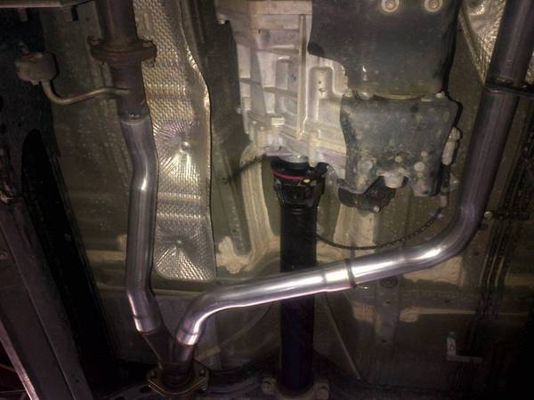

    rerouted the exhaust

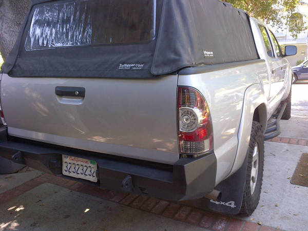

    Brute Force rear bumper

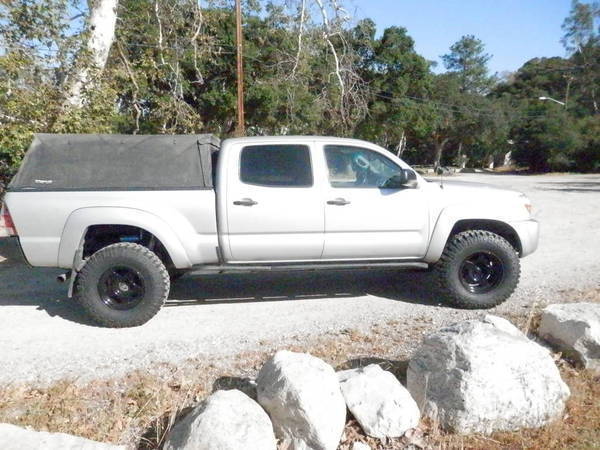

    Blacked out the wheels

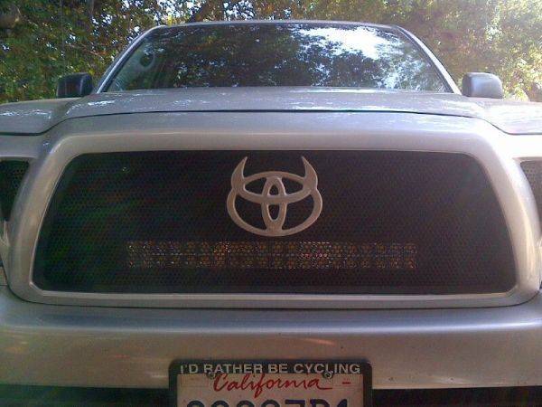

    Got my Homer grill and 20" light bar and BAMF grill mount

    redline struts, Oil catch can, 100 amp switched fuse box 31m battery and holder

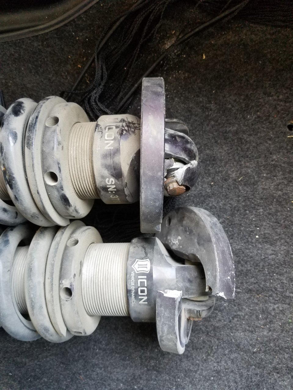

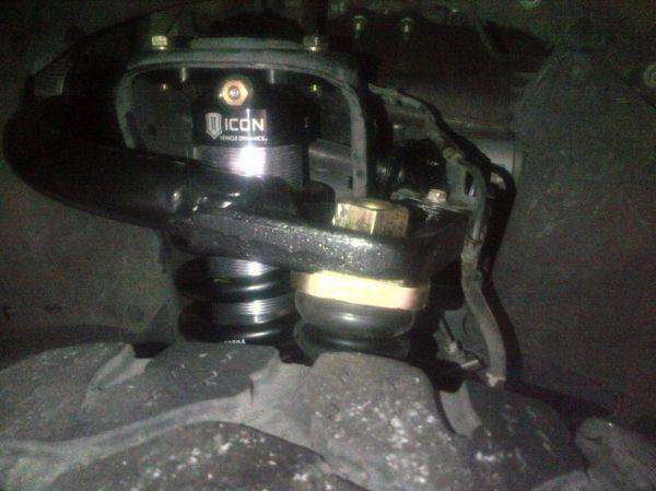

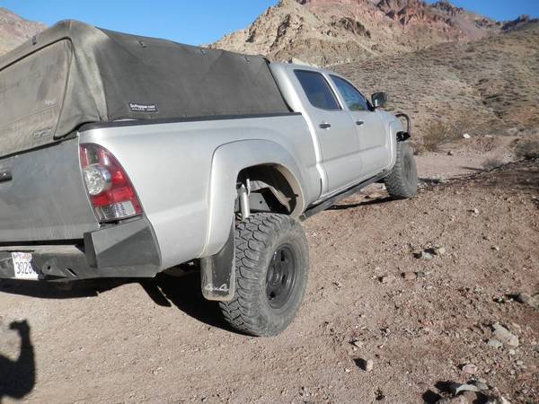

    Well, 3.5 years and 77K later, the TSB springs are frowning, and I have pushed the Billies to the max, Time for the next stage.

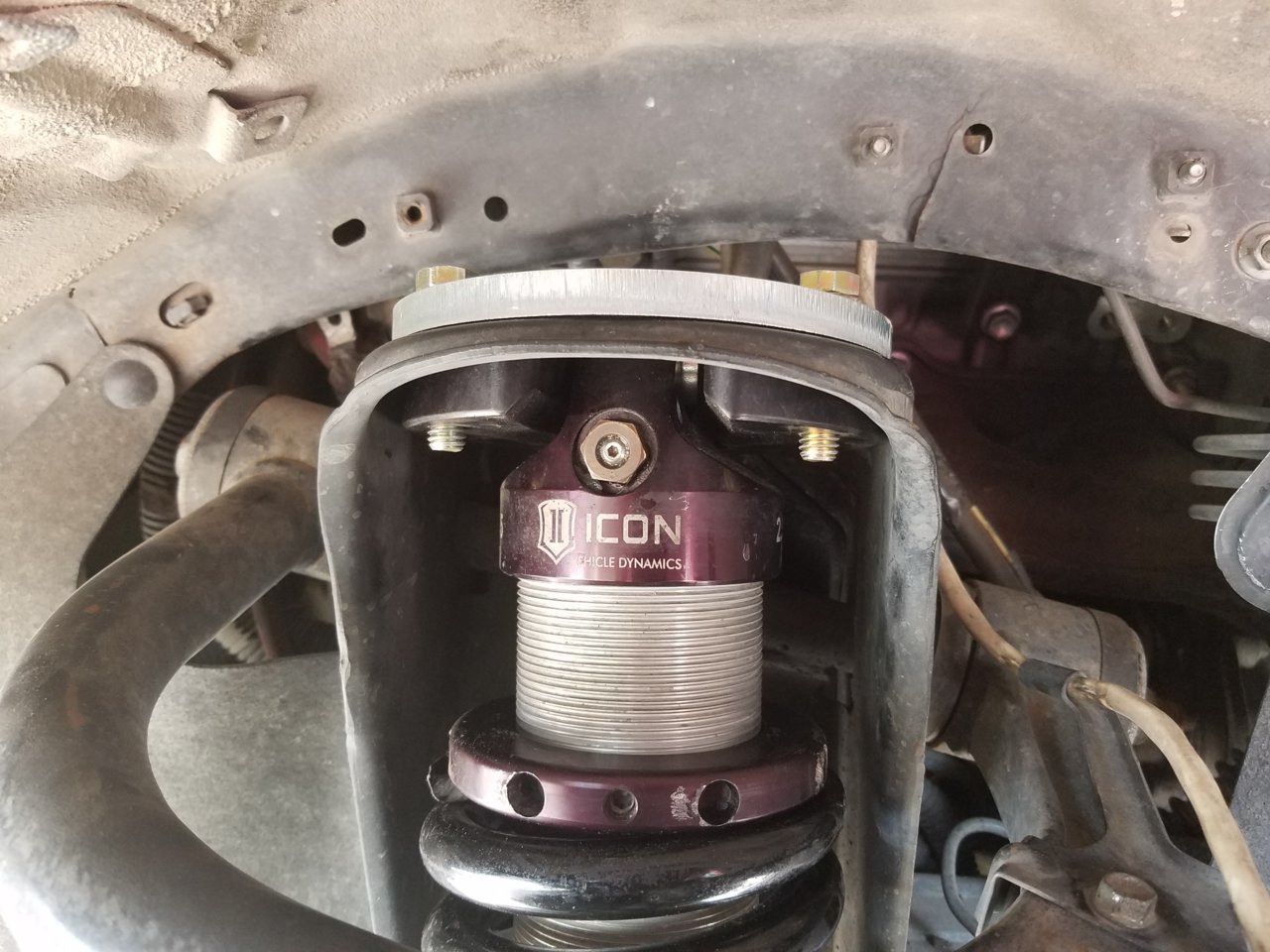

    Installed LR UCAs and Extended 2.5 Icons
    Dakars, Wheelers bumps, Ubolt flip and 2.5 Kings w/res
    Installed Firestick on back corner using BAMF mount
    Installed M31 batttery in Pelfeybilt cage

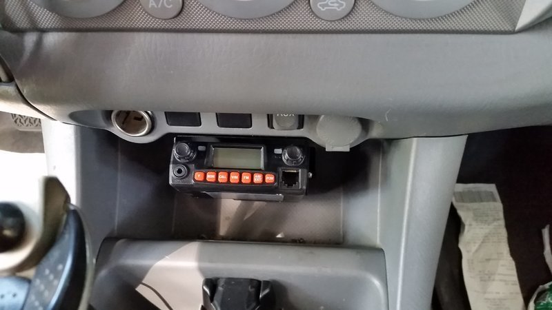

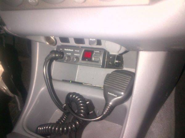

    replaced the 20 year old radio shack CB, turns out it was causing feedback-age or not shielded enough

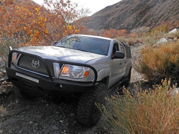

    12/14-Got my Pelfreybilt bumper:

    Got a link for the gauges?? i like em!

    where did u get your guage pod?

    It can be fine tuned, I got it within .3 mpg and stopped messing with it. So for me yes, it is always the same, never varies from that .3.
    plastic texture was a little off from my '11 but not enough that anyone will notice

    how hard was it to mount? How did you wire the ecometer?

    The pillar is very easy to remove and the ecometer plugs into the ODBC II plug under the dash- really easy. the temp gauge required an add a fuse and running the probe to an outside location, the whole thing took me about an hour (including the beer run).

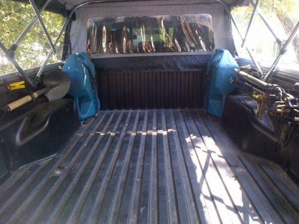

    How are you mounting your Jerry cans?

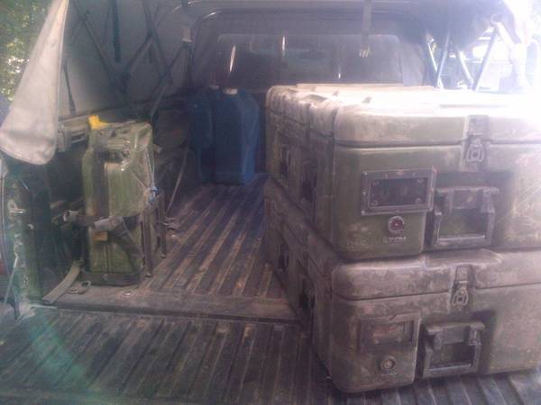

    For now the cage I bought is screwed into the bed with big washers on the underside. [​IMG] did 20 miles of washboard and they didn't come loose.
    If you are talking about the blue water jugs, I use the large quick fist. 4 screws hold down the bottom and the upper is mounted on the rail

    Curious as to where one might obtain these Jerry can cages.
    I have two I need to mount.
