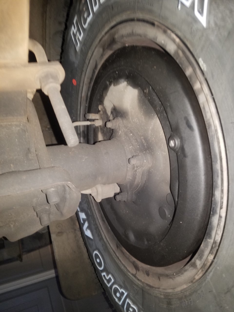

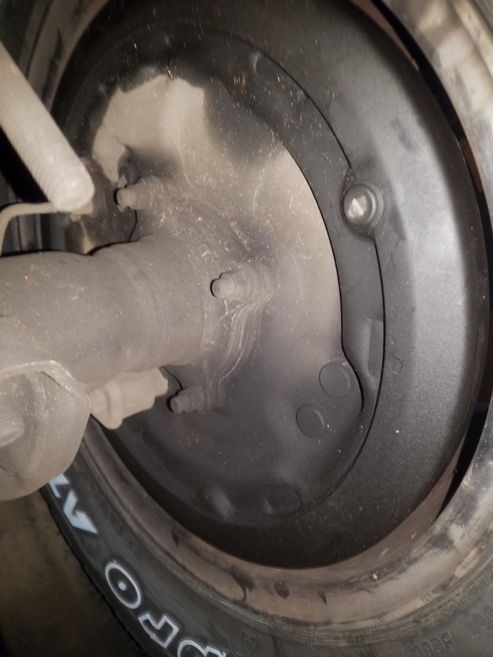

    So I doing some needed work to my truck and when I was under it today I see this.
    The oil is on the outside of the back of the rear axel.
    I guess I will open up the drum area tomorrow to look.
    Any ideas?
    Rear axle seal?
    Or brake related part.
    I’ve never had a rear seal go out before
  14. Nov 5, 2018 at 8:30 PM
    #34
    Timmah!
    Timmah! Well-Known Member
    Feb 25, 2016
    #179385
    1,224
    TIM
    Jack up the rear end, take off the tire, remove the drum and take a look. There's a huge difference between gear oil and brake fluid so you will know what exactly is leaking.

  15. Nov 5, 2018 at 8:37 PM
    #35
    btu44
    btu44 [OP] Well-Known Member
    Sep 7, 2016
    #196732
    331
    Long Beach area, Ca
    04 Tacoma Double Cab, 4WD, TRD Off-Road
    SC with 7th injector. ICON 2.5 shocks and coil overs, SPC UCA, EMU Dakar rear springs. FrontRunner bed rack. ICOM IC7100 amateur transceiver
    See if your loosing brake fluid. Wipe the wet area of your backing plate with a paper towel and take a wiff. Brake fluid and gear oil have very distinct odors.
    1997tacomav6 likes this.
