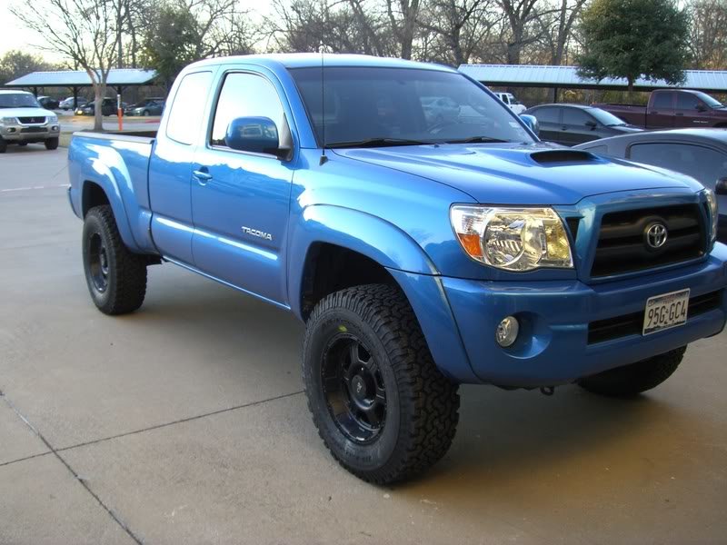

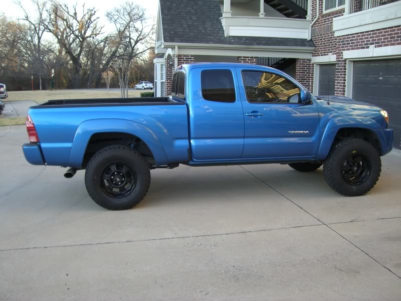

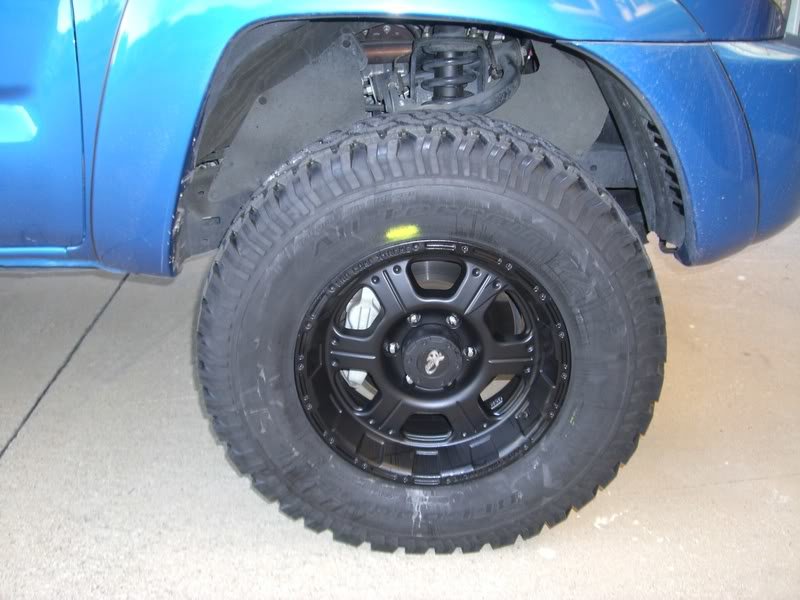

    Been searching and searching the forum but I need an answer. I have 5100's set at 2.5 and the TSB. 38" at the fender but I can not decide on 265/70/17 or 285/70/17... Will the 285's fit?

    285s will fit. You may have some slight rubbing on the inner fender, so you'll have to trim some of that.
    If you're running stock wheels, you'll need spacers so your wheels don't rub the UCA.
    265s will fit no problem.

    Getting 17X8's or 17X9's what ever is needed... No problem with trimming
