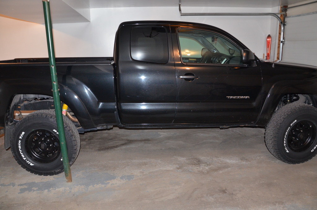

    I got that exact same set up and took off the front mudflaps and trimmed a bit in the front. Have not hit a trail yet but I imagine I may need to trim a bit more. Hope that helps.
    You can kind of see what I trimmed in this picture.

    Thanks. That lift in the back looks larger than the Dakar springs would provide. What's up.

    That picture was taken right after the lift was put on and after measuring it was a full three inches higher. I have been told that they will settle. When the summer hits here I plan on having a rack in the back for a kayak/paddle board so a little more weight will be added.

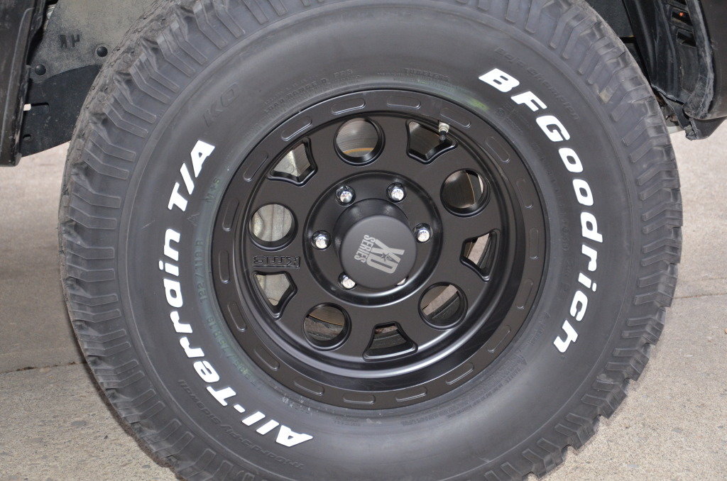

    I have 285/75/16 BFG's on the stock TRD rims. The only thing I had to do is all 1.25 spacers and remove the front little mud flap that is held on with 2 10mm bolts. So far I have not had to cut any plastic (so far).
