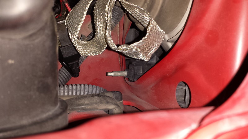

  14. Jan 4, 2017 at 11:41 AM
    cruisedon66
    cruisedon66 Well-Known Member
    May 9, 2016
    #186469
    672
    Pete
    Near St. Louis
    2003 Tacoma Extra Cab 2WD A/T
    Defrost mirrors, compass/temp display rear view mirror, rear wiper on camper shell, trans.cooler.
    Post #5 is the same as my 2003 Tacoma too. Great tip..Thanks!

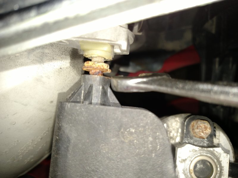

  15. Jan 4, 2017 at 5:56 PM
    wamego
    wamego Well-Known Member
    Sep 20, 2015
    #164737
    192
    2002 Tacoma 2x4 TRD SR5
    I just put in some led's and then used the 4 mm screw down in the corner. That's how I got them down.20170104_194112.jpg
