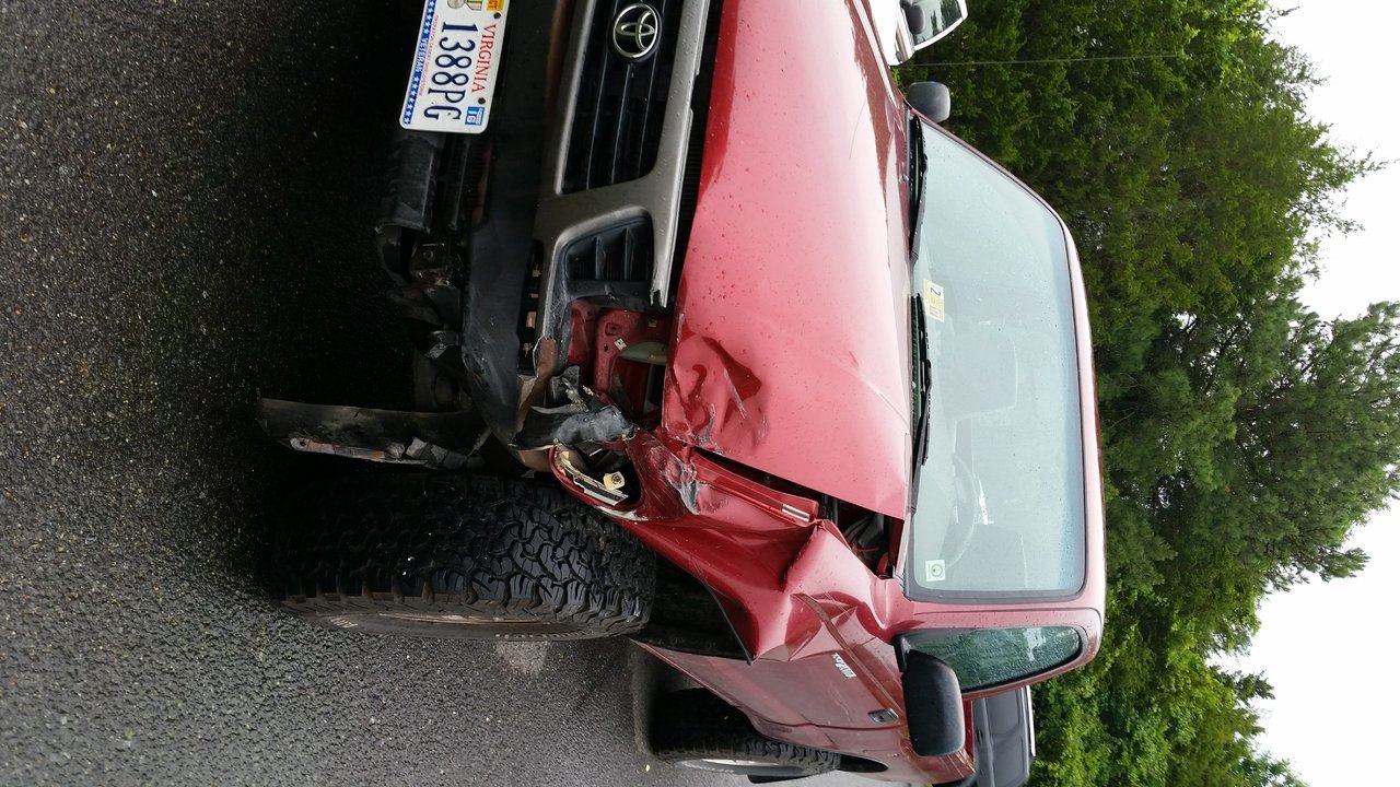

    Last year a girl, in a Tahoe, pull out in front of me. T-Boned her at the left rear. The air bag never deployed.
    The mechanic stripped the whole front end and used parts from another 96. He ground down any rust a painted EVERYTHING, including the undercarriage.
    When I picked it up he informed me that the air bag was going in and out, which it did. Two months later it now comes on when you start the truck and stays on for 5-10 minutes. You turn the truck off, turn the ignition to ACC (or on) the light will not come on at all. If I wait about twenty minutes, I get to start the process all over.
    The local dealer said one of my problems was the ECU. I swapped it out with the one from the spare 96. I didn't work. Also purchased an INNOVA 3100J. They assured me that it could read/test the SRS. It didn't. They are "investigating".
    Any help would be greatly appreciated, guys and gals. Including a good mechanic in Manassas or Fredericksburg, VA.Tacoma After Accident.jpg

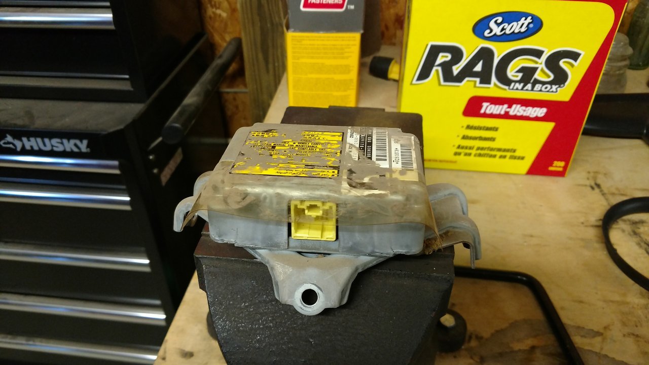

    The airbag sensor assembly.

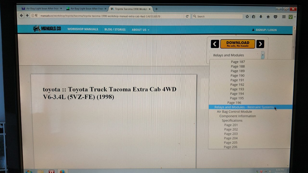

    Not sure how far you have gotten so I will start at zero, just in case. Also the info is based on my truck and the copy of the "Toyota Truck Tacoma Extra Cab 4WDV6-3.4L (5VZ-FE) (1998)" service manual from online. The same link I sent before.
    Hope the link I copied sends you straight to the SRS section. If it doesn't tehn click on the "WORKSHOP MANUALS" tab and work your to it.
    http://manuals.co/workshop/toyota/t...op-manual-extra-cab-4wd-3.4l/5530579/242#pff2

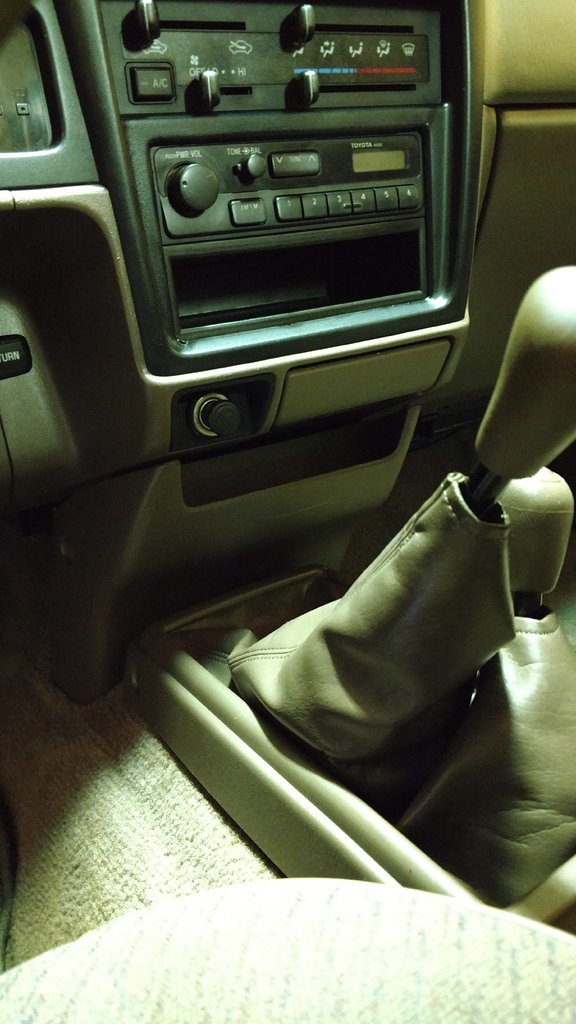

    The airbag sensor assembly is behind the bottom section of the center console, below the cigarette lighter and ash tray. Right in front of the gear stick.
    This is what you should be looking for.
    When going through the online manual, this is what you should be looking for. Start at page 201 and go through the trouble shooting. The bottom line is that the airbag sensor assembly (again referencing my truck) is the controler and sensors.
