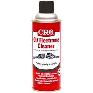

    As i've started my last few threads, I went though some headlight deep water the other day which resulted in water entering the cab. I stripped the entire cab down to the metal, disconnected the battery, pulled apart every connection i could find that was knee height and down, cleaned it out with connection cleaner http://ecx.images-amazon.com/images/I/41Y5lTaQJfL._SL500_AA300_.jpg and dielectric greased it.

    Thanks for the reply! I did unplug 3 yellow plugs from a yellow box clustered behind the ash tray under the stereo. There was some dirt on the floorboard sides of the connections. Sprayed it out with the aforementioned cleaner and dielectric greased them. But the airbag light is still on. Perhaps the box is fried? I'm hoping the light just means that I have no airbag for the time being?
