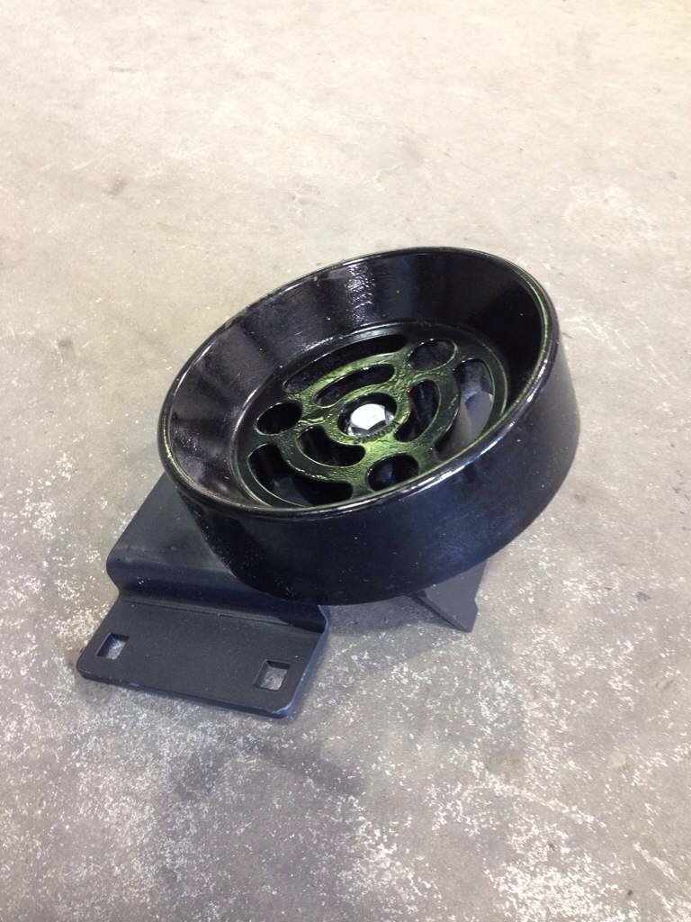

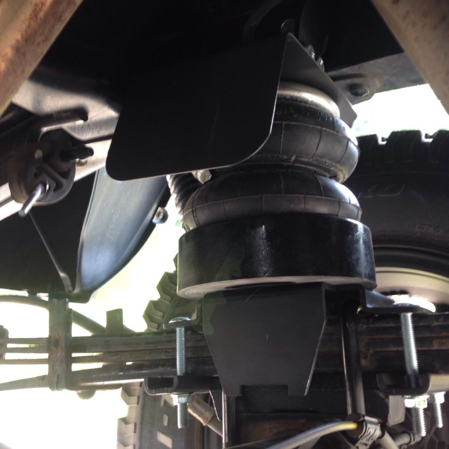

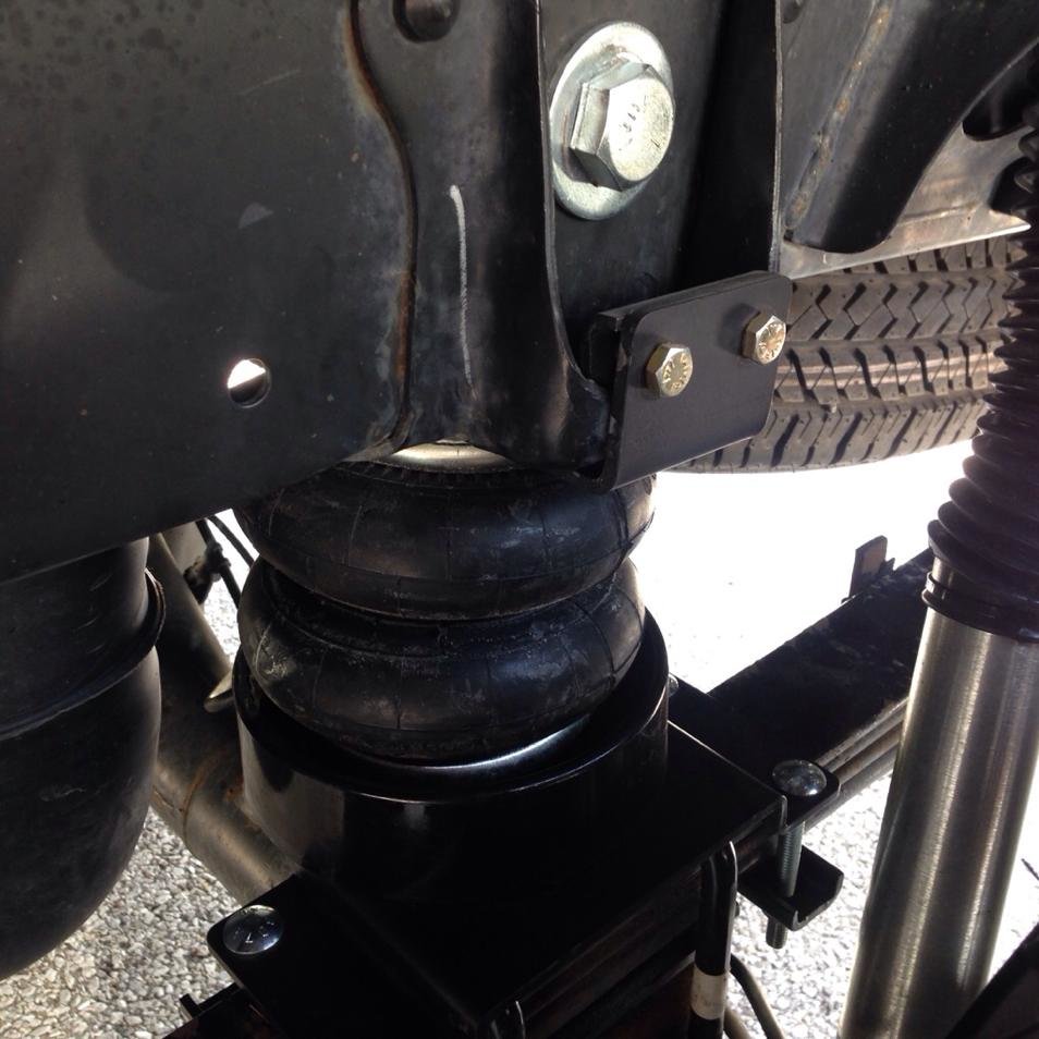

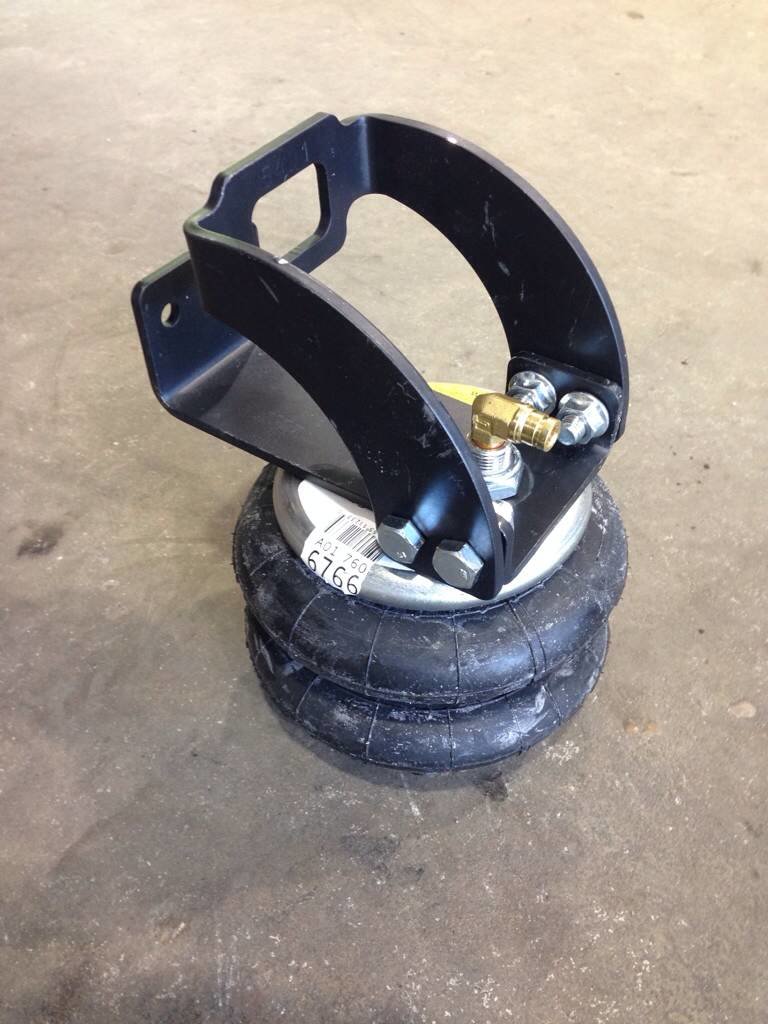

    Well a while back I purchased a set of Air Lift air bags. Long story short, I didn't like them. Seemed to be good quality but I didn't like the way they installed on the truck. So they went back and I went with the Firestones and Daystar cradles. Man I couldn't be happier with this set up! Probably my favorite up grade to date. I tow and haul frequently, if you do then these are a must have. Right after install I took the company fork lift and threw a skid of antifreeze in the back that goes right at 1k lbs, with 30 lbs in the bags the truck didn't squat enough to even tell! My boat and utility trailer are fairly light tongue weight. You can't even tell they are hooked up now. My truck always has close to 400lbs tools and etc in the bed as well. I drove it home with 25lbs of air in the bags. Gave me close to another 1" of lift and took a lot of body roll out of the truck. Made for a firm yet good ride. The Daystar's are great if I am off road no worries with these. I know there is a good bit of info on here about these already but I wanted to let you guys know that I am another happy customer!

    Thanks man! There is no doubt you would like them. Just regular driving or hauling/towing it makes mine really feel like a truck.

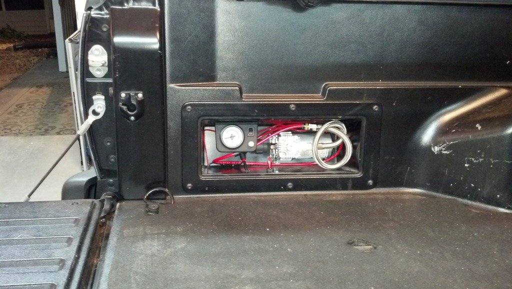

    I've had my Firestone Ride-Rites installed for about 3 yrs now. They have served me very well. :thumbsup:

    Thanks man! That's awesome how you done your compressor! I may do one in the future. I thought it would be nice to have the 2 individual gauges in cab.

    Yes I completely understand what they are and how they function. Are you familiar with how the Daystar cradles work? The bags do no connect to the leaf springs they float freely in the cradle. When the suspension down travels they simply lift out. If off road you would probably run them with the minimum of 5psi. When the suspension up travels they will compress easily. I was messing around and flexing the truck a bit, I don't see how with the location and how they mount that it could do any damage. I'm not rock crawling, what off roading I do is for hunting/fishing that type of thing. Thanks for the insight though.

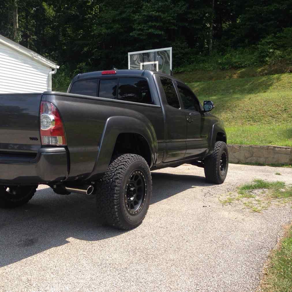

    Yes 2.5" in front, 1" in rear plus about 1" from bags.
    This pic was before bags but you can see how the front sets.
