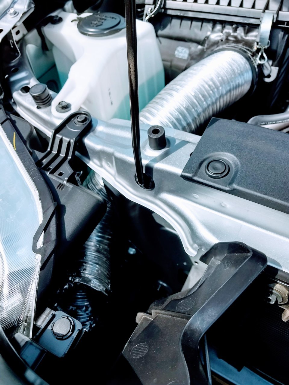

    Got the air box mod done

    A lot less lag

    Any diy instruction? Items used. I like this one. Thank you.

    I drilled 3 inch hole in the front of the air box, epoxied a 3 inch to 4 inch pvc fitting,insert 4 inch dryer duct hose in the pvc, route hose to front.About 20 bucks in supplies.l am still using the stock air filter.Hope this helps your baby like it did minr

    I am still getting air from under the fender,so 2 intake points

    Oops I meant to say Hi heat silicone, Thanks

    Seems sketchy, a little too easy to get water in

    Any temp changes you have monitored? The OEM setup cools pretty good.

    It is all about more air,no temp difference.Not much worry about water here in sunny southern California

    It won't do anything.

    I think that it should help low end throttle response and high end HP, as most CAI's do. At a fraction of the cost. I agree with the water intake concern though. I did similar with a Nissan Frontier I had years back and it for sure made a difference
