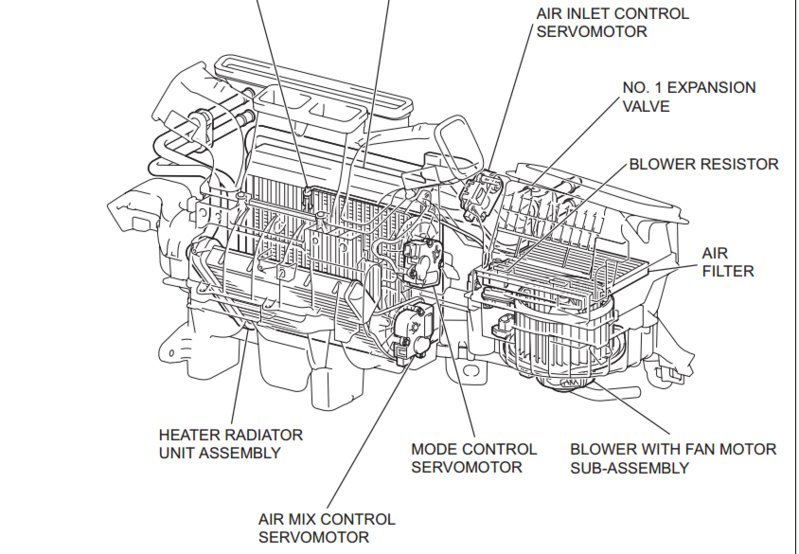

    Remember, on older vehicles, the amount of heat coming out of the heater / defroster ducts was controlled by a valve that regulated the coolant flow through the heater core. On almost all newer vehicles, it works differently. Coolant flows through the heater core constantly, but the amount of heat coming out of the heater / defroster ducts is controlled by a blend door that regulates the amount of air going past the heater core. So in newer vehicles, cranking the heat all the way up has no effect on the amount of coolant flowing through the heater core.
    BTW, I'm surprised nobody has picked up on the fact that the OP says he's hearing gurgling "under the steering wheel." The Heater Core is on the passenger side last time I checked.

    I believe it more centered on the Tacoma.
    I haven’t actually pulled the dash apart to look though.

    Yes it is nearly exactly in the center and the inlet / outlet piping is on the drivers side which is probably the source of the sound.
