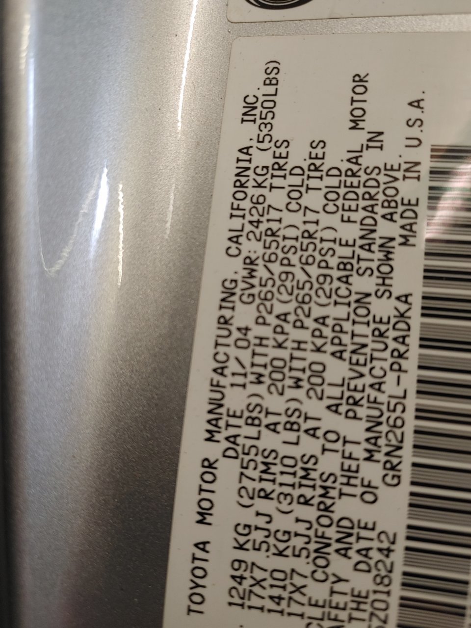

    My 05 has 223k on it and has been doing this for the last 15k miles or so. Headgaskets will probably go soon. I dont put but maybe a few thousand on the truck a year now but im preparing myself.
    11/04
