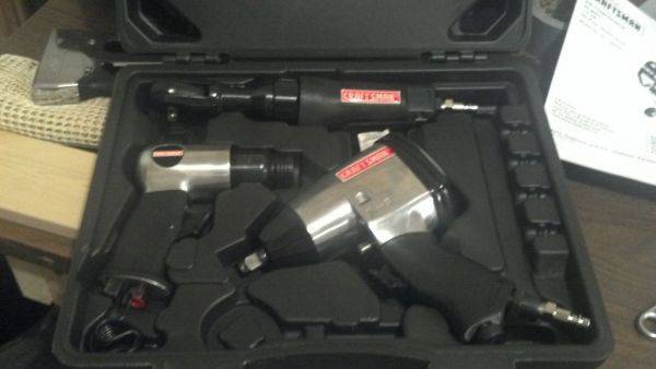

    Alright guys, so my garage got a little beefed up this Christmas, and I need some noob advice...
    My dad and I got this air compressor:
    And I got these Air tools:
    The Impact Wrench is 1/2" drive, with speed settings 1-4, and says use at 90 psi or lower. The Socket is 3/8" drive, same psi. I don't imagine using the Hammer too much...
    But, I have NO idea how to use these (Well I know the basics and what not) but I don't know really the Do's and Don't's of using them.
    1) The Wrench has speed settings 1 through 4, are these Torque settings or just speed? Is there a way to know what the estimated torque of each setting are or does it depend on what psi you're running at?
    2) I'm assuming I need to use special Impact Sockets with these tools, not just the common hand tool sockets. Any brand recommendations that won't break the bank? And since the Wrench and Socket are different drive sizes, do I need a set of 1/2 drive and a set of 3/8 drive sockets or can I use a reducer like this one?
    3) While using these, is it ok to use the wrench or socket to put ON a nut? Or will this put too much torque on the nut/bolt? Should I put it on a lower speed setting, put on, then use my torque wrench to get a torque reading?
    4) Any other tips/tricks/advice for me? Is it necessary to empty the compressor tank at the end of the night? Any experience with this tank or tools?
    Thanks guys! Any advice would help, just want to do things right!

    for the home garage enviroment i would recommend the craftsman imapct sockets..i have a few and they are good. the settings 1-4 are torque settings but the rpms will be affected as well. don't for get to use air tool oil everytime you use them..helps preserves and prolongs the life of your new air tools

    1 - they're speed setting, which in turn increase the torque (I think, not 100%)
    2 - Yeah, you need to go get yourself a set of Impact Sockets, only really need a 1/2" set as the Air Ratchet isn't high torque like the impact where a softer metal is not really required, you can but it's not immediately necessary.
    3 - All depends what you're using them on, wheels I use impacts to take them off not usually to put back on (unless I'm in a big rush or something, or part way but don't want to tighten them with the impact wrench)
    4 - Depends on the compressor, I don't usually empty it, just shut the compressor itself off. If you have a leaky compressor then shut it off & empty it.

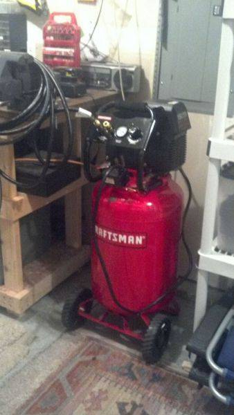

    I have had that same compressor for about ten years. My advice: consider the 1/2 inch vs the 3/8 inch hose for the impact wrench. You will get more air to the tool and, therefore greater torque. I installed a custom manifold that has both female ends that are needed for both hoses. I wasn't getting enough power to the impact wrench with the 3/8 inch hose. Perhaps your experience will be different. Also, drain the compressor (petcock valve on the bottom) after every use. The moisture in the compressor can rust the interior. All in all, a great compressor!

    P.S. I leave the compressor tank full. You should empty and drain the tank periodically though. And when you're out in the garage, be prepared for the compressor to kick in--it'll scare the crap out of you the first couple of times it comes on :)

    Drain the tank with the small brass valve on the bottom periodically, water collects in the bottom and it will rust if you let it sit. You can leave air in it though.
    As suggested an inline dryer can't hurt. Just a small water collector or something right after the output on the compressor. And maybe strap it on somewhere to the tank. Just rig up a small section of hose with some harbor freight fittings and some teflon tape. That's what I'd do anyway. I'm cheap.
