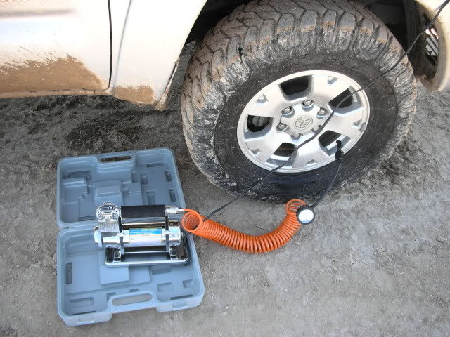

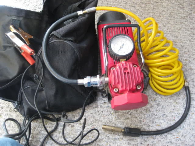

    This is two samples of what you want to get... they clip onto the battery directly and pump up a truck tire at the rate of 5-6 psi per minute. If you go with the pumps that plug into a cigarette lighter outlet, then they take 3 times longer to fill a tire (2 psi per minute). The ones pictured here cost between $49 and $79.

    I have the one in the second picture David K posted. Got it at pepboys. Love it. Works great.

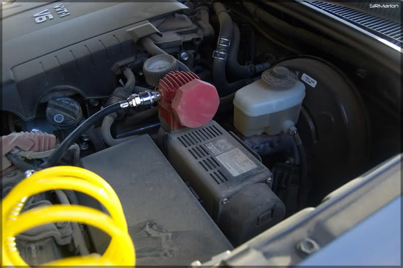

    i have the one (MV-50 12volt HD air compressor) that Davidk posted (2nd pic) for nearly 3 years now. it works well for what it is and certainly a lot cheaper then it's more expensive counter part made by Viair or ARB. you can find em at Pep Boys for around 70 bucks or cheaper online. there's a lot of info for that compressor if you google it. since i got tired of always unpacking it and repacking it from it's carrying case i have modified mine to hard mount into my engine compartment

    Nice... how did you connect it to the battery... and do you think an extra bag around it to keep it cleaner may be worth doing? Looks like you use the Tacoma to get dirty, as I do!

    i have a AUX ACC fuse box that i installed in the engine compartment to help accommodate the rest of my electronic crap lol. i re-wired the compressor my way, and it's hooked up the the AUX fuse box.
