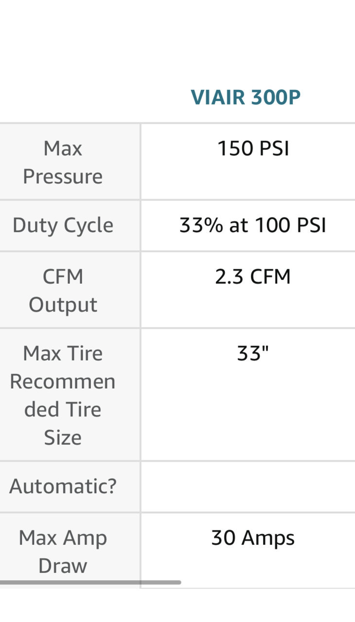

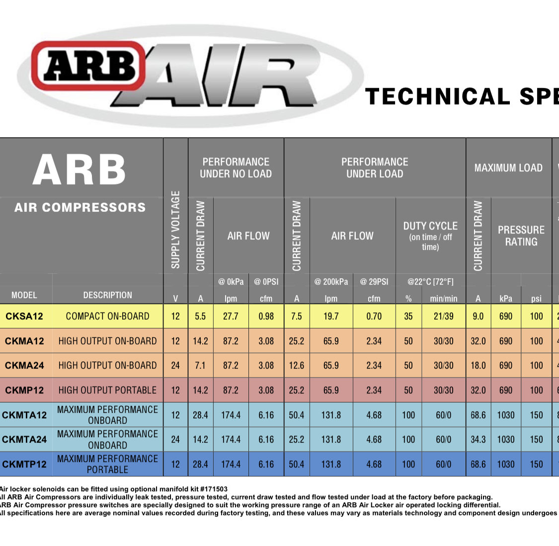

    I have viair portable compressor. Should I convert it to on board? Is that even possible? And get a tank for it?
    or get the arb single with a tank?
    the viair is 150 psi with a cfm of 2.3
    the arb is 100 psi with cfm of 2.34
    thanks.

    That’s awesome. I already have the 300p. Not sure if it’s automatic or not.

    I'm sure it isn't if it doesn't say automatic anywhere. I like it because it only runs when it needs to fill its internal tank, thus avoiding heat issues under the seat. Plus folks complain about the switches for various things only working for a year, and that's because they can't handle the full current through them, which is why I used a relay. Relays are cheap--everyone needs to use relays. :)

    It is not automatic, but you can pretty easily make it automatic. You will need that if you want to go on-board or use better standard air fittings. Here's my thread:

    Buy once, cry once. ARB twin all the way. Not sure why anyone would run the single, when the twin is a couple hundred more. YMMV

    I had a 300P and went ARB a while ago...worlds apart.
    Also bear in mind that CFM ratings are not as similar as they appear...ARB rating is at 29 psi, while Viair is at 0 psi.

    I installed the ARB single in the driver side bed cubby. Works great. Unless you get a BIG tank the compressor will run constantly when you're inflating anyway.
    The advantage of the ARB is that it comes with the wiring harness, switch and pressure switch included in the kit.
