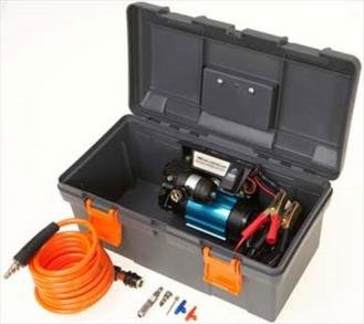

    Looking for a good air compressor for my truck to pump my tires back up after airing down for a little bit of off-roading.
    Does anyone have experience with the Air Armor M240 portable 12-V Tactical Air Compressor?
    Looks decent for around $200?
    How does it compare to the ARB Protable Compresor-CKMP12?
    A little more pricey at around $300.
    What are your thoughts concerning on-board compressors vs portable tool box style compressors?
    Do you have a compressor that you would recommend over the two stated above?

    I run that same ARB compressor except for mounted under hood rather than in a toolbox. The hard mounted version has a larger manifold to accommodate additional taps for lockers but is otherwise the same. My current one is also my second one since I sold the previous one with the truck it was mounted on. It's not the fastest thing in the world (compared to the dual compressor or shop compressor) but if I'm airing down and up I'm really not in a hurry anyway. Heat management and durability are the biggest concerns for me when choosing a compressor, compared to some of the others I've seen friends use the ARB stays relatively cool (relatively cool will still burn the shit out of your hand after airing four tires), I assume due to the rather sizeable heat sink mount. As for durability, ARBs reputation is second to none and of all the stuff I've had with their name on it over the years I haven't had a single failure. I'm happy with it.

    Buy once cry once is my policy. Are you running stock tires? If you're running over sized tires good luck with the cheaper products. The ARB CKMA12 will put out more air at 30PSI than the other products recommended so far will at 0-psi. In case you didn't know, maximum output is at 0psi and it drops from there. The duty cycle on the ARB is also better, but unless you're airing up multiple vehicles or have 40s or some other huge tire I doubt duty cycle will be an issue with any of these compressors. I am to a certain point an ARB fan boy, but honestly I just like good quality products and they deliver on that. IF you can save up for a bit longer and get the CKMTA12. I was fortunate enough to get one at a decent price in a group buy a while back and this thing rocks. I have aired up tires faster than people at one of those gas station pumps. At the minimum I would personally get the CKMA12 especially if you plan or are running bigger tires. I spent several years being the guy without a compressor. So I had the pleasure of using different compressors like a harbor freight one, MV50, MV90, one made by vlair, and another made by slime. I recall the slime and HF one being the worst, even though they worked. I dont know which model the vlair one was. The MV50 inherently had some issues by design so the guy had done some modifications to it to make it run better. The mv90 was nice too but I think those are pricey and compete with vlair and arb products. Air compressors can be slow but reliable so don't think you have to spend several bills on one. If you do get a slowish air compressor I would recommend that you'd atleast make sure it has a screw on air chuck so you're not kneeling down for 12-15 mins airing up your tires.

    I don't doubt they make good compressors, but I personally don't have a whole lot of experience with them so I'm not going to recommend one. I am not even sure which one I used the couple of times that I did when I went on wheeling trips with other people. The owner did seem happy with it though. Looking at the specs and prices I guess the 400 doesn't really compete with the ckma12. It's 100 dollar less, so no wonder the ckma12 out performs it. Looks like the viair 440p is the competitor for the ckma12. They have nearly identical output. The only other thing I can add based on my experiences is that ARB warranty is very easy and smooth. You call, someone picks up the phone, no menus or anything and they just mail you what you need. Although I've only needed small items like switches.
