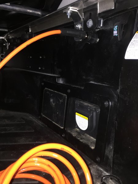

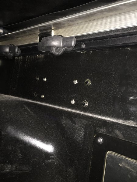

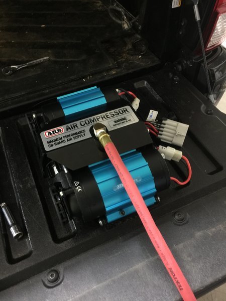

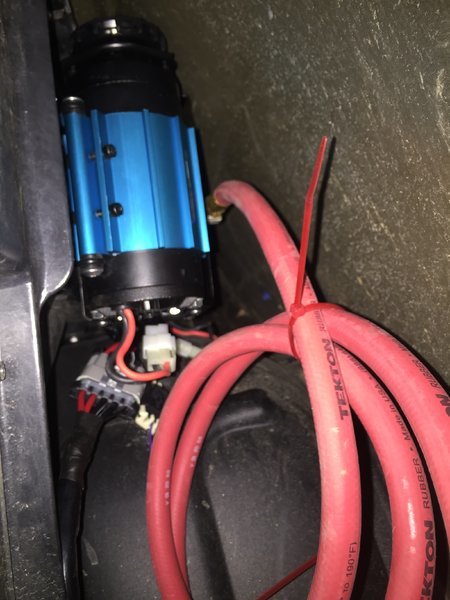

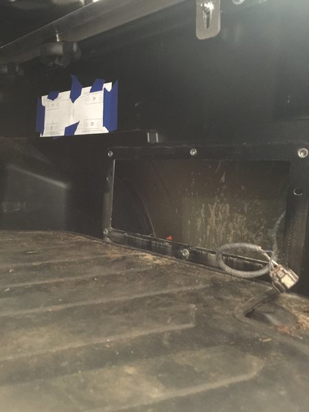

    I just finished installing an ARB dual compressor between my bed and rear passenger fender. I've ran Viair systems and Powertank CO2 systems on previous builds.
    CO2 is nice but can be a pain to get filled. I also had one blow off inside a Jeep before from being overfilled and temperature change. Not fun. It has a ton of power but you must have a good regulator.
    The ARB dual setup is nice but it's a monster and pretty loud. I don't see how anyone deals with it inside their cab. I looked at the portable box version but it's just one more item to pack and deal with.
