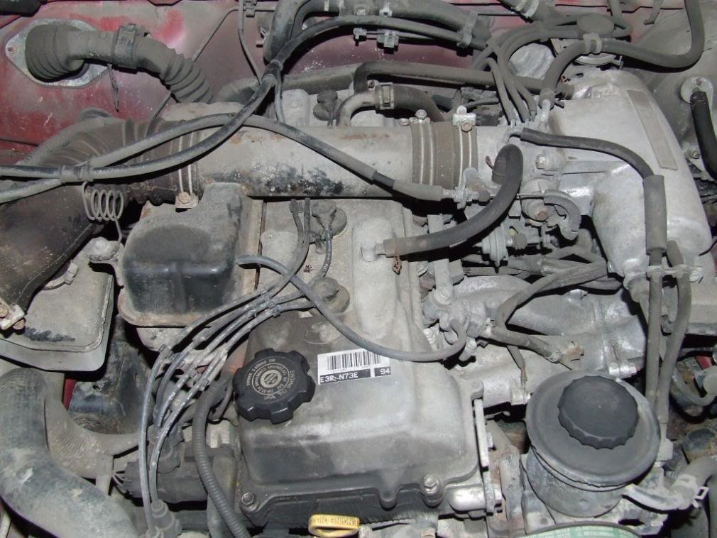

    It sounds like the valve isn't being opened like Mikey stated earlier. When you are standing in front of the truck facing the engine, back on the left side where the hose goes thruogh the firewall, in that general area is the valve he was refering too. See if you can turn it by hand and get your cold air. I will see if i can locate a pic.

    Top of the picture you will see the hoses and were that valve is.
