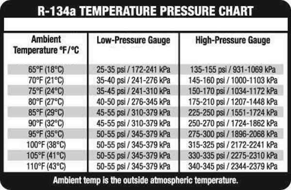

    Borrow a set of gauges and add freon to these pressures using the left temp chart for your outside temperature if the pressures are low. If they are high and still blowing warm air you need to be looking for a blockage if your compressor is running. You need to check with the compressor running, ie ac turned on.

    Update: Compressor works. I added R134 to my truck, the inital pressure was around 25-30psi around 85 degrees so thats pretty low. I filled it up to 50psi. AC is ice cold now, and it drains properly. I think I might have a slow leak somewhere as this have definitely occurred over the lifetime I have owned the truck (nearly 4 years). I will wait and see how the pressure is over the next week. Hopefully it is fixed!
