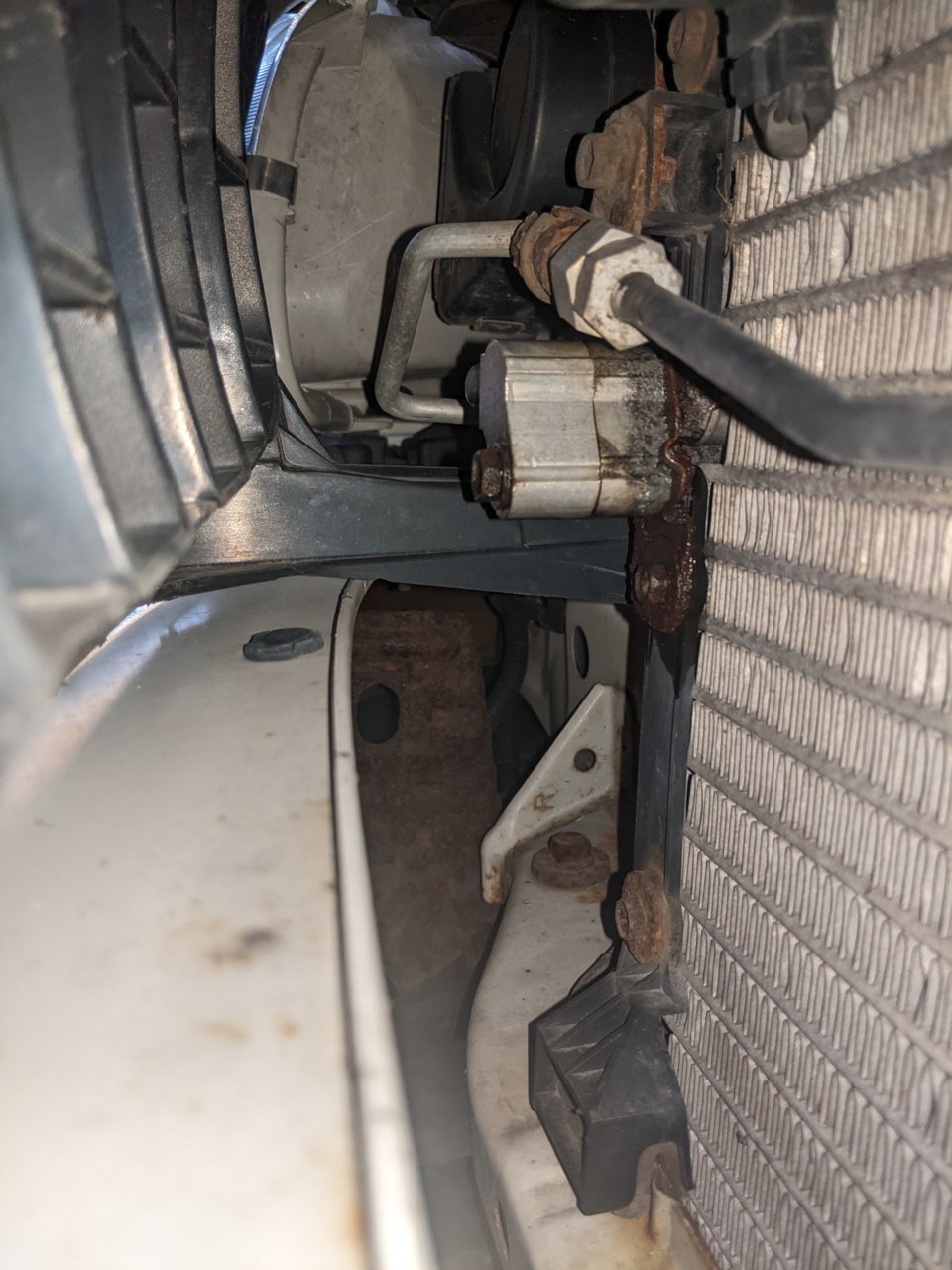

    So my AC is leaking from my condenser on the passenger side and needs to be replaced. I purchased a Denso Condenser (477-0504) and ACDelco receiver/Drier (15-10044) and plan to install myself. My plan is to do this work once all of the refrigerant has leaked out which should be pretty soon. Then, assuming there is no pressure in the system, I'll disconnect the condenser and drier and temporarily plug up the lines to prevent air or contaminants from entering.
    Then install the new condenser and drier (after they have had the correct amount of oil added into each). I will use new O rings where needed. Then Vacuum the entire system and add the specified amount of refrigerant.
    Where do I pour the PAG46 oil into the condenser and receiver/drier?
    Is the order in my plan correct?
    Other things I should consider? Do I for sure need to replace my receiver/drier?
    I was told by the PO, when I purchased the truck in December 2021, that the AC would last about two days and then need to be recharged. So I used a can of UV dyed refrigerant and that restored my AC but the leak I found was not UV dyed. The new leak was obvious and went from non-existent to very obvious, but why is it not reacting with my UV light? It just looks like water or oil leaking from the condenser. I'm not sure this means anything, just a bit strange.
    I have the relevant factory service manual pages attached which I plan to use.

    Good chance what your seeing is not refrigerant.
    Check your evaporator coil .

    The evaporator core or coil? If coil, where is that located? What do you suppose that liquid is at the condenser?

    Force of habit we call them coils not cores
    water or oil
    what should happen is the refrigerant evaporates all that is left is the dye
    it is possible the system is overloaded with oil.
